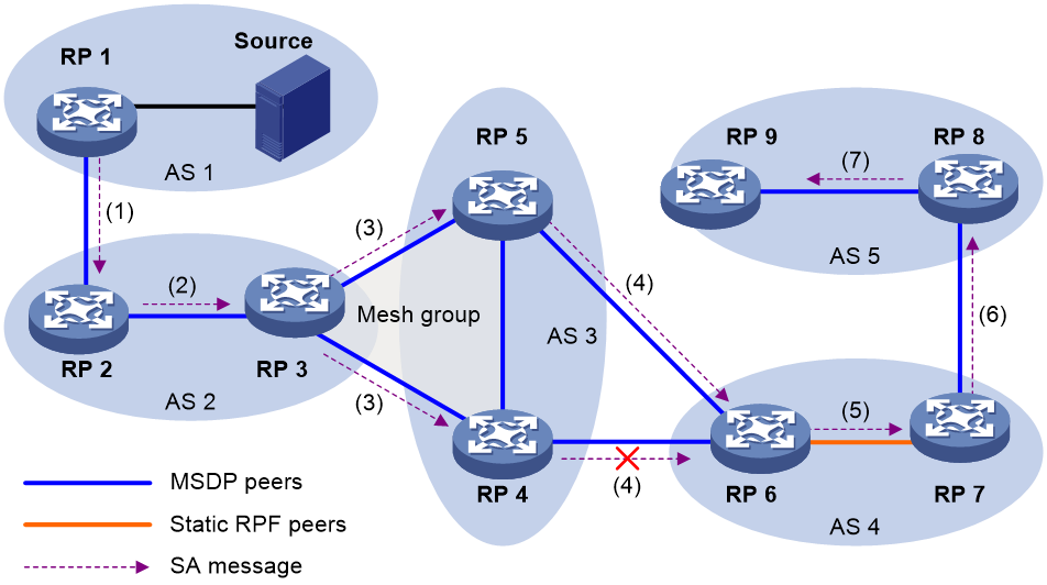

MSDP peer-RPF forwarding
The MSDP peer-RPF check is used for forwarding SA messages on a network that runs MSDP. If the peer-RPF check succeeds, the SA message is accepted and forwarded. Otherwise, the SA message is discarded.
As shown in Figure 3:
·     There are five ASs on the network. IGP runs within each AS, and BGP or MBGP runs between these ASs.
·     Each AS contains a minimum of one PIM-SM domain, and each PIM-SM domain contains a minimum of one RP.
·     MSDP peering relationship has been established among these RPs.
RP 3, RP 4, and RP 5 are in the same MSDP mesh group.
RP 6 is configured as the static RPF peer of RP 7.
Figure 3 MSDP peer-RPF forwarding
The process of peer-RPF forwarding is as follows:
1.     RP 1 creates an SA message and forwards it to its peer RP 2.
2.     RP 2 determines that RP 1 is the RP that creates the SA message because the RP address in the SA message is the same as that of RP 1. Then, RP 2 accepts and forwards the SA message.
3.     RP 3 accepts and forwards the SA message, because RP 2 and RP 3 reside in the same AS and RP 2 is the next hop of RP 3 to RP 1.
4.     RP 4 and RP 5 accept the SA message, because RP 3 is in the same mesh group with them. Then, RP 4 and RP 5 forward the SA message to their peer RP 6 rather than other members of the mesh group.
5.     RP 4 and RP 5 reside in the closest AS in the route to RP 1. However, RP 6 accepts and forwards only the SA message from RP 5, because the IP address of RP 5 is higher than that of RP 4.
6.     RP 7 accepts and forwards the SA message, because RP 6 is its static RPF peer.
7.     RP 8 accepts and forwards the SA message, because RP 7 is the EBGP or MBGP next hop of the peer-RPF route to RP 1.
8.     RP 9 accepts the SA message, because RP 8 is the only RP of RP 9.

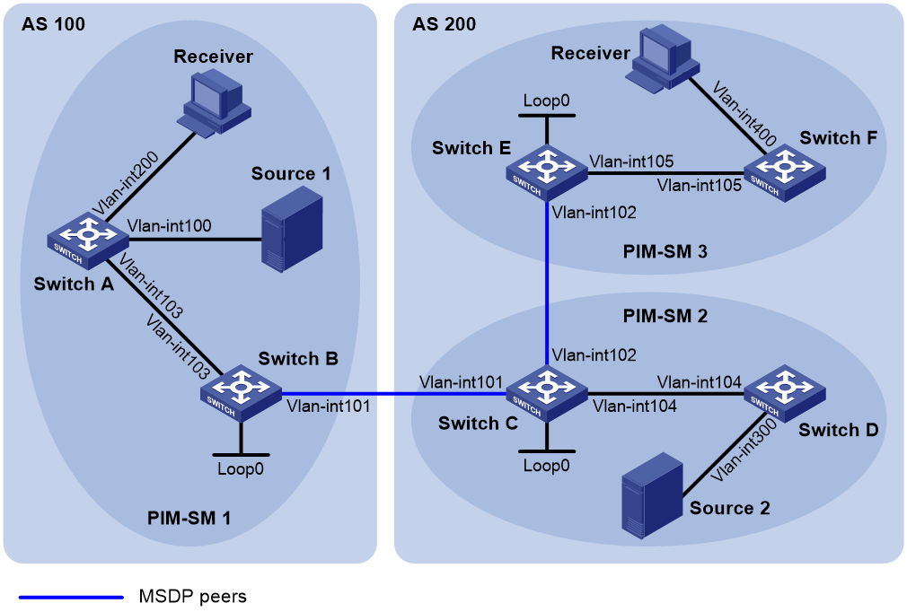

MSDP configuration examples
Example: Configuring PIM-SM inter-domain multicast
As shown in Figure 5:
·     OSPF runs within AS 100 and AS 200 and BGP runs between them.
·     Each PIM-SM domain has a minimum of one multicast source or receiver.
Set up MSDP peering relationships between the RPs in the PIM-SM domains to share multicast source information among the PIM-SM domains.
Figure 5 Network diagram
Device
Interface
IP address
Device
Interface
IP address
Switch A
Vlan-int103
10.110.1.2/24
Switch D
Vlan-int104
10.110.4.2/24
Switch A
Vlan-int100
10.110.2.1/24
Switch D
Vlan-int300
10.110.5.1/24
Switch A
Vlan-int200
10.110.3.1/24
Switch E
Vlan-int105
10.110.6.1/24
Switch B
Vlan-int103
10.110.1.1/24
Switch E
Vlan-int102
192.168.3.2/24
Switch B
Vlan-int101
192.168.1.1/24
Switch E
Loop0
3.3.3.3/32
Switch B
Loop0
1.1.1.1/32
Switch F
Vlan-int105
10.110.6.2/24
Switch C
Vlan-int104
10.110.4.1/24
Switch F
Vlan-int400
10.110.7.1/24
Switch C
Vlan-int102
192.168.3.1/24
Source 1
10.110.2.100/24
Switch C
Vlan-int101
192.168.1.2/24
Source 2
10.110.5.100/24
Switch C
Loop0
2.2.2.2/32
Switch D
Vlan-int104
10.110.4.2/24
Assign an IP address and subnet mask to each interface as shown in Figure 5, and configure OSPF on the switches in the ASs.

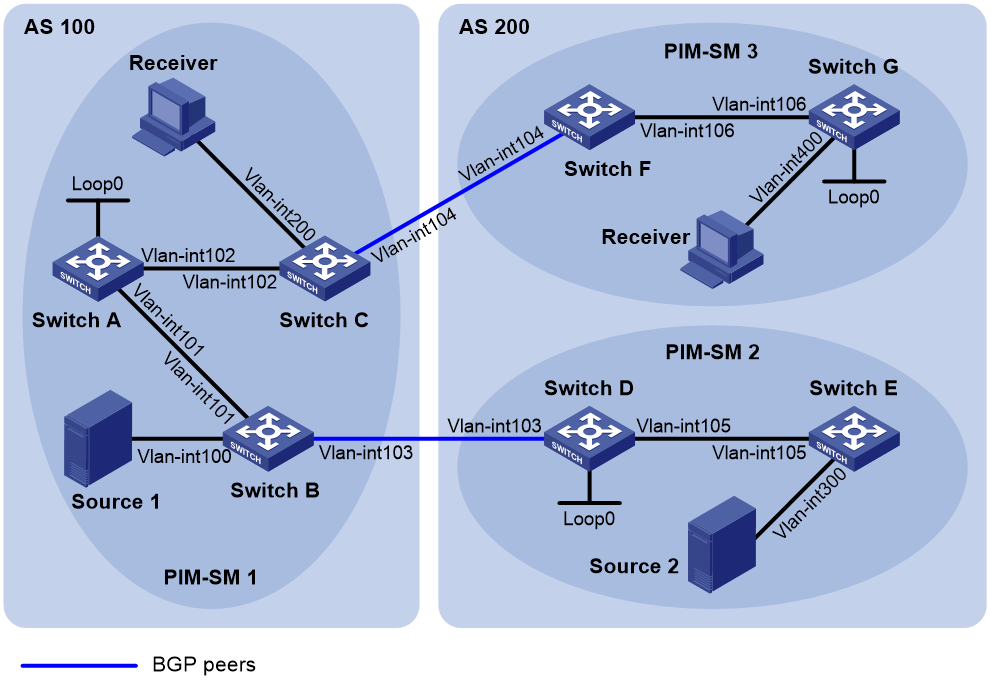

Example: Configuring inter-AS multicast by leveraging static RPF peers
As shown in Figure 6:
·     The network has two ASs: AS 100 and AS 200. OSPF runs within each AS. BGP runs between the two ASs.
·     PIM-SM 1 belongs to AS 100, and PIM-SM 2 and PIM-SM 3 belong to AS 200. Each PIM-SM domain has a minimum of one multicast source or receiver.
Configure inter-AS multicast as follows:
·     Configure Loopback 0 as the C-BSR and C-RP of the related PIM-SM domain on Switch A, Switch D and Switch G.
·     According to the peer-RPF forwarding rule, the switches accept SA messages that pass the filtering policy from its static RPF peers. To share multicast source information among PIM-SM domains without changing the unicast topology structure, configure MSDP peering relationships for the RPs of the PIM-SM domains and configure the static RPF peering relationships.
Figure 6 Network diagram

Assign an IP address and subnet mask to each interface as shown in Table 2, and configure OSPF on the switches in the ASs.

# Display the BGP peering relationships on Switch A.
[SwitchA] display bgp peer
No information is output, because no BGP peering relationship has been established between Switch A and Switch D, or between Switch A and Switch G. This means that the unicast topology is not changed.
# Display brief information about MSDP peers on Switch A.
[SwitchA] display msdp brief
Configured   Established  Listen       Connect      Shutdown     Disabled
2            2            0            0            0            0
Peer address    State       Up/Down time    AS         SA count   Reset count
10.110.3.2      Established 01:07:08        ?          8          0
10.110.6.2      Established 00:16:39        ?          13         0
# Display brief information about MSDP peers on Switch D.
[SwitchD] display msdp brief
1            1            0            0            0            0
10.110.1.1      Established 01:07:09        ?          8          0
# Display brief information about MSDP peers on Switch G.
[SwitchG] display msdp brief
1            1            0            0            0            0
10.110.2.1      Established 00:16:40        ?          13         0
# Verify that receivers in PIM-SM 1 and PIM-SM 3 can receive the multicast data from Source 1 and Source 2 to a multicast group. (Details not shown.)

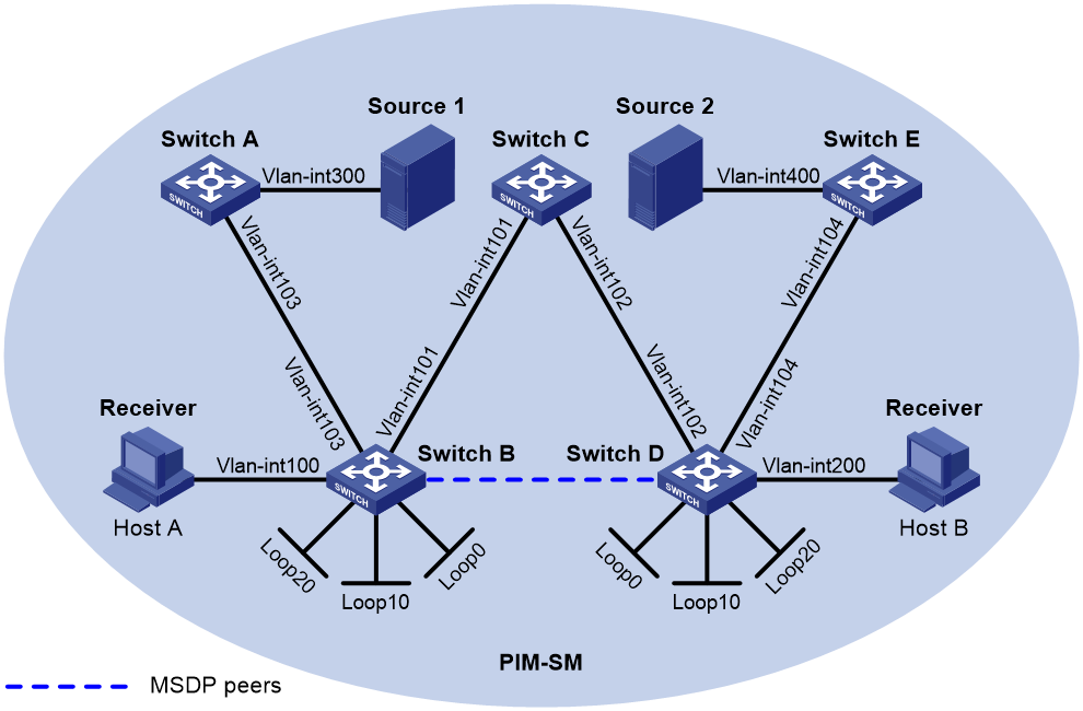

Example: Configuring Anycast RP
As shown in Figure 7, OSPF runs within the domain to provide unicast routes.
Configure the Anycast RP application so that the receiver-side DRs and the source-side DRs can initiate a join process to their respective RPs that are topologically closest to them.
Configure the router IDs of Switch B and Switch D as 1.1.1.1 and 2.2.2.2, respectively. Set up an MSDP peering relationship between Switch B and Switch D.
Figure 7 Network diagram
Table 3 Interface and IP address assignment

Assign an IP address and subnet mask to each interface as shown in Figure 7, and configure OSPF on the switches.

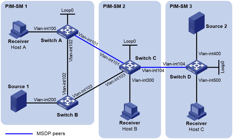

Example: Configuring SA message filtering
As shown in Figure 8:
·     OSPF runs within and among the PIM-SM domains to provide unicast routing.
·     Set up an MSDP peering relationship between Switch A and Switch C and between Switch C and Switch D.
·     Source 1 sends multicast data to multicast groups 225.1.1.0/30 and 226.1.1.0/30, and Source 2 sends multicast data to the multicast group 227.1.1.0/30.
Configure SA message policies so that:
·     Host A and Host B receive the multicast data only addressed to multicast groups 225.1.1.0/30 and 226.1.1.0/30.
·     Host C receives the multicast data only addressed to multicast groups 226.1.1.0/30 and 227.1.1.0/30.
Figure 8 Network diagram
Table 4 Interface and IP address assignment
Device
Interface
IP address
Device
Interface
IP address
Source 1
10.110.3.100/24
Switch C
Vlan-int300
10.110.4.1/24
Source 2
10.110.6.100/24
Switch C
Vlan-int104
10.110.5.1/24
Switch A
Vlan-int100
10.110.1.1/24
Switch C
Vlan-int101
192.168.1.2/24
Switch A
Vlan-int102
10.110.2.1/24
Switch C
Vlan-int103
192.168.2.2/24
Switch A
Vlan-int101
192.168.1.1/24
Switch C
Loop0
2.2.2.2/32
Switch A
Loop0
1.1.1.1/32
Switch D
Vlan-int400
10.110.6.1/24
Switch B
Vlan-int200
10.110.3.1/24
Switch D
Vlan-int500
10.110.7.1/24
Switch B
Vlan-int102
10.110.2.2/24
Switch D
Vlan-int104
10.110.5.2/24
Switch B
Vlan-int103
192.168.2.1/24
Switch D
Loop0
3.3.3.3/32
Assign an IP address and subnet mask to each interface as shown in Figure 8, and configure OSPF on the switches in the PIM-SM domains.
1.     Enable IP multicast routing, IGMP, and PIM-SM, and configure PIM domain borders:
# On Switch A, enable IP multicast routing.
<SwitchA> system-view
[SwitchA] multicast routing
[SwitchA-mrib] quit
# Enable IGMP on the receiver-side interface (VLAN-interface 100).
[SwitchA-Vlan-interface100] igmp enable
# Enable PIM-SM on the other interfaces.
[SwitchA] interface vlan-interface 101
[SwitchA-Vlan-interface101] pim sm
[SwitchA-Vlan-interface101] quit
[SwitchA] interface vlan-interface 102
[SwitchA-Vlan-interface102] pim sm
[SwitchA-Vlan-interface102] quit
[SwitchA] interface loopback 0
[SwitchA-LoopBack0] pim sm
[SwitchA-LoopBack0] quit
# Enable IP multicast routing, IGMP, and PIM-SM on Switch B, Switch C, and Switch D in the same way Switch A is configured. (Details not shown.)
# Configure a PIM domain border on Switch C.
[SwitchC] interface vlan-interface 101
[SwitchC-Vlan-interface101] pim bsr-boundary
[SwitchC-Vlan-interface101] quit
[SwitchC] interface vlan-interface 103
[SwitchC-Vlan-interface103] pim bsr-boundary
[SwitchC-Vlan-interface103] quit
[SwitchC] interface vlan-interface 104
[SwitchC-Vlan-interface104] pim bsr-boundary
[SwitchC-Vlan-interface104] quit
# Configure PIM domain borders on Switch A, Switch B, and Switch D in the same way Switch C is configured. (Details not shown.)
2.     Configure C-BSRs and C-RPs:
# Configure Loopback 0 as a C-BSR and a C-RP on Switch A.
[SwitchA] pim
[SwitchA-pim] c-bsr 1.1.1.1
[SwitchA-pim] c-rp 1.1.1.1
[SwitchA-pim] quit
# Configure C-BSRs and C-RPs on Switch C and Switch D in the same way Switch A is configured. (Details not shown.)
3.     Configure MSDP peers:
# Configure an MSDP peer on Switch A.
[SwitchA] msdp
[SwitchA-msdp] peer 192.168.1.2 connect-interface vlan-interface 101
[SwitchA-msdp] quit
# Configure MSDP peers on Switch C.
[SwitchC] msdp
[SwitchC-msdp] peer 192.168.1.1 connect-interface vlan-interface 101
[SwitchC-msdp] peer 10.110.5.2 connect-interface vlan-interface 104
[SwitchC-msdp] quit
# Configure an MSDP peer on Switch D.
[SwitchD] msdp
[SwitchD-msdp] peer 10.110.5.1 connect-interface vlan-interface 104
[SwitchD-msdp] quit
4.     Configure SA message policies:
# Configure an SA accepting and forwarding policy on Switch C so that Switch C will not forward SA messages for (Source 1, 225.1.1.0/30) to Switch D.
[SwitchC] acl advanced 3001
[SwitchC-acl-ipv4-adv-3001] rule deny ip source 10.110.3.100 0 destination 225.1.1.0 0.0.0.3
[SwitchC-acl-ipv4-adv-3001] rule permit ip source any destination any
[SwitchC-acl-ipv4-adv-3001] quit
[SwitchC] msdp
[SwitchC-msdp] peer 10.110.5.2 sa-policy export acl 3001
[SwitchC-msdp] quit
# Configure an SA creation policy on Switch D so that Switch D will not create SA messages for Source 2.
[SwitchD] acl basic 2001
[SwitchD-acl-ipv4-basic-2001] rule deny source 10.110.6.100 0
[SwitchD-acl-ipv4-basic-2001] quit
[SwitchD] msdp
[SwitchD-msdp] import-source acl 2001
[SwitchD-msdp] quit
# Display the (S, G) entries in the SA message cache on Switch C.
[SwitchC] display msdp sa-cache
 MSDP Total Source-Active Cache - 8 entries
 Matched 8 entries
Source        Group          Origin RP       Pro  AS     Uptime   Expires
10.110.3.100  225.1.1.0      1.1.1.1         ?    ?      02:03:30 00:05:31
10.110.3.100  225.1.1.1      1.1.1.1         ?    ?      02:03:30 00:05:31
10.110.3.100  225.1.1.2      1.1.1.1         ?    ?      02:03:30 00:05:31
10.110.3.100  225.1.1.3      1.1.1.1         ?    ?      02:03:30 00:05:31
10.110.3.100  226.1.1.0      1.1.1.1         ?    ?      02:03:30 00:05:31
10.110.3.100  226.1.1.1      1.1.1.1         ?    ?      02:03:30 00:05:31
10.110.3.100  226.1.1.2      1.1.1.1         ?    ?      02:03:30 00:05:31
10.110.3.100  226.1.1.3      1.1.1.1         ?    ?      02:03:30 00:05:31
# Display the (S, G) entries in the SA message cache on Switch D.
[SwitchD] display msdp sa-cache
 MSDP Total Source-Active Cache - 4 entries
 Matched  4 entries
10.110.3.100  226.1.1.0      1.1.1.1         ?    ?      00:32:53 00:05:07
10.110.3.100  226.1.1.1      1.1.1.1         ?    ?      00:32:53 00:05:07
10.110.3.100  226.1.1.2      1.1.1.1         ?    ?      00:32:53 00:05:07
10.110.3.100  226.1.1.3      1.1.1.1         ?    ?      00:32:53 00:05:07
