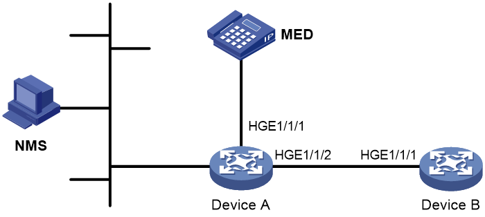

LLDP exchanges packets between neighbor agents and creates and maintains neighbor information for them. Figure 1 shows the neighbor relationships for these LLDP agents.
Figure 1 LLDP neighbor relationships
The types of supported LLDP agents vary with the bridge mode in which LLDP operates. LLDP supports the following bridge modes: customer bridge (CB) and service bridge (SB).
·     Customer bridge mode—LLDP supports nearest bridge agent, nearest non-TPMR bridge agent, and nearest customer bridge agent. LLDP processes the LLDP frames with destination MAC addresses for these agents and transparently transmits the LLDP frames with other destination MAC addresses in VLANs.
·     Service bridge mode—LLDP supports nearest bridge agent and nearest non-TPMR bridge agent. LLDP processes the LLDP frames with destination MAC addresses for these agents and transparently transmits the LLDP frames with other destination MAC addresses in VLANs.

LLDP configuration examples
Example: Configuring basic LLDP functions
As shown in Figure 5, enable LLDP globally on Switch A and Switch B to perform the following tasks:
·     Monitor the link between Switch A and Switch B on the NMS.
·     Monitor the link between Switch A and the MED device on the NMS.
Figure 5 Network diagram
1.     Configure Switch A:
# Enable LLDP globally.
<SwitchA> system-view
[SwitchA] lldp global enable
# Enable LLDP on HundredGigE 1/1/1. By default, LLDP is enabled on ports.
[SwitchA] interface hundredgige 1/1/1
[SwitchA-HundredGigE1/1/1] lldp enable
# Set the LLDP operating mode to Rx on HundredGigE 1/1/1.
[SwitchA-HundredGigE1/1/1] lldp admin-status rx
[SwitchA-HundredGigE1/1/1] quit
# Enable LLDP on HundredGigE 1/1/2. By default, LLDP is enabled on ports.
[SwitchA] interface gigabitethernet1/2
[SwitchA-HundredGigE1/1/2] lldp enable
# Set the LLDP operating mode to Rx on HundredGigE 1/1/2.
[SwitchA-HundredGigE1/1/2] lldp admin-status rx
[SwitchA-HundredGigE1/1/2] quit
2.     Configure Switch B:
<SwitchB> system-view
[SwitchB] lldp global enable
[SwitchB] interface hundredgige 1/1/1
[SwitchB-HundredGigE1/1/1] lldp enable
# Set the LLDP operating mode to Tx on HundredGigE 1/1/1.
[SwitchB-HundredGigE1/1/1] lldp admin-status tx
[SwitchB-HundredGigE1/1/1] quit
# Verify the following items:
·     HundredGigE 1/1/1 of Switch A connects to a MED device.
·     HundredGigE 1/1/2 of Switch A connects to a non-MED device.
·     Both ports operate in Rx mode, and they can receive LLDP frames but cannot send LLDP frames.

# Remove the link between Switch A and Switch B.
# Verify that HundredGigE 1/1/2 of Switch A does not connect to any neighboring devices.
[SwitchA] display lldp status
Global status of LLDP: Enable
The current number of LLDP neighbors: 1
The current number of CDP neighbors: 0
LLDP neighbor information last changed time: 0 days, 0 hours, 5 minutes, 20 seconds
Transmit interval              : 30s
Fast transmit interval         : 1s
Transmit credit max            : 5
Hold multiplier                : 4
Reinit delay                   : 2s
Trap interval                  : 30s
Fast start times               : 4
LLDP status information of port 1 [HundredGigE1/1/1]:
LLDP agent nearest-bridge:
Port status of LLDP            : Enable
Admin status                   : Rx_Only
Trap flag                      : No
MED trap flag                  : No
Polling interval               : 0s
Number of LLDP neighbors       : 1
Number of MED neighbors        : 1
Number of CDP neighbors        : 0
Number of sent optional TLV    : 0
Number of received unknown TLV : 5
LLDP agent nearest-nontpmr:
Admin status                   : Disable
Trap flag                      : No
MED trap flag                  : No
Number of LLDP neighbors       : 0
Number of MED neighbors        : 0
Number of sent optional TLV    : 1
Number of received unknown TLV : 0
LLDP status information of port 2 [HundredGigE1/1/2]:
Trap flag                      : No
MED trap flag                  : No
Trap flag                      : No
MED trap flag                  : No
LLDP agent nearest-customer:
Trap flag                      : No
MED trap flag                  : No
Number of sent optional TLV    : 16

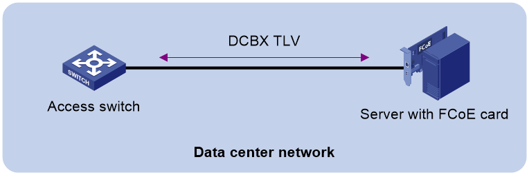

DCBX application scenario
Figure 6 DCBX application scenario
DCBX enables lossless packet transmission on DCE networks.
As shown in Figure 6, DCBX applies to an FCoE-based data center network, and operates on an access switch. DCBX enables the switch to control the server or storage adapter, and simplifies the configuration and guarantees configuration consistency. DCBX extends LLDP by using the IEEE 802.1 organizationally specific TLVs (DCBX TLVs) to transmit DCBX data, including:
·     In DCBX Rev 1.00 and DCBX Rev 1.01:
¡     Application Protocol (APP).
¡     Enhanced Transmission Selection (ETS).
¡     Priority-based Flow Control (PFC).
·     In IEEE Std 802.1Qaz-2011:
¡     ETS Configuration.
¡     ETS Recommendation.
¡     PFC.
¡     APP.
H3C devices can send these types of DCBX information to a server or storage adapter supporting FCoE. However, H3C devices cannot accept these types of DCBX information.

Example: Configuring DCBX
As shown in Figure 7, HundredGigE 1/1/1 of the access switch (Switch A) connects to the FCoE adapter of the data center server (DC server).
Configure Switch A to implement lossless FCoE and FIP frame transmission to DC server.
In this example, both Switch A and the DC server support DCBX Rev 1.01.
Figure 7 Network diagram
1.     Enable LLDP and DCBX TLV advertising:
# Enable LLDP and DCBX TLV advertising on HundredGigE 1/1/1.
[SwitchA-HundredGigE1/1/1] lldp tlv-enable dot1-tlv dcbx
2.     Set the DCBX version to Rev. 1.01 on HundredGigE 1/1/1.
[SwitchA-HundredGigE1/1/1] dcbx version rev101
3.     Configure APP parameters:
# Create Layer 2 ACL 4000.
[SwitchA] acl mac 4000
# Configure ACL 4000 to permit FCoE frames (frame type is 0x8906) and FIP frames (frame type is 0x8914) to pass through.
[SwitchA-acl-mac-4000] rule permit type 8906 ffff
[SwitchA-acl-mac-4000] rule permit type 8914 ffff
[SwitchA-acl-mac-4000] quit
# Create a class named app_c, set the operator of the class to OR, and use ACL 4000 as the match criterion of the class.
[SwitchA] traffic classifier app_c operator or
[SwitchA-classifier-app_c] if-match acl mac 4000
[SwitchA-classifier-app_c] quit
# Create a traffic behavior named app_b, and configure the traffic behavior to mark packets with 802.1p priority value 3.
[SwitchA] traffic behavior app_b
[SwitchA-behavior-app_b] remark dot1p 3
[SwitchA-behavior-app_b] quit
# Create a QoS policy named plcy, associate class app_c with traffic behavior app_b in the QoS policy, and apply the association to DCBX.
[SwitchA] qos policy plcy
[SwitchA-qospolicy-plcy] classifier app_c behavior app_b mode dcbx
[SwitchA-qospolicy-plcy] quit
# Apply QoS policy plcy to the outgoing traffic of HundredGigE 1/1/1.
[SwitchA-HundredGigE1/1/1] qos apply policy plcy outbound
4.     Configure ETS parameters:
# Configure the 802.1p-to-local priority mapping table to map 802.1p priority value 3 to local precedence 3. (This is the default mapping table. You can modify this configuration as needed.)
[SwitchA] qos map-table dot1p-lp
[SwitchA-maptbl-out-dot1p-lp] import 3 export 3
[SwitchA-maptbl-out-dot1p-lp] quit
# Enable byte-count WRR queuing on HundredGigE 1/1/1, and configure queue 3 on the interface to use SP queuing.
[SwitchA-HundredGigE1/1/1] qos wrr byte-count
[SwitchA-HundredGigE1/1/1] qos wrr 3 group sp
5.     Configure PFC:
# Enable PFC in auto mode on HundredGigE 1/1/1.
[SwitchA-HundredGigE1/1/1] priority-flow-control auto
# Enable PFC for 802.1 priority 3.
[SwitchA-HundredGigE1/1/1] priority-flow-control no-drop dot1p 3
# Display the data exchange result on the DC server through the software interface. This example uses the data exchange result for a QLogic adapter on the DC server.
DCBX Parameters Details for CNA Instance 0 - QLE8142
Mon May 17 10:00:50 2010
DCBX TLV (Type-Length-Value) Data
DCBX Parameter Type and Length
        DCBX Parameter Length: 13
        DCBX Parameter Type: 2
DCBX Parameter Information
        Parameter Type: Current
        Pad Byte Present: Yes
        DCBX Parameter Valid: Yes
        Reserved: 0
DCBX Parameter Data
        Priority Group ID of Priority 1: 0
        Priority Group ID of Priority 0: 2
        Priority Group ID of Priority 3: 15
        Priority Group ID of Priority 2: 1
        Priority Group ID of Priority 5: 5
        Priority Group ID of Priority 4: 4
        Priority Group ID of Priority 7: 7
        Priority Group ID of Priority 6: 6
        Priority Group 0 Percentage: 2
        Priority Group 1 Percentage: 4
        Priority Group 2 Percentage: 6
        Priority Group 3 Percentage: 0
        Priority Group 4 Percentage: 10
        Priority Group 5 Percentage: 18
        Priority Group 6 Percentage: 27
        Priority Group 7 Percentage: 31
        Number of Traffic Classes Supported: 8
        Parameter Type: Remote
        Reserved: 0
DCBX Parameter Data
        Parameter Type: Local
        Reserved: 0
DCBX Parameter Data
        Priority Group ID of Priority 0: 0
        Priority Group ID of Priority 2: 0
        Priority Group ID of Priority 5: 0
        Priority Group ID of Priority 4: 0
        Priority Group ID of Priority 7: 0
        Priority Group ID of Priority 6: 0
        Priority Group 0 Percentage: 50
        Priority Group 1 Percentage: 50
        Priority Group 2 Percentage: 0
        Priority Group 4 Percentage: 0
        Priority Group 5 Percentage: 0
        Priority Group 6 Percentage: 0
        Priority Group 7 Percentage: 0
        Number of Traffic Classes Supported: 2
The output shows that the DC server will use SP queuing (priority group ID 15) for 802.1p priority 3.
        DCBX Parameter Length: 2
        DCBX Parameter Type: 3
        Pad Byte Present: No
        Reserved: 0
DCBX Parameter Data
        PFC Enabled on Priority 0: No
        PFC Enabled on Priority 1: No
        PFC Enabled on Priority 2: No
        PFC Enabled on Priority 3: Yes
        PFC Enabled on Priority 4: No
        PFC Enabled on Priority 5: No
        PFC Enabled on Priority 6: No
        PFC Enabled on Priority 7: No
        Number of Traffic Classes Supported: 6
        Reserved: 0
DCBX Parameter Data
        Reserved: 0
DCBX Parameter Data
        Number of Traffic Classes Supported: 1
The output shows that the DC server will use PFC for 802.1p priority 3.
