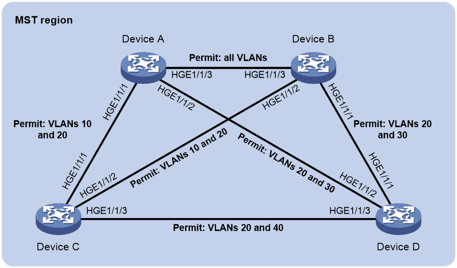

Figure 9 shows a switched network that contains four MST regions, each MST region containing four MSTP devices. Figure 10 shows the networking topology of MST region 3.
Figure 9 Basic concepts in MSTP
Figure 10 Network diagram and topology of MST region 3
MST region
A multiple spanning tree region (MST region) consists of multiple devices in a switched network and the network segments among them. All these devices have the following characteristics:
·     A spanning tree protocol enabled
·     Same region name
·     Same VLAN-to-instance mapping configuration

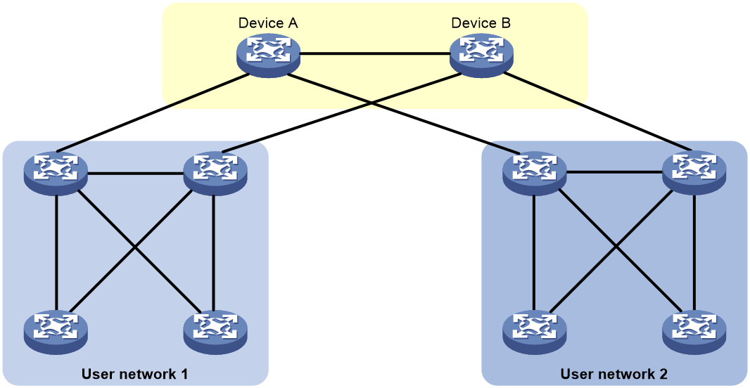

Configuring TC Snooping
As shown in Figure 18, an IRF fabric connects to two user networks through double links.
As shown in Figure 18, Device A and Device B connects to two user networks through double links.
·     The spanning tree feature is disabled on Device A and Device B and enabled on all devices in user network 1 and user network 2.
·     Device A and Device B transparently transmit BPDUs for both user networks and are not involved in the calculation of spanning trees.
When the network topology changes, it takes time for Device A and Device B to update their MAC address tables and ARP tables. During this period, traffic in the network might be interrupted.
Figure 18 TC Snooping application scenario
To avoid traffic interruption, you can enable TC Snooping on Device A and Device B. After receiving a TC-BPDU through a port, Device A and Device B update MAC address table and ARP table entries associated with the port's VLAN. In this way, TC Snooping prevents topology change from interrupting traffic forwarding in the network. For more information about the MAC address table and the ARP table, see "Configuring the MAC address table" and Layer 3—IP Services Configuration Guide.
·     TC Snooping and the spanning tree feature are mutually exclusive. You must globally disable the spanning tree feature before enabling TC Snooping.
·     The priority of BPDU tunneling is higher than that of TC Snooping. When BPDU tunneling is enabled on a port, the TC Snooping feature does not take effect on the port.
·     TC Snooping does not support the PVST mode.

Configuring port role restriction
Make this configuration on the port that connects to the user access network.
The bridge ID change of a device in the user access network might cause a change to the spanning tree topology in the core network. To avoid this problem, you can enable port role restriction on a port. With this feature enabled, when the port receives a superior BPDU, it becomes an alternate port rather than a root port.
Use this feature with caution, because enabling port role restriction on a port might affect the connectivity of the spanning tree topology.
2.     Enter interface view.
3.     Enable port role restriction.
stp role-restriction
By default, port role restriction is disabled.

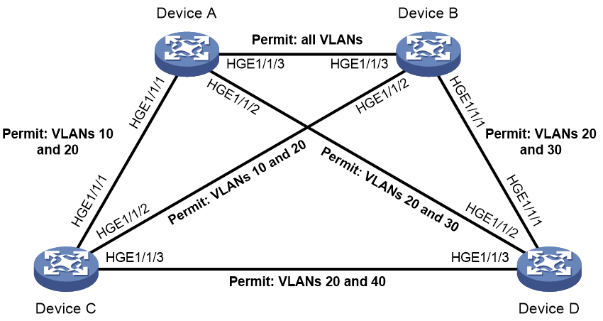

Disabling dispute guard
Dispute guard can be triggered by unidirectional link failures. If an upstream port receives inferior BPDUs from a downstream designated port in forwarding or learning state because of a unidirectional link failure, a loop appears. Dispute guard blocks the upstream designated port to prevent the loop.
As shown in Figure 19, in normal conditions, the spanning tree calculation result is as follows:
·     Device A is the root bridge, and Port A1 is a designated port.
·     Port B1 is blocked.
When the link between Port A1 and Port B1 fails in the direction of Port A1 to Port B1 and becomes unidirectional, the following events occur:
1.     Port A1 can only receive BPDUs and cannot send BPDUs to Port B1.
2.     Port B1 does not receive BPDUs from Port A1 for a certain period of time.
3.     Device B determines itself as the root bridge.
4.     Port B1 sends its BPDUs to Port A1.
5.     Port A1 determines the received BPDUs are inferior to its own BPDUs. A dispute is detected.
6.     Dispute guard is triggered and blocks Port A1 to prevent a loop.

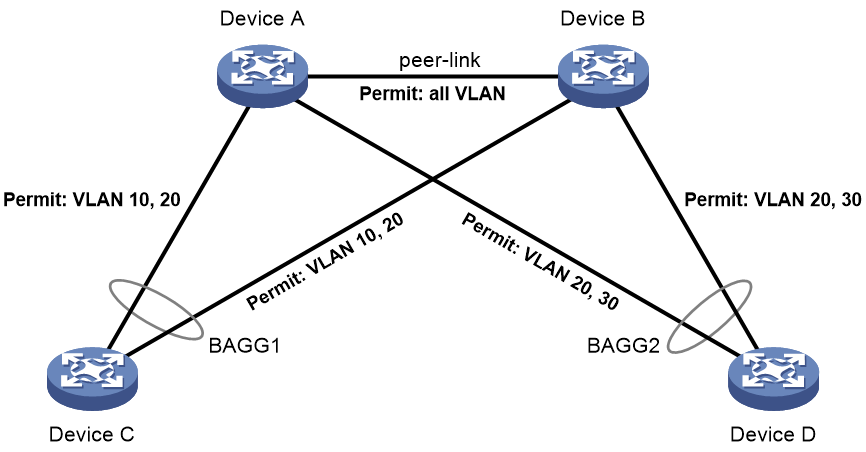

However, dispute guard might disrupt the network connectivity. You can disable dispute guard to avoid connectivity loss in VLAN networks. As shown in Figure 21, the spanning tree feature is disabled on Device B and enabled on Device A and device C. Device B transparently transmits BPDUs.
Device C cannot receive superior BPDUs of VLAN 1 from Device A because Port B1 of Device B is configured to deny packets of VLAN 1. Device C determines itself as the root bridge after a certain period of time. Then, Port C1 sends an inferior BPDU of VLAN 100 to Device A.
When Device A receives the inferior BPDU, dispute guard blocks Port A1, which causes traffic interruption. To ensure service continuity, you can disable dispute guard on Device A to prevent the link from being blocked.
Figure 21 Disabling dispute guard application scenario
You can disable dispute guard if the network does not have unidirectional link failures.

Example: Configuring MSTP
As shown in Figure 22, all devices on the network are in the same MST region. Device A and Device B work at the distribution layer. Device C and Device D work at the access layer.
Configure MSTP so that frames of different VLANs are forwarded along different spanning trees.
·     VLAN 10 frames are forwarded along MSTI 1.
·     VLAN 30 frames are forwarded along MSTI 3.
·     VLAN 40 frames are forwarded along MSTI 4.
·     VLAN 20 frames are forwarded along MSTI 0.
VLAN 10 and VLAN 30 are terminated on the distribution layer devices, and VLAN 40 is terminated on the access layer devices. The root bridges of MSTI 1 and MSTI 3 are Device A and Device B, respectively, and the root bridge of MSTI 4 is Device C.
Figure 22 Network diagram

¡     Create VLAN 10, VLAN 20, and VLAN 30 on both Device A and Device B.
¡     Create VLAN 10, VLAN 20, and VLAN 40 on Device C.
¡     Create VLAN 20, VLAN 30, and VLAN 40 on Device D.
¡     Configure the ports on these devices as trunk ports and assign them to related VLANs.
2.     Configure Device A:
# Enter MST region view, and configure the MST region name as example.
<DeviceA> system-view
[DeviceA] stp region-configuration
[DeviceA-mst-region] region-name example
# Map VLAN 10, VLAN 30, and VLAN 40 to MSTI 1, MSTI 3, and MSTI 4, respectively.
[DeviceA-mst-region] instance 1 vlan 10
[DeviceA-mst-region] instance 3 vlan 30
[DeviceA-mst-region] instance 4 vlan 40
# Configure the revision level of the MST region as 0.
[DeviceA-mst-region] revision-level 0
# Activate MST region configuration.
[DeviceA-mst-region] active region-configuration
[DeviceA-mst-region] quit
# Configure the Device A as the root bridge of MSTI 1.
[DeviceA] stp instance 1 root primary
# Enable the spanning tree feature globally.
[DeviceA] stp global enable
3.     Configure Device B:
<DeviceB> system-view
[DeviceB] stp region-configuration
[DeviceB-mst-region] region-name example
[DeviceB-mst-region] instance 1 vlan 10
[DeviceB-mst-region] instance 3 vlan 30
[DeviceB-mst-region] instance 4 vlan 40
[DeviceB-mst-region] revision-level 0
[DeviceB-mst-region] active region-configuration
[DeviceB-mst-region] quit
# Configure Device B as the root bridge of MSTI 3.
[DeviceB] stp instance 3 root primary
[DeviceB] stp global enable
4.     Configure Device C:
<DeviceC> system-view
[DeviceC] stp region-configuration
[DeviceC-mst-region] region-name example
[DeviceC-mst-region] instance 1 vlan 10
[DeviceC-mst-region] instance 3 vlan 30
[DeviceC-mst-region] instance 4 vlan 40
[DeviceC-mst-region] revision-level 0
[DeviceC-mst-region] active region-configuration
[DeviceC-mst-region] quit
# Configure the Device C as the root bridge of MSTI 4.
[DeviceC] stp instance 4 root primary
[DeviceC] stp global enable
5.     Configure Device D:
<DeviceD> system-view
[DeviceD] stp region-configuration
[DeviceD-mst-region] region-name example
[DeviceD-mst-region] instance 1 vlan 10
[DeviceD-mst-region] instance 3 vlan 30
[DeviceD-mst-region] instance 4 vlan 40
[DeviceD-mst-region] revision-level 0
[DeviceD-mst-region] active region-configuration
[DeviceD-mst-region] quit
[DeviceD] stp global enable
In this example, Device B has the lowest root bridge ID. As a result, Device B is elected as the root bridge in MSTI 0.
When the network is stable, you can use the display stp brief command to display brief spanning tree information on each device.
# Display brief spanning tree information on Device A.
[DeviceA] display stp brief
 MST ID      Port                         Role  STP State     Protection
 0           HundredGigE1/1/1             ALTE  DISCARDING    NONE
 0           HundredGigE1/1/2             DESI  FORWARDING    NONE
 0           HundredGigE1/1/3             ROOT  FORWARDING    NONE
 1           HundredGigE1/1/1             DESI  FORWARDING    NONE
 1           HundredGigE1/1/3             DESI  FORWARDING    NONE
 3           HundredGigE1/1/2             DESI  FORWARDING    NONE
 3           HundredGigE1/1/3             ROOT  FORWARDING    NONE
# Display brief spanning tree information on Device B.
[DeviceB] display stp brief
 0           HundredGigE1/1/1             DESI  FORWARDING    NONE
 0           HundredGigE1/1/3             DESI  FORWARDING    NONE
 1           HundredGigE1/1/2             DESI  FORWARDING    NONE
 1           HundredGigE1/1/3             ROOT  FORWARDING    NONE
 3           HundredGigE1/1/1             DESI  FORWARDING    NONE
 3           HundredGigE1/1/3             DESI  FORWARDING    NONE
# Display brief spanning tree information on Device C.
[DeviceC] display stp brief
 0           HundredGigE1/1/2             ROOT  FORWARDING    NONE
 1           HundredGigE1/1/1             ROOT  FORWARDING    NONE
 1           HundredGigE1/1/2             ALTE  DISCARDING    NONE
 4           HundredGigE1/1/3             DESI  FORWARDING    NONE
# Display brief spanning tree information on Device D.
[DeviceD] display stp brief
 0           HundredGigE1/1/1             ROOT  FORWARDING    NONE
 0           HundredGigE1/1/2             ALTE  DISCARDING    NONE
 0           HundredGigE1/1/3             ALTE  DISCARDING    NONE
 3           HundredGigE1/1/1             ROOT  FORWARDING    NONE
 3           HundredGigE1/1/2             ALTE  DISCARDING    NONE
 4           HundredGigE1/1/3             ROOT  FORWARDING    NONE
Based on the output, you can draw each MSTI mapped to each VLAN, as shown in Figure 23.

Example: Configuring PVST
As shown in Figure 24, Device A and Device B work at the distribution layer, and Device C and Device D work at the access layer.
Configure PVST to meet the following requirements:
·     Frames of a VLAN are forwarded along the spanning trees of the VLAN.
·     VLAN 10, VLAN 20, and VLAN 30 are terminated on the distribution layer devices, and VLAN 40 is terminated on the access layer devices.
·     The root bridge of VLAN 10 and VLAN 20 is Device A.
·     The root bridge of VLAN 30 is Device B.
·     The root bridge of VLAN 40 is Device C.
Figure 24 Network diagram
1.     Configure VLANs and VLAN member ports. (Details not shown.)

Example: Configuring M-LAG with PVST
As shown in Figure 26, Device A and Device B work at the distribution layer, and Device C and Device D work at the access layer.
Configure M-LAG on Device A and Device B. In the M-LAG system, Device A is the primary M-LAG device, and Device B is the secondary M-LAG device.
Configure PVST on the devices to meet the following requirements:
·     VLAN 10, VLAN 20, and VLAN 30 are terminated on the distribution layer devices.
·     The root bridge of VLAN 10, VLAN 20, and VLAN 30 is the M-LAG system formed by Device A and Device B.
·     As a best practice, do not connect ports on Device A and Device B that have the same port ID with each other, for example Layer 2 aggregate ports. Otherwise, when Device A and Device B communicate through the link, the spanning tree protocol determines that the device receives its own BPDUs. Loop guard will block the link, though spanning tree features are not affected.
·     You can view port IDs of interfaces on the device by using the display stp interface command.
·     The preceding restrictions do not apply to peer-link interfaces and their member ports.
Figure 26 Network diagram
¡     Create VLAN 10, and VLAN 20 on Device C.
¡     Create VLAN 20, and VLAN 30 on Device D.
2.     Configure M-LAG on Device A and Device B. (Details not shown.)
For more information about M-LAG, see "Configuring M-LAG."
3.     Configure Device A:
[DeviceD] stp vlan 20 30 enable
# Display brief spanning tree information of the M-LAG system on the primary M-LAG device, Device A.
VLAN ID     Port                            Role  STP State     Protection
 10         Bridge-Aggregation1 (M-LAG)     DESI  FORWARDING    NONE
 20         Bridge-Aggregation1 (M-LAG)     DESI  FORWARDING    NONE
 20         Bridge-Aggregation2 (M-LAG)     DESI  FORWARDING    NONE
 30         Bridge-Aggregation2 (M-LAG)     DESI  FORWARDING    NONE
 10         Bridge-Aggregation1          ROOT  FORWARDING    NONE
 20         Bridge-Aggregation1          ROOT  FORWARDING    NONE
 20         Bridge-Aggregation2          ROOT  FORWARDING    NONE
 30         Bridge-Aggregation2          ROOT  FORWARDING    NONE
