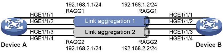

Ethernet link aggregation application scenario
As shown in Figure 1, Device A and Device B are connected by three physical Ethernet links. These physical Ethernet links are combined into an aggregate link called link aggregation 1. The bandwidth of this aggregate link can reach up to the total bandwidth of the three physical Ethernet links. At the same time, the three Ethernet links back up one another. When a physical Ethernet link fails, the traffic transmitted on the failed link is switched to the other two links.
Figure 1 Ethernet link aggregation diagram

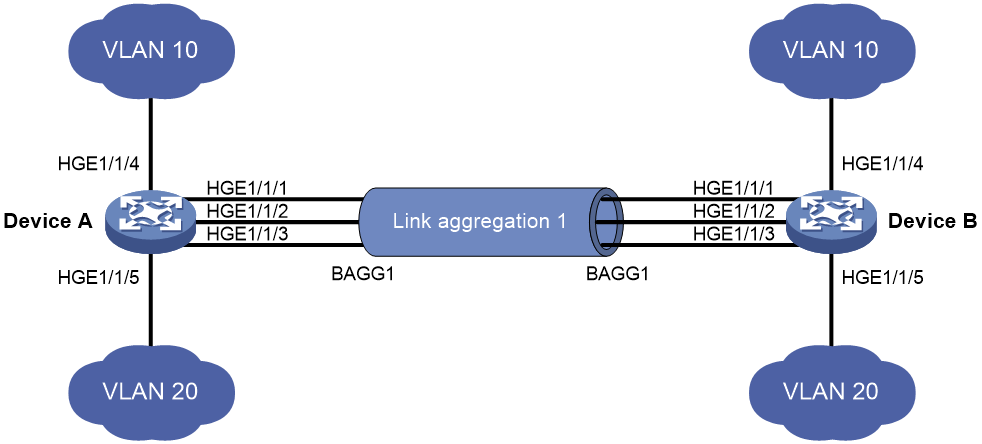

Example: Configuring a Layer 2 static aggregation group
On the network shown in Figure 6, perform the following tasks:
·     Configure a Layer 2 static aggregation group on both Device A and Device B.
·     Enable VLAN 10 at one end of the aggregate link to communicate with VLAN 10 at the other end.
·     Enable VLAN 20 at one end of the aggregate link to communicate with VLAN 20 at the other end.
Figure 6 Network diagram
1.     Configure Device A:
# Create VLAN 10, and assign port HundredGigE 1/1/4 to VLAN 10.
<DeviceA> system-view
[DeviceA] vlan 10
[DeviceA-vlan10] port hundredgige 1/1/4
[DeviceA-vlan10] quit
# Create VLAN 20, and assign port HundredGigE 1/1/5 to VLAN 20.
[DeviceA] vlan 20
[DeviceA-vlan20] port hundredgige 1/1/5
[DeviceA-vlan20] quit
# Create Layer 2 aggregate interface Bridge-Aggregation 1.
[DeviceA] interface bridge-aggregation 1
[DeviceA-Bridge-Aggregation1] quit
# Assign ports HundredGigE 1/1/1 through HundredGigE 1/1/3 to link aggregation group 1.
[DeviceA] interface hundredgige 1/1/1
[DeviceA-HundredGigE1/1/1] port link-aggregation group 1
[DeviceA-HundredGigE1/1/1] quit
[DeviceA] interface hundredgige 1/1/2
[DeviceA-HundredGigE1/1/2] port link-aggregation group 1
[DeviceA-HundredGigE1/1/2] quit
[DeviceA] interface hundredgige 1/1/3
[DeviceA-HundredGigE1/1/3] port link-aggregation group 1
[DeviceA-HundredGigE1/1/3] quit
# Configure Layer 2 aggregate interface Bridge-Aggregation 1 as a trunk port and assign it to VLANs 10 and 20.
[DeviceA-Bridge-Aggregation1] port link-type trunk
[DeviceA-Bridge-Aggregation1] port trunk permit vlan 10 20
2.     Configure Device B in the same way Device A is configured. (Details not shown.)

Example: Configuring a Layer 2 dynamic aggregation group
On the network shown in Figure 7, perform the following tasks:
·     Configure a Layer 2 dynamic aggregation group on both Device A and Device B.
Figure 7 Network diagram

Example: Configuring Layer 2 aggregation load sharing
On the network shown in Figure 8, perform the following tasks:
·     Configure Layer 2 static aggregation groups 1 and 2 on Device A and Device B, respectively.
·     Configure link aggregation groups 1 and 2 to load share traffic across aggregation group member ports.
¡     Configure link aggregation group 1 to load share packets based on source MAC addresses.
¡     Configure link aggregation group 2 to load share packets based on destination MAC addresses.
Figure 8 Network diagram

Example: Configuring Layer 3 aggregation load sharing
On the network shown in Figure 12, perform the following tasks:
·     Configure Layer 3 static aggregation groups 1 and 2 on Device A and Device B, respectively.
·     Configure IP addresses and subnet masks for the corresponding Layer 3 aggregate interfaces.
·     Configure link aggregation group 1 to load share packets based on source IP addresses.
·     Configure link aggregation group 2 to load share packets based on destination IP addresses.
Figure 12 Network diagram
# Create Layer 3 aggregate interface Route-Aggregation 1.
[DeviceA] interface route-aggregation 1
# Configure Layer 3 aggregation group 1 to load share packets based on source IP addresses.
[DeviceA-Route-Aggregation1] link-aggregation load-sharing mode source-ip
# Configure an IP address and subnet mask for Layer 3 aggregate interface Route-Aggregation 1.
[DeviceA-Route-Aggregation1] ip address 192.168.1.1 24
[DeviceA-Route-Aggregation1] quit
# Assign Layer 3 Ethernet interfaces HundredGigE 1/1/1 and HundredGigE 1/1/2 to aggregation group 1.
# Create Layer 3 aggregate interface Route-Aggregation 2.
[DeviceA] interface route-aggregation 2
# Configure Layer 3 aggregation group 2 to load share packets based on destination IP addresses.
[DeviceA-Route-Aggregation2] link-aggregation load-sharing mode destination-ip
# Configure an IP address and subnet mask for Layer 3 aggregate interface Route-Aggregation 2.
[DeviceA-Route-Aggregation2] ip address 192.168.2.1 24
[DeviceA-Route-Aggregation2] quit
# Assign Layer 3 Ethernet interfaces HundredGigE 1/1/3 and HundredGigE 1/1/4 to aggregation group 2.
[DeviceA-HundredGigE1/1/3] port link-aggregation group 2
[DeviceA] interface hundredgige 1/1/4
[DeviceA-HundredGigE1/1/4] port link-aggregation group 2
[DeviceA-HundredGigE1/1/4] quit
# Display detailed information about all aggregation groups on Device A.
[DeviceA] display link-aggregation verbose
Loadsharing Type: Shar -- Loadsharing, NonS -- Non-Loadsharing
Port Status: S -- Selected, U -- Unselected, I -- Individual
Port: A -- Auto port, M -- Management port, R -- Reference port
Flags:  A -- LACP_Activity, B -- LACP_Timeout, C -- Aggregation,
        G -- Defaulted, H -- Expired
Aggregate Interface: Route-Aggregation1
Aggregation Mode: Static
Management VLANs: None
  Port             Status  Priority Oper-Key
  HGE1/1/1(R)      S       32768    1
  HHGE1/1/2        S       32768    1
Aggregate Interface: Route-Aggregation2
  HGE1/1/3(R)      S       32768    2
  HHGE1/1/4        S       32768    2
The output shows that:
·     Link aggregation groups 1 and 2 are both load-shared Layer 3 static aggregation groups.
·     Each aggregation group contains two Selected ports.
# Display all the group-specific load sharing modes on Device A. (This example applies to products that do not support dynamic load sharing mode.)
[DeviceA] display link-aggregation load-sharing mode interface
Route-Aggregation1 Load-Sharing Mode:
  source-ip address
Route-Aggregation2 Load-Sharing Mode:
  destination-ip address
# Display all the group-specific load sharing modes on Device A. (This example applies to products that support dynamic load sharing mode.)
The dynamic load sharing mode takes effect if it exists.
Route-Aggregation1 load-sharing mode:
Dynamic:
  N/A
Static:
  source-ip address
Route-Aggregation2 load-sharing mode:
Dynamic:
  N/A
Static:
·     Link aggregation group 1 distributes packets based on source IP addresses.
·     Link aggregation group 2 distributes packets based on destination IP addresses.
