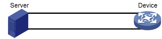

You can configure a multiport unicast MAC address entry to associate a unicast destination MAC address with multiple ports. The frame with a destination MAC address matching the entry is sent out of multiple ports.
For example, in NLB unicast mode (see Figure 1):
·     All servers within a cluster uses the cluster's MAC address as their own address.
·     Frames destined for the cluster are forwarded to every server in the group.
In this case, you can configure a multiport unicast MAC address entry on the device connected to the server group. Then, the device forwards the frame destined for the server group to every server through all ports connected to the servers within the cluster.
Figure 1 NLB cluster

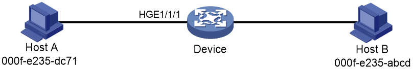

Disabling MAC address learning on a VLAN
When global MAC address learning is enabled, you can disable MAC address learning on a per-VLAN basis.
As shown in Figure 2, VLAN 2, VLAN 3, and VLAN 10 are configured on the network to isolate users from different departments. To save MAC address entry resources on the core device and deny external access to these VLANs, you can disable MAC address learning for the VLANs other than VLAN 2, VLAN 3, and VLAN 10 on Device A and Device B.

Disabling the device from learning the source MAC addresses of Layer 2 protocol packets
As shown in Figure 3, the server attached to the device has two NICs that use the same MAC address. The NICs send LLDP protocol packets sourced from the same MAC address to the device, and that MAC address moves frequently between the server-facing interfaces of the device. To resolve this issue, disable the device from learning the source MAC addresses of Layer 2 protocol packets.
Figure 3 Frequent MAC moves caused by protocol packets
If you disable the device from learning the source MAC addresses of Layer 2 protocol packets, the device does not learn the source MAC addresses of the following protocol packets:
