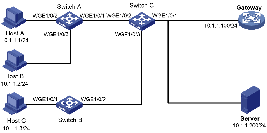

As shown in Figure 1, hosts are connected to Switch C through Switch A and Switch B, which are called Ethernet access nodes (EANs). The MFF-enabled EANs forward packets from hosts to the gateway for further forwarding. The hosts are isolated at Layer 2, but they can communicate at Layer 3.
Figure 1 Network diagram for MFF

As shown in Figure 2, all the devices are in VLAN 100. Hosts A, B, and C are assigned IP addresses manually.
Configure MFF to isolate the hosts at Layer 2 and allow them to communicate with each other through the gateway at Layer 3.
Figure 2 Network diagram
