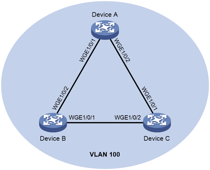

As shown in Figure 3, configure loop detection on Device A to meet the following requirements:
·     Device A generates a log as a notification.
·     Device A automatically shuts down the interface on which a loop is detected.
Figure 3 Network diagram

# View the system logs on devices, for example, Device A.
[DeviceA]
%Feb 24 15:04:29:663 2019 DeviceA LPDT/4/LPDT_LOOPED:  A loop was detected on Twenty-FiveGigE1/0/1.
%Feb 24 15:04:29:664 2019 DeviceA LPDT/4/LPDT_VLAN_LOOPED: A loop was detected on Twenty-FiveGigE1/0/1 in VLAN 100.
%Feb 24 15:04:29:667 2019 DeviceA LPDT/4/LPDT_LOOPED: A loop was detected on Twenty-FiveGigE1/0/2.
%Feb 24 15:04:29:668 2019 DeviceA LPDT/4/LPDT_VLAN_LOOPED: A loop was detected on Twenty-FiveGigE1/0/2 in VLAN 100.
%Feb 24 15:04:44:243 2019 DeviceA LPDT/5/LPDT_VLAN_RECOVERED: A loop was removed on Twenty-FiveGigE1/0/1 in VLAN 100.
%Feb 24 15:04:44:243 2019 DeviceA LPDT/5/LPDT_RECOVERED: All loops were removed on Twenty-FiveGigE1/0/1.
%Feb 24 15:04:44:248 2019 DeviceA LPDT/5/LPDT_VLAN_RECOVERED: A loop was removed on Twenty-FiveGigE1/0/2 in VLAN 100.
%Feb 24 15:04:44:248 2019 DeviceA LPDT/5/LPDT_RECOVERED: All loops were removed on Twenty-FiveGigE1/0/2.
The output shows the following information:
·     Device A detected loops on Twenty-FiveGigE 1/0/1 and Twenty-FiveGigE 1/0/2 within a loop detection interval.
·     Loops on Twenty-FiveGigE 1/0/1 and Twenty-FiveGigE 1/0/2 were removed.
# Use the display loopback-detection command to display the loop detection configuration and status on devices, for example, Device A.
[DeviceA] display loopback-detection
Loop detection is enabled.
Global loop detection interval is 35 second(s).
Loop is detected on following interfaces:
  Interface                      Action mode     VLANs/VSI
 Twenty-FiveGigE1/0/1           Shutdown        100
 Twenty-FiveGigE1/0/2           Shutdown        100
The output shows that the device has removed the loops from Twenty-FiveGigE 1/0/1 and Twenty-FiveGigE 1/0/2 according to the shutdown action.
# Display the status of Twenty-FiveGigE 1/0/1 on devices, for example, Device A.
[DeviceA] display interface twenty-fivegige 1/0/1
Twenty-FiveGigE1/0/1 current state: DOWN (Loop detection down)
The output shows that Twenty-FiveGigE 1/0/1 is already shut down by the loop detection module.
# Display the status of Twenty-FiveGigE 1/0/2 on devices, for example, Device A.
[DeviceA] display interface twenty-fivegige 1/0/2
Twenty-FiveGigE1/0/2 current state: DOWN (Loop detection down)
The output shows that Twenty-FiveGigE 1/0/2 is already shut down by the loop detection module.
