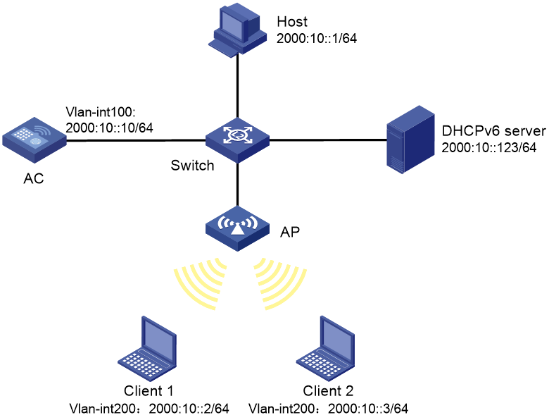

As shown in Figure 1, Client 1 supports stateful IPv6 address configuration and obtains an IPv6 address through the DHCPv6 server. Client 2 is assigned a static IPv6 address. Both of the clients access the same wireless network.
Enable IPv6SG to generate IPv6SG bindings based on DHCPv6 so that the AP forwards the packets only from Client 1.
Figure 1 Network diagram
Use the serial ID labeled on the AP's rear panel to specify an AP.
