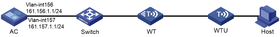

As shown in Figure 1, the AC connects to the WT through the switch and the WT connects to the host through the wireless terminator unit (WTU). The AC acts as a DHCP server to assign IP addresses to the WT and host. The WTU runs in version 2 and supports wireless and wired connection.
Figure 1 Network diagram
