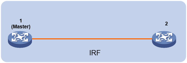

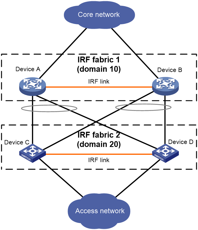

The Intelligent Resilient Framework (IRF) technology virtualizes multiple physical devices at the same layer into one virtual fabric to provide data center class availability and scalability. IRF virtualization technology offers processing power, interaction, unified management, and uninterrupted maintenance of multiple devices.
IRF network model

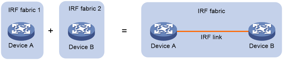

Figure 1 shows an IRF fabric that has two devices, which appear as a single node to the upper-layer and lower-layer devices.
Figure 1 IRF application scenario

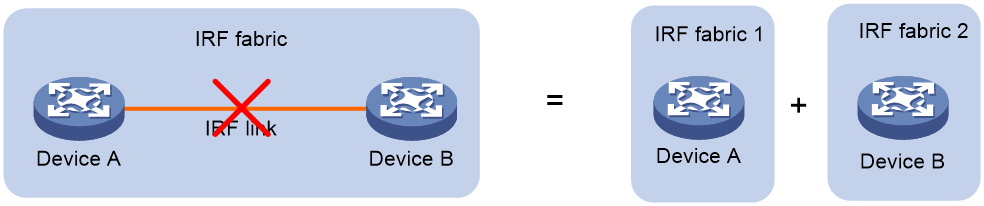

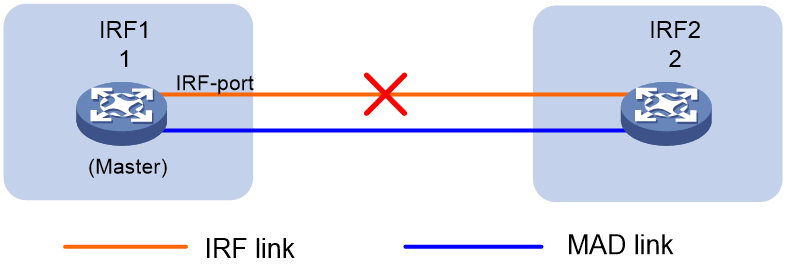

IRF split
IRF split occurs when an IRF fabric breaks up into multiple IRF fabrics because of IRF link failures, as shown in Figure 2. The split IRF fabrics operate with the same IP address. IRF split causes routing and forwarding problems on the network. To quickly detect a multi-active collision, configure a minimum of one MAD mechanism (see "Configuring MAD").
Figure 2 IRF split

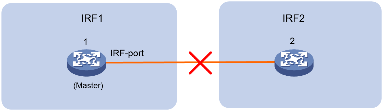

MAD
An IRF link failure causes an IRF fabric to split in two IRF fabrics operating with the same Layer 3 settings, including the same IP address. To avoid IP address collision and network problems, IRF uses multi-active detection (MAD) mechanisms to detect the presence of multiple identical IRF fabrics, handle collisions, and recover from faults.

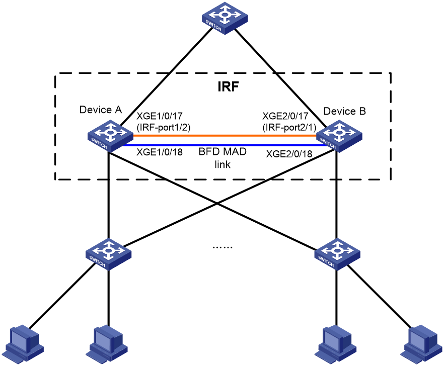

IRF domain ID
One IRF fabric forms one IRF domain. IRF uses IRF domain IDs to uniquely identify IRF fabrics and prevent IRF fabrics from interfering with one another.
As shown in Figure 4, IRF fabric 1 contains Device A and Device B, and IRF fabric 2 contains Device C and Device D. Both fabrics use the links between them for MAD. When a member device receives a MAD packet, it checks the domain ID to determine whether the packet is from the local IRF fabric. Then, the member device can handle the packet correctly.
Figure 4 A network that contains two IRF domains

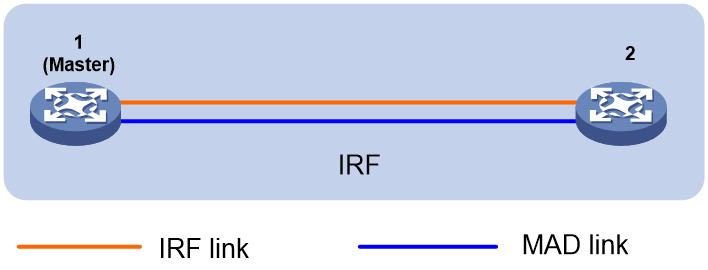

An IRF fabric can use a daisy-chain or ring topology. As shown in Figure 5, a ring topology is more reliable. In ring topology, the failure of one IRF link does not cause the IRF fabric to split as in daisy-chain topology. Rather, the IRF fabric changes to a daisy-chain topology without interrupting network services.
Figure 5 Daisy-chain topology vs. ring topology

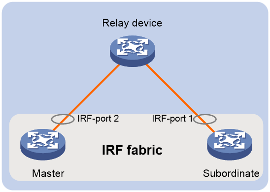

As shown in Figure 6, you can connect two distant IRF member devices through Layer 2 relay devices (for example, Layer 2 switches).
Figure 6 IRF fabric connected through relay devices

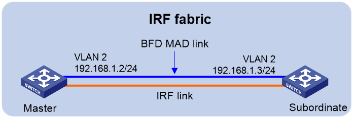

IRF provides MAD mechanisms by extending BFD, ARP, and IPv6 ND to detect multi-active collisions. As a best practice, configure a minimum of one MAD mechanism on an IRF fabric. For more information about the MAD mechanisms and their application scenarios, see "MAD mechanisms."
For information about BFD, see High Availability Configuration Guide. For information about ARP, see Layer 3—IP Services Configuration Guide. For information about ND, see IPv6 basics in Layer 3—IP Services Configuration Guide.

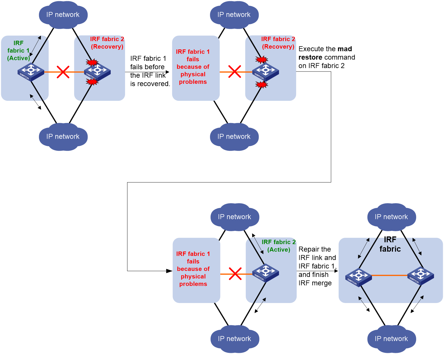

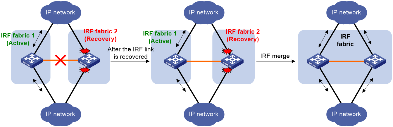

Failure recovery
To merge two split IRF fabrics, first repair the failed IRF link and remove the IRF link failure.
After the failed IRF link between two split IRF fabrics is recovered, log in to the inactive IRF fabric to reboot its member devices if the system requires you to do so. After these member devices join the active IRF fabric as subordinate devices, the IRF merge is complete, as shown in Figure 7. The network interfaces that have been shut down by MAD automatically restore their original state.
CAUTION
CAUTION:
If you inadvertently reboot the active IRF fabric after the failed IRF link recovers, its member devices will join the inactive IRF fabric with their network interfaces being shut down by MAD. To restore the original states of the network interfaces in the merged IRF fabric, use the mad restore command.
Figure 7 Recovering the IRF fabric
If the active IRF fabric fails before the IRF link is recovered (see Figure 8), use the mad restore command on the inactive IRF fabric to recover the inactive IRF fabric. This command brings up all network interfaces that were shut down by MAD. After the IRF link is repaired, merge the two parts into a unified IRF fabric.
Figure 8 Active IRF fabric fails before the IRF link is recovered

BFD MAD
BFD MAD detects multi-active collisions by using BFD.
You can use common Ethernet ports for BFD MAD. BFD MAD has the following requirements:
·     All member devices must have a BFD MAD link to each other.
·     Assign all ports on the BFD MAD links to the same VLAN. Assign each member device a MAD IP address on the VLAN interface.
·     The BFD MAD links and BFD MAD VLAN must be dedicated. Do not use the BFD MAD links or BFD MAD VLAN for any other purposes.
The MAD addresses identify the member devices and must belong to the same subnet.
Figure 9 shows a typical BFD MAD scenario.
With BFD MAD, the master attempts to establish BFD sessions with other member devices by using its MAD IP address as the source IP address.
·     If the IRF fabric is integrated, only the MAD IP address of the master takes effect. The master cannot establish a BFD session with any other member. If you execute the display bfd session command, the state of the BFD sessions is Down.
·     When the IRF fabric splits, the IP addresses of the masters in the split IRF fabrics take effect. The masters can establish a BFD session. If you execute the display bfd session command, the state of the BFD session between the two devices is Up.
Figure 9 BFD MAD scenario

BFD MAD VLAN and feature compatibility
·     Do not use the BFD MAD VLAN and its member ports for any purpose other than configuring BFD MAD.
·     Use only the mad bfd enable and mad ip address commands on the BFD MAD-enabled VLAN interface. If you configure other features, both BFD MAD and other features on the interface might run incorrectly.
MAD IP address
·     To avoid network issues, only use the mad ip address command to configure IP addresses on the BFD MAD-enabled VLAN interface. Do not configure an IP address by using the ip address command on the BFD MAD-enabled VLAN interface.
·     Make sure all the MAD IP addresses are on the same subnet.
Configuring BFD MAD on a VLAN interface
2.     (Optional.) Assign a domain ID to the IRF fabric.
irf domain domain-id
By default, the domain ID of an IRF fabric is 0.
3.     Create a VLAN dedicated to BFD MAD.
vlan vlan-id
By default, only VLAN 1 exists.
Do not enable BFD MAD on VLAN-interface 1.
4.     Return to system view.
5.     Enter Ethernet interface view or interface range view.
¡     Enter Ethernet interface view.
¡     Enter interface range view. Choose one of the following commands:
interface range { interface-type interface-number [ to interface-type interface-number ] } &<1-24>
interface range name name [ interface { interface-type interface-number [ to interface-type interface-number ] } &<1-24> ]
To assign a range of ports to the BFD MAD VLAN, enter interface range view.
To assign one port to the BFD MAD VLAN, enter Ethernet interface view.
6.     Assign the port or the range of ports to the BFD MAD VLAN.
¡     Assign the ports to the VLAN as access ports.
port access vlan vlan-id
¡     Assign the ports to the VLAN as trunk ports.
port trunk permit vlan vlan-id
¡     Assign the ports to the VLAN as hybrid ports.
port hybrid vlan vlan-id { tagged | untagged }
The link type of BFD MAD ports can be access, trunk, or hybrid.
The default link type of a port is access.
7.     Return to system view.
8.     Enter VLAN interface view.
interface vlan-interface vlan-interface-id
9.     Enable BFD MAD.
mad bfd enable
By default, BFD MAD is disabled.
10.     Assign a MAD IP address to a member device on the VLAN interface.
mad ip address ip-address { mask | mask-length } member member-id
By default, no MAD IP addresses are configured on any VLAN interfaces.
Repeat this step to assign a MAD IP address to each member device on the VLAN interface.

Example: Configuring a BFD MAD-enabled IRF fabric
As shown in Figure 11, use Device A and Device B to set up an IRF fabric. Configure BFD MAD on the IRF fabric for multi-active detection and handling.
Figure 11 Network diagram
1.     Configure Device A:
# Shut down the physical interface used for IRF connection.
<Sysname> system-view
[Sysname] interface ten-gigabitethernet 1/0/17
[Sysname-Ten-GigabitEthernet1/0/17] shutdown
[Sysname-Ten-GigabitEthernet1/0/17] quit
# Bind Ten-GigabitEthernet 1/0/17 to IRF-port 1/2.
[Sysname] irf-port 1/2
[Sysname-irf-port1/2] port group interface ten-gigabitethernet 1/0/17
[Sysname-irf-port1/2] quit
# Bring up the physical interface and save the configuration.
[Sysname-Ten-GigabitEthernet1/0/17] undo shutdown
[Sysname] save
# Activate the IRF port configuration.
[Sysname] irf-port-configuration active
2.     Configure Device B:
# Change the member ID of Device B to 2 and reboot the device to have the change take effect.
[Sysname] irf member 1 renumber 2
Renumbering the member ID may result in configuration change or loss. Continue? [Y/N]:y
[Sysname] quit
<Sysname> reboot
# Connect Device B to Device A as shown in Figure 11, and log in to Device B. (Details not shown.)
[Sysname] interface ten-gigabitethernet 2/0/17
[Sysname-Ten-GigabitEthernet2/0/17] shutdown
[Sysname-Ten-GigabitEthernet2/0/17] quit
# Bind Ten-GigabitEthernet 2/0/17 to IRF-port 2/1.
[Sysname] irf-port 2/1
[Sysname-irf-port2/1] port group interface ten-gigabitethernet 2/0/17
[Sysname-irf-port2/1] quit
[Sysname-Ten-GigabitEthernet2/0/17] undo shutdown
[Sysname] save
The two devices perform master election, and the one that has lost the election reboots to form an IRF fabric with the master.
3.     Configure BFD MAD:
# Create VLAN 3, and add Ten-GigabitEthernet 1/0/18 and Ten-GigabitEthernet 2/0/18 to VLAN 3.
[Sysname] vlan 3
[Sysname-vlan3] port ten-gigabitethernet 1/0/18 ten-gigabitethernet 2/0/18
[Sysname-vlan3] quit
# Create VLAN-interface 3, and configure a MAD IP address for each member device on the VLAN interface.
[Sysname] interface vlan-interface 3
[Sysname-Vlan-interface3] mad bfd enable
[Sysname-Vlan-interface3] mad ip address 192.168.2.1 24 member 1
[Sysname-Vlan-interface3] mad ip address 192.168.2.2 24 member 2
[Sysname-Vlan-interface3] quit
Example: Configuring an ARP MAD-enabled IRF fabric
As shown in Figure 12, use Device A and Device B to set up an IRF fabric. Configure ARP MAD on the IRF fabric for multi-active detection and handling.
Figure 12 Network diagram
[Sysname] save
[Sysname] quit
<Sysname> reboot
# Connect Device B to Device A as shown in Figure 12, and log in to Device B. (Details not shown.)
[Sysname] save
3.     Configure ARP MAD:
# Configure the IRF fabric to change its bridge MAC address as soon as the address owner leaves.
[Sysname] undo irf mac-address persistent
# Set the domain ID of the IRF fabric to 1.
[Sysname] irf domain 1
# Create VLAN 3, and assign Ten-GigabitEthernet 1/0/18 and Ten-GigabitEthernet 2/0/18 to VLAN 3.
[Sysname] vlan 3
# Create VLAN-interface 3, assign it an IP address, and enable ARP MAD on the interface.
[Sysname-Vlan-interface3] ip address 192.168.2.1 24
[Sysname-Vlan-interface3] mad arp enable
You need to assign a domain ID (range: 0-4294967295)
[Current domain ID is: 1]:
The assigned domain ID is: 1

Example: Removing a member device from an IRF fabric without MAD in place
As shown in Figure 14, the IRF fabric contains two member devices, in which member 1 is the master device. MAD is not configured on the IRF fabric.
Remove member device 2 from the IRF fabric.
Figure 14 Network diagram
1.     Enable the IRF fabric to change its bridge MAC address as soon as the address owner leaves the fabric.
<System> system-view
[System] undo irf mac-address persistent
2.     Shut down the network interfaces that connect member device 2 to the upstream and downstream devices. (Details not shown.)
3.     Use one of the following methods to split the IRF fabric into two IRF fabrics (IRF 1 and IRF 2):
¡     Disconnect the physical IRF links between IRF 1 and IRF 2, as shown in Figure 15.
Figure 15 Disconnecting physical IRF links
¡     Shut down the IRF physical interfaces that connect IRF 1 and IRF 2, as shown in Figure 15. (Details not shown.)
The IRF fabric splits into IRF 1 and IRF 2. Because MAD is not configured, both IRF 1 and IRF 2 are active. The member device in IRF 2 automatically becomes the master device on split.

Example: Removing a member device from an IRF fabric with MAD in place
As shown in Figure 16, the IRF fabric contains two member devices, in which member 1 is the master device. MAD is configured on the IRF fabric.
Figure 16 Network diagram
¡     Disconnect the physical IRF links between IRF 1 and IRF 2, as shown in Figure 17.
Figure 17 Disconnecting physical IRF links
¡     Shut down the IRF physical interfaces that connect IRF 1 and IRF 2, as shown in Figure 17. (Details not shown.)
The IRF fabric splits into IRF 1 and IRF 2. Because MAD is configured, IRF 1 remains active and IRF 2 is placed in Recovery state and becomes inactive.
