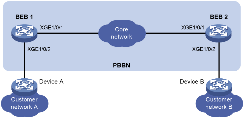

Example: Configuring a basic PBB network
As shown in Figure 4, configure PBB to provide connectivity between network A and network B of a customer.
Figure 4 Network diagram
1.     Configure BEB 1:
# Create VLAN 20.
<BEB1> system-view
[BEB1] vlan 20
[BEB1-vlan20] quit
# Enable L2VPN.
[BEB1] l2vpn enable
# Create a VSI of the PBB type.
[BEB1] vsi aaa
# Specify the I-SID as 1.
[BEB1-vsi-aaa] pbb i-sid 1
# Specify B-VLAN 20 for the PBB VSI.
[BEB1-vsi-aaa-1] bvlan 20
[BEB1-vsi-aaa-1] quit
[BEB1-vsi-aaa] quit
# Configure Ten-GigabitEthernet 1/0/1 as a trunk port, assign it to VLAN 20, and configure it as an uplink port of the PBB VSI.
[BEB1] interface ten-gigabitethernet 1/0/1
[BEB1-Ten-GigabitEthernet1/0/1] port link-type trunk
[BEB1-Ten-GigabitEthernet1/0/1] port trunk permit vlan 20
[BEB1-Ten-GigabitEthernet1/0/1] pbb uplink vsi aaa
[BEB1-Ten-GigabitEthernet1/0/1] quit
# Create Ethernet service instance 1 on Ten-GigabitEthernet 1/0/2.
[BEB1] interface ten-gigabitethernet 1/0/2
[BEB1-Ten-GigabitEthernet1/0/2] service-instance 1
# Configure the Ethernet service instance to match all 802.1Q tagged frames. Map the service instance to the PBB VSI, and set the access mode to Ethernet.
[BEB1-Ten-GigabitEthernet1/0/2-srv1] encapsulation tagged
[BEB1-Ten-GigabitEthernet1/0/2-srv1] xconnect vsi aaa access-mode ethernet
[BEB1-Ten-GigabitEthernet1/0/2-srv1] quit
[BEB1-Ten-GigabitEthernet1/0/2] quit
# Configure Ethernet encapsulation for the PBB VSI.
[BEB1] vsi aaa
[BEB1-vsi-aaa-1] encapsulation ethernet
2.     Configure BEB 2 in the same way BEB 1 is configured. (Details not shown.)
# Display PBB VSI connections on BEB 1.
[BEB1] display pbb connection
BMAC            BVLAN  Port       Type  Aging
011e-8300-0001  20     XGE1/0/1    MC    N
000f-e200-0001  20     XGE1/0/1    UC    Y
# Verify that Device A and Device B can ping each other. (Details not shown.)
