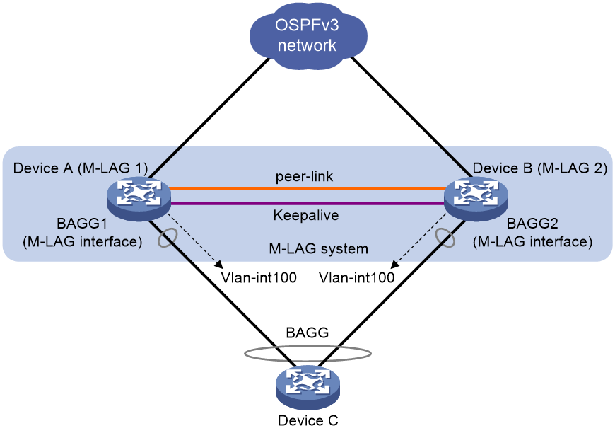

Establishing OSPFv3 neighbor relationships on an M-LAG network
When a customer-side device accesses the OSPFv3 network through both M-LAG member devices in an M-LAG system, the M-LAG member devices provide Layer 3 gateway services. The gateway interfaces (such as VLAN or VSI interfaces) on different M-LAG member devices might generate the same link-local address because they have the same IP address and MAC address. In this case, the M-LAG member devices cannot establish OSPFv3 neighbor relationships with the customer-side device.
To resolve this issue, configure the gateway interfaces to use M-LAG virtual IPv6 addresses for OSPFv3 neighbor relationship establishment. The M-LAG virtual IPv6 address configured for a gateway interface must be a link-local address because OSPFv3 uses link-local addresses for OSPFv3 neighbor relationship establishment. For more information about M-LAG, see M-LAG configuration in Layer 2—LAN Switching Configuration Guide.
As shown in Figure 1, Device C accesses the OSPFv3 network through the M-LAG system that consists of Device A and Device B. Device A and Device B provide Layer 3 gateway services. The gateway interface VLAN-interface 100 on Device A and the gateway interface VLAN-interface 100 on Device B have the same IP address and the same MAC address. To ensure that both Device A and Device B can establish an OSPFv3 neighbor relationship with Device C, configure different M-LAG virtual IPv6 addresses for the VLAN interfaces on Device A and Device B.
Figure 1 OSPFv3 neighbor relationship establishment on an M-LAG network
