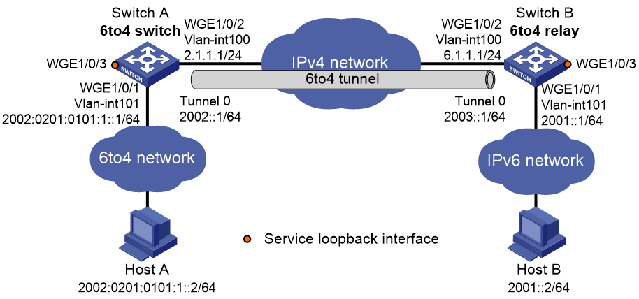

·     6to4 relay
6to4 relay connects a 6to4 network and an IPv6 network that uses an IP prefix other than 2002::/16. A 6to4 relay router is a gateway that forwards packets from a 6to4 network to an IPv6 network.
As shown in Figure 2, 6to4 network Site 1 communicates with IPv6 network Site 3 over a 6to4 tunnel. Configure a static route on the border router (Device A) in the 6to4 network. The next hop address must be the 6to4 address of the 6to4 relay router (Device C). Device A forwards all packets destined for the IPv6 network over the 6to4 tunnel, and Device C then forwards them to the IPv6 network.
Figure 2 Principle of 6to4 tunneling and 6to4 relay

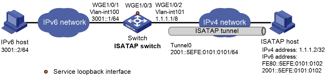

ISATAP tunneling
An ISATAP tunnel is a point-to-multipoint automatic tunnel. It provides a solution to connect an IPv6 host and an IPv6 network over an IPv4 network.
The destination address of an ISATAP tunnel is an ISATAP address. The address format is prefix:0:5EFE:abcd:efgh/64.
·     The 64-bit prefix is a valid IPv6 unicast address prefix.
·     The abcd:efgh/64 segments represent a 32-bit IPv4 address in hexadecimal notation, which identifies the tunnel destination but does not require global uniqueness.
ISATAP tunnels are mainly used for communication between IPv6 routers or between an IPv6 host and an IPv6 router over an IPv4 network.
Figure 3 Principle of ISATAP tunneling

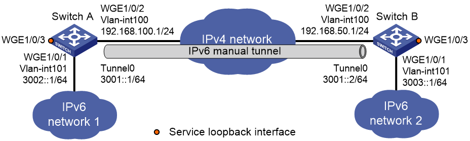

Example: Configuring an IPv6 over IPv4 manual tunnel
As shown in Figure 4, configure an IPv6 over IPv4 tunnel between Switch A and Switch B so the two IPv6 networks can reach each other over the IPv4 network. Because the tunnel destination IPv4 address cannot be automatically obtained from the destination IPv6 addresses, configure an IPv6 over IPv4 manual tunnel.
Figure 4 Network diagram
Make sure Switch A and Switch B have the corresponding VLAN interfaces created and can reach each other through IPv4.

Example: Configuring 6to4 relay
As shown in Figure 6, Switch A is a 6to4 switch, and 6to4 addresses are used on the connected IPv6 network. Switch B acts as a 6to4 relay switch and is connected to the IPv6 network (2001::/16). Configure a 6to4 tunnel between Switch A and Switch B to make Host A and Host B reachable to each other.
The configuration on a 6to4 relay switch is similar to that on a 6to4 switch. To enable communication between the 6to4 network and the IPv6 network, configure a route destined for the IPv6 network on the 6to4 switch. The IPv4 address of VLAN-interface 100 on the relay switch is 6.1.1.1/24 and its corresponding 6to4 prefix is 2002:0601:0101::/48. The next hop of the static route must be an address using this prefix.
Figure 6 Network diagram

Example: Configuring an ISATAP tunnel
As shown in Figure 7, configure an ISATAP tunnel between the switch and the ISATAP host so the ISATAP host in the IPv4 network can access the IPv6 network.
Figure 7 Network diagram

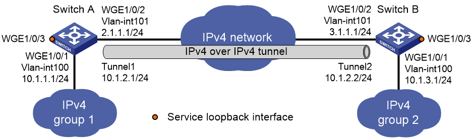

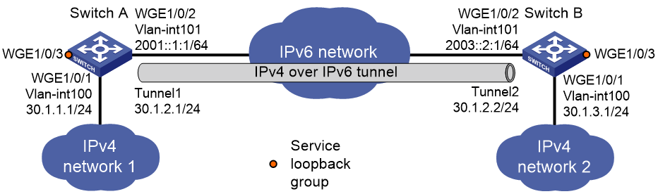

IPv4 over IPv4 tunneling
About IPv4 over IPv4 tunneling
IPv4 over IPv4 tunneling (RFC 1853) enables isolated IPv4 networks to communicate. For example, an IPv4 over IPv4 tunnel can connect isolated private IPv4 networks over a public IPv4 network.
Figure 8 IPv4 over IPv4 tunnel
Figure 8 shows the encapsulation and de-encapsulation processes.
·     Encapsulation:
a.     Device A receives an IP packet from an IPv4 host and submits it to the IP protocol stack.
b.     The IPv4 protocol stack determines how to forward the packet according to the destination address in the IP header. If the packet is destined for the IPv4 host connected to Device B, Device A delivers the packet to the tunnel interface.
c.     The tunnel interface adds a new IPv4 header to the IPv4 packet and submits it to the IP protocol stack.
In the new header, the source IP address specifies the tunnel source, and the destination IP address specifies the tunnel destination.
d.     The IP protocol stack uses the destination IP address of the new IP header to look up the routing table, and then sends the packet out.
·     De-encapsulation:
a.     After receiving the packet, Device B delivers it to the IP protocol stack.
b.     If the protocol number is 4 (indicating an IPv4 packet is encapsulated within the packet), the IP protocol stack delivers the packet to the tunnel module for de-encapsulation.
c.     The tunnel module de-encapsulates the IP packet and sends it back to the IP protocol stack.
d.     The protocol stack forwards the de-encapsulated packet.

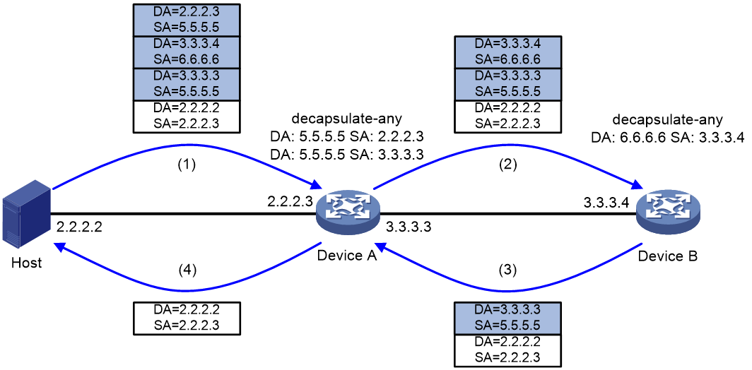

Constructing multi-layer encapsulated IPv4-in-IPv4 packets on a host
Set the destination address of a packet as the IP address of the host, and then encapsulate IP headers layer by layer to the packet.
The encapsulation order of IP headers in the IPv4-in-IPv4 packet must be opposite to the order of nodes along the path that the packet traverses. The number of encapsulated IP headers is the number of link node devices × 2 - 1.
In the IPv4-in-IPv4 packet, the source and destination addresses in an IP header must be consistent with the source-destination address pair on the node that decapsulates that IP header.
·     The source address in the IP header must be the same as the destination address in the source-destination address pair.
·     The destination address in the IP header must be one of the source IP addresses in the source-destination address pair.
Testing the reachability of a path
When a multi-layer encapsulated IPv4-in-IPv4 packet passes through a node, the node matches the outmost source and destination addresses of the packet with the local source-destination address pair.
·     If the addresses match, the node decapsulates the outmost IP header from the packet.
·     If the addresses do not match, the node does not decapsulate the outmost IP header from the packet.
After the node decapsulates the IP header, it forwards the packet to the next node according to the forwarding table. The subsequent nodes along the path successively perform the same matching and decapsulation operations as this node until the end node completes the decapsulation. Because the destination address of the original packet is the host's IP address, the end node forwards the packet back to the host.
·     If the packet can return to the host, the path is reachable.
·     If the packet cannot return to the host, the path is not reachable.
For example, test the reachability of a path that has two nodes. The test order is Host>A>B.
Figure 9 IPv4-in-IPv4 packet decapsulation workflow
The workflow is as follows:
1.     The host constructs a multi-layer decapsulated IPv4-in-IPv4 packet and sends it to Device A.
2.     After receiving the packet, Device A finds that the outmost IP header of the packet matches the local source-destination address pair for IPv4-in-IPv4 packet decapsulation. Then, Device A decapsulates the outmost IP header from the packet and forwards the packet to Device B according to the forwarding table.
3.     After receiving the packet, Device B finds that the outmost IP header of the packet matches the local source-destination address pair for IPv4-in-IPv4 packet decapsulation. Then, Device B decapsulates the outmost IP header from the packet and forwards the packet to the next node (Device A) according to the forwarding table.
4.     Device A repeats the matching and decapsulation operations the same as Device B to decapsulate the last layer of IP header from the packet. Then, Device A forwards the packet to the host according to the forwarding table.
5.     The host receives the packet or not. If the host receives the packet, the path is reachable. If the host does not receive the packet, the path is not reachable.
IPv4 over IPv4 tunnel configuration examples
Example: Configuring an IPv4 over IPv4 tunnel
As shown in Figure 10, the two subnets IPv4 group 1 and IPv4 group 2 use private IPv4 addresses. Configure an IPv4 over IPv4 tunnel between Switch A and Switch B to make the two subnets reachable to each other.
Figure 10 Network diagram

IPv4 over IPv6 tunneling
About IPv4 over IPv6 tunneling
Implementation
IPv4 over IPv6 tunneling adds an IPv6 header to IPv4 packets so that the IPv4 packets can pass an IPv6 network through a tunnel to realize interworking between isolated IPv4 networks.
Figure 11 IPv4 over IPv6 tunnel
Figure 11 shows the encapsulation and de-encapsulation processes.
·     Encapsulation:
a.     Upon receiving an IPv4 packet, Device A delivers it to the IPv4 protocol stack.
b.     The IPv4 protocol stack uses the destination address of the packet to determine the egress interface. If the egress interface is the tunnel interface, the IPv4 protocol stack delivers the packet to the tunnel interface.
c.     The tunnel interface adds an IPv6 header to the original IPv4 packet and delivers the packet to the IPv6 protocol stack.
d.     The IPv6 protocol stack uses the destination IPv6 address of the packet to look up the routing table, and then sends it out.
·     De-encapsulation:
a.     Upon receiving the IPv6 packet from the attached IPv6 network, Device B delivers the packet to the IPv6 protocol stack to examine the protocol type encapsulated in the data portion of the packet.
b.     If the protocol type is IPv4, the IPv6 protocol stack delivers the packet to the tunneling module.
c.     The tunneling module removes the IPv6 header and delivers the remaining IPv4 packet to the IPv4 protocol stack.
d.     The IPv4 protocol stack forwards the IPv4 packet.

Example: Configuring an IPv4 over IPv6 tunnel
As shown in Figure 12, configure an IPv4 over IPv6 tunnel between Switch A and Switch B so the two networks can reach each other over the IPv6 network.
Figure 12 Network diagram
Make sure Switch A and Switch B have the corresponding VLAN interfaces created and can reach each other through IPv6.
1.     Configure Switch A:
# Add Twenty-FiveGigE 1/0/1 to VLAN 100.
<SwitchA> system-view
[SwitchA] vlan 100
[SwitchA-vlan100] port twenty-fivegige 1/0/1
[SwitchA-vlan100] quit
# Specify an IPv4 address for VLAN-interface 100.
[SwitchA-Vlan-interface100] ip address 30.1.1.1 255.255.255.0
# Add Twenty-FiveGigE 1/0/2 (the physical interface of the tunnel) to VLAN 101.
[SwitchA] vlan 101
[SwitchA-vlan101] port twenty-fivegige 1/0/2
[SwitchA-vlan101] quit
# Specify an IPv6 address for VLAN-interface 101.
[SwitchA] interface vlan-interface 101
[SwitchA-Vlan-interface101] ipv6 address 2001::1:1 64
[SwitchA-Vlan-interface101] quit
# Create IPv6 tunnel interface Tunnel 1.
[SwitchA] interface tunnel 1 mode ipv6
# Specify an IPv4 address for the tunnel interface.
[SwitchA-Tunnel1] ip address 30.1.2.1 255.255.255.0
# Specify the IP address of VLAN-interface 101 as the source address for the tunnel interface.
[SwitchA-Tunnel1] source 2001::1:1
# Specify the IP address of VLAN-interface 101 on Switch B as the destination address for the tunnel interface.
[SwitchA-Tunnel1] destination 2003::2:1
[SwitchA-Tunnel1] quit
# Configure a static route destined for IPv4 network 2 through the tunnel interface.
[SwitchA] ip route-static 30.1.3.0 255.255.255.0 tunnel 1

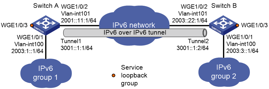

IPv6 over IPv6 tunneling
About IPv6 over IPv6 tunneling
IPv6 over IPv6 tunneling (RFC 2473) enables isolated IPv6 networks to communicate with each other over another IPv6 network. For example, two isolated IPv6 networks that do not want to show their addresses to the Internet can use an IPv6 over IPv6 tunnel to communicate with each other.
Figure 13 Principle of IPv6 over IPv6 tunneling
Figure 13 shows the encapsulation and de-encapsulation processes.
·     Encapsulation:
a.     After receiving an IPv6 packet, Device A submits it to the IPv6 protocol stack.
b.     The IPv6 protocol stack uses the destination IPv6 address of the packet to find the egress interface. If the egress interface is the tunnel interface, the stack delivers it to the tunnel interface.
c.     After receiving the packet, the tunnel interface adds an IPv6 header to it and submits it to the IPv6 protocol stack.
d.     The IPv6 protocol stack forwards the packet according to its destination IPv6 address.
·     De-encapsulation:
a.     Upon receiving the IPv6 packet, Device B delivers it to the IPv6 protocol stack.
b.     The IPv6 protocol stack checks the protocol type of the data portion encapsulated in the IPv6 packet. If the encapsulation protocol is IPv6, the stack delivers the packet to the tunneling module.
c.     The tunneling module de-encapsulates the packet and sends it back to the IPv6 protocol stack.

As shown in Figure 14, configure an IPv6 over IPv6 tunnel between Switch A and Switch B so the two networks can reach each other without disclosing their IPv6 addresses.
Figure 14 Network diagram
