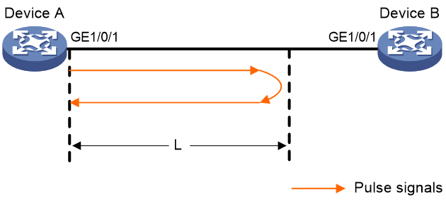

Forcibly bringing up a fiber port
As shown in Figure 2, a fiber port uses separate fibers for transmitting and receiving packets. The physical state of the fiber port is up only when both transmit and receive fibers are physically connected. If one of the fibers is disconnected, the fiber port does not work.
To enable a fiber port to forward traffic over a single link, you can use the port up-mode command. This command forcibly brings up a fiber port, even when no fiber links or transceiver modules are present for the fiber port. When one fiber link is present and up, the fiber port can forward packets over the link unidirectionally.
Figure 2 Forcibly bring up a fiber port
·     Copper ports do not support this feature.
·     The port up-mode, shutdown, and loopback commands are mutually exclusive.
·     A fiber port does not support this feature if the port is shut down by a protocol or by using the shutdown command.
·     A fiber port does not support this feature if the port joins an aggregation group.
·     A fiber port forcibly brought up stays physically up whether or not a transceiver module or a fiber link is present for the port.
·     A GE fiber port forcibly brought up cannot correctly forward traffic if it is installed with a fiber-to-copper converter, 100/1000-Mbps transceiver module, or 100-Mbps transceiver module. To solve the problem, use the undo port up-mode command on the fiber port.

Testing the cable connection of an Ethernet interface
IMPORTANT
IMPORTANT:
If the link of an Ethernet interface is up, testing its cable connection will cause the link to go down and then come up.
The virtual cable test (VCT) technology uses time domain reflectometry (TDR) to detect the cable status. When pulse signals are transmitted in a cable, some energy of the signals is reflected at the end or a failure point on the cable. This phenomenon is called TDR. The VCT algorithm measures the time spent in transmitting pulse signals over a cable, reaching the failure point, and returning the pulse signals. The measured time is converted into the distance.
As shown in Figure 4, GE 1/0/1 on Device A is connected to GE 1/0/1 on Device B through a cable. A failure point exists on the cable. After VCT is configured on GE 1/0/1 on Device A, the system will generate pulse signals. Some energy of the signals is reflected at the failure point on the cable. Suppose the distance from Device A to the failure point is L, the interval between sending signals and receiving reflected signals is T, and the signal transmission speed on the cable is V. Then, the distance between GE 1/0/1 on Device A and the failure point can be calculated as follows: L=(V×T)/2.
Figure 4 Schematic diagram for VCT
VCT detects the network cable failure type and identifies the failure point, facilitating failure location on network cables.
Fiber ports do not support this feature.
2.     Enter Ethernet interface view.
3.     Perform a test for the cable connected to the Ethernet interface.
virtual-cable-test
