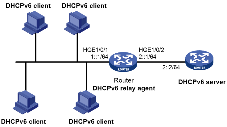

As shown in Figure 1, IPSG forwards only the packets that match an IPSG binding.
Figure 1 IPSG application

As shown in Figure 4, DHCP relay agent is enabled on the router. The host obtains an IP address from the DHCP server through the DHCP relay agent.
Enable dynamic IPv4SG on HundredGigE 1/0/1 to filter incoming packets by using the IPv4SG bindings generated based on DHCP relay entries.
Figure 4 Network diagram
IMPORTANT
IMPORTANT:
·     By default, interfaces on the device are disabled (in ADM or Administratively Down state). To have an interface operate, you must use the undo shutdown command to enable that interface.
·     Physical interfaces in this example must operate in Layer 2 mode. By default, physical interfaces on the device operate in Layer 3 mode. To change the operation mode for physical interfaces, you must use the port link-mode command in interface view.
1.     Configure the DHCP relay agent:

2.     Enable IPv4SG on HundredGigE 1/0/1 and verify the source IP address and MAC address for dynamic IPSG.
[Router] interface hundredgige 1/0/1
[Router-HundredGigE1/0/1] ip verify source ip-address mac-address
[Router-HundredGigE1/0/1] quit
# Display dynamic IPv4SG bindings generated based on DHCP relay entries.
[Router] display ip source binding dhcp-relay
Total entries found: 1
IP Address      MAC Address    Interface                VLAN Type
192.168.0.1     0001-0203-0406 HGE1/0/1                 N/A  DHCP relay
The output shows that HundredGigE 1/0/1 will filter packets based on the IPv4SG binding.
