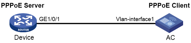

Router-initiated network structure
As shown in Figure 1, the PPPoE session is established between devices (Device A and Device B). All hosts share one PPPoE session for data transmission without being installed with PPPoE client software. This network structure is typically used by enterprises.

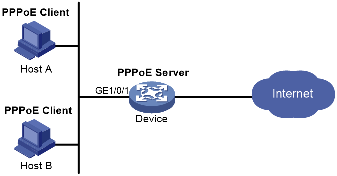

Host-initiated network structure
As shown in Figure 2, a PPPoE session is established between each host (PPPoE client) and the carrier device (PPPoE server). The service provider assigns an account to each host for billing and control. The host must be installed with PPPoE client software.

Example: Configuring a PPPoE client in diagnostic mode
As shown in Figure 5, Device serves as a PPPoE server. Configure AC as a PPPoE client operating in diagnostic mode, and set the diagnostic interval to 200 seconds.
Figure 5 Network diagram
1.     Configure Device as the PPPoE server:
# Configure an IP address for Virtual-Template 1 and specify an IP address for the peer.
<Device> system-view
[Device] interface virtual-template 1
[Device-Virtual-Template1] ip address 1.1.1.1 255.0.0.0
[Device-Virtual-Template1] remote address 1.1.1.2
# Configure Virtual-Template 1 to authenticate the peer by using PAP.
[Device-Virtual-Template1] ppp authentication-mode pap domain dm1
[Device-Virtual-Template1] quit
# Enable the PPPoE server on GigabitEthernet 1/0/1, and bind the interface to Virtual-Template 1.
[Device] interface gigabitethernet 1/0/
[Device-GigabitEthernet1/0/1] pppoe-server bind virtual-template 1
# Configure a PPPoE user.
[Device] local-user user1 class network
[Device-luser-network-user1] password simple 123456TESTplat&!
[Device-luser-network-user1] service-type ppp
[Device-luser-network-user1] quit
# Configure local AAA for the PPP users in ISP domain dm1.
[Device] domain dm1
[Device-isp-dm1] authentication ppp local
[Device-isp-dm1] accounting ppp local
[Device-isp-dm1] authorization ppp local
[Device-isp-dm1] quit
2.     Configure AC as the PPPoE client.
# Create dialer group 1 and configure a dial rule for it.
<AC> system-view
[AC] dialer-group 1 rule ip permit
# Enable bundle DDR on Dialer 1.
[AC] interface dialer 1
[AC-Dialer1] dialer bundle enable
# Associate Dialer 1 with dialer group 1.
[AC-Dialer1] dialer-group 1
# Configure Dialer 1 to obtain an IP address through PPP negotiation.
[AC-Dialer1] ip address ppp-negotiate
# On Dialer 1, configure the PAP username and password sent from AC to Device as user1 and 123456TESTplat&! when AC is authenticated by Device by using PAP.
[AC-Dialer1] ppp pap local-user user1 password simple 123456TESTplat&!
[AC-Dialer1] quit
# Configure a PPPoE session that corresponds to dialer bundle 1 (dialer bundle 1 corresponds to Dialer 1).
[AC] interface vlan-interface 1
[AC-Vlan-interface1] pppoe-client dial-bundle-number 1
[AC-Vlan-interface1] quit
# Configure the PPPoE session to operate in diagnostic mode, and set the diagnostic interval to 200 seconds.
[AC-Dialer1] dialer diagnose interval 200
# Set the DDR auto-dial interval to 10 seconds.
[AC-Dialer1] dialer timer autodial 10
# Display summary information about the PPPoE session established between AC and Device (PPPoE server).
[AC] display pppoe-client session summary
Bundle ID    Interface    VA          RemoteMAC      LocalMAC       State
1      1     GE1/0/1      VA0         00e0-1400-4300 00e0-1500-4100 SESSION
