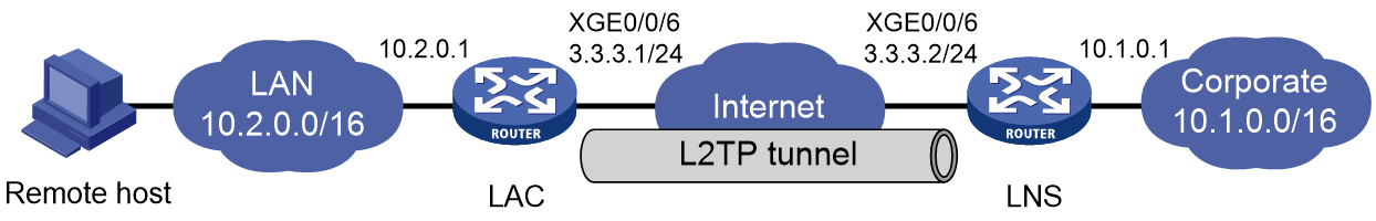

Typical L2TP networking
Figure 1 L2TP network diagram
As shown in Figure 1, a typical L2TP network has the following components:
·     Remote system—A remote system is usually a remote user's host or a remote branch's device that needs to access the private network.
·     LAC—An L2TP access concentrator (LAC) is both PPP and L2TP capable. It is usually a network access server (NAS) located at a local ISP, which provides access services mainly for PPP users.
An LAC is an endpoint of an L2TP tunnel and lies between an LNS and a remote system. It encapsulates packets received from a remote system by using L2TP and then sends the encapsulated packets to the LNS. It decapsulates packets received from the LNS and then sends the decapsulated packets to the intended remote system.
·     LNS—An L2TP network server (LNS) is both PPP and L2TP capable. It is usually an edge device on an enterprise network.
An LNS is the other endpoint of an L2TP tunnel. It is the logical termination point of a PPP session tunneled by the LAC. L2TP extends the termination point of a PPP session from a NAS to an LNS by establishing a tunnel.

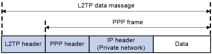

L2TP message types and encapsulation structure
L2TP uses the following types of messages:
·     Control messages—Used to establish, maintain, and delete L2TP tunnels and sessions. Control messages are transmitted over a reliable control channel, which supports flow control and congestion control.
·     Data messages—Used to encapsulate PPP frames, as shown in Figure 2. Data messages are transmitted over an unreliable data channel and are not retransmitted when packet loss occurs. Data messages can use sequence numbers to reorder packets that are disordered during transport.
Figure 2 Data message format

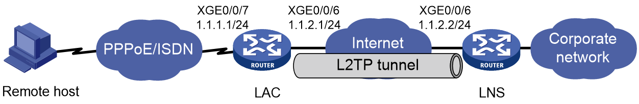

NAS-initiated tunneling mode
As shown in Figure 4, a remote system dials in to the LAC through a PPPoE/ISDN network. The LAC initiates a tunneling request to the LNS over the Internet.
Figure 4 NAS-initiated tunneling mode
A NAS-initiated tunnel has the following characteristics:
·     The remote system only needs to support PPP, and it does not need to support L2TP.
·     Authentication and accounting of the remote system can be implemented on the LAC or LNS.

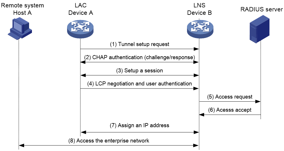

Figure 5 NAS-initiated tunnel establishment process
As shown in Figure 5, the following workflow is used to establish a NAS-initiated tunnel:
1.     A remote system (Host A) initiates a PPP connection to the LAC (Device A).
2.     The remote system and LAC perform PPP LCP negotiation.
3.     The LAC authenticates PPP user information of Host A by using PAP or CHAP.
4.     The LAC sends the authentication information (username and password) to its RADIUS server (RADIUS server A) for authentication.
5.     RADIUS server A authenticates the user and returns the result.
6.     The LAC initiates an L2TP tunneling request to the LNS (Device B) when the following conditions exist:
¡     The user passes the authentication.
¡     The user is determined to be an L2TP user according to the username or the ISP domain to which the user belongs.
7.     If tunnel authentication is needed, the LAC and LNS send CHAP challenge messages to authenticate each other before successfully establishing an L2TP tunnel.
8.     The LAC and LNS negotiate to establish L2TP sessions.
9.     The LAC sends PPP user information and PPP negotiation parameters to the LNS.
10.     The LNS sends the authentication information to its RADIUS server (RADIUS server B) for authentication.
11.     RADIUS server B authenticates the user and returns the result.
12.     If the user passes the authentication, the LNS assigns a private IP address to the remote system (Host A).
13.     The PPP user can access internal resources of the enterprise.
In steps 12 and 13, the LAC forwards packets for the remote system and LNS. Host A and LAC exchange PPP frames, and the LAC and LNS exchange L2TP packets.

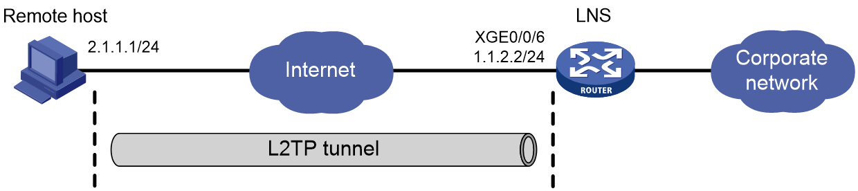

Client-initiated tunneling mode
As shown in Figure 6, a remote system running L2TP (LAC client) has a public IP address to communicate with the LNS through the Internet. The LAC client can directly initiate a tunneling request to the LNS without any dedicated LAC devices.
Figure 6 Client-initiated tunneling mode
A client-initiated tunnel has the following characteristics:
·     A client-initiated tunnel has higher security because it is established between a remote system and the LNS.
·     The remote system must support L2TP and be able to communicate with the LNS. This causes poor expandability.

Example: Configuring a NAS-initiated L2TP tunnel
As shown in Figure 11, a PPP user is connected to an LNS through an LAC.
Set up an L2TP tunnel between the LAC and LNS to allow the PPP user to access the corporate network.
Figure 11 Network diagram
1.     Configure the LAC:
# Configure IP addresses for the interfaces. (Details not shown.)
# Create a local user named vpdnuser, set the password, and enable the PPP service.
<LAC> system-view
[LAC] local-user vpdnuser class network
[LAC-luser-network-vpdnuser] password simple 123456TESTplat&!
[LAC-luser-network-vpdnuser] service-type ppp
[LAC-luser-network-vpdnuser] quit
# Configure local authentication for PPP users in ISP domain system.
[LAC] domain name system
[LAC-isp-system] authentication ppp local
[LAC-isp-system] quit
# Configure CHAP authentication on interface Virtual-Template 1.
[LAC] interface virtual-template 1
[LAC-Virtual-Template1] ppp authentication-mode chap domain system
[LAC-Virtual-Template1] quit
# Enable the PPPoE server on GigabitEthernet1/0/2, and bind the interface to interface Virtual-Template 1.
[LAC] interface gigabitethernet 1/0/2
[LAC-GigabitEthernet1/0/2] pppoe-server bind virtual-template 1
[LAC-GigabitEthernet1/0/2] quit
# Enable L2TP.
[LAC] l2tp enable
# Create L2TP group 1 in LAC mode.
[LAC] l2tp-group 1 mode lac
# Configure the local tunnel name as LAC.
[LAC-l2tp1] tunnel name LAC
# Specify PPP user vpdnuser as the condition for the LAC to initiate tunneling requests.
[LAC-l2tp1] user fullusername vpdnuser
# Specify the LNS IP address as 1.1.2.2.
[LAC-l2tp1] lns-ip 1.1.2.2
# Enable tunnel authentication, and specify the tunnel authentication key as aabbcc.
[LAC-l2tp1] tunnel authentication
[LAC-l2tp1] tunnel password simple aabbcc
[LAC-l2tp1] quit
2.     Configure the LNS:
<LNS> system-view

Example: Configuring a client-initiated L2TP tunnel
As shown in Figure 12, a PPP user directly initiates a tunneling request to the LNS to access the corporate network.
Figure 12 Network diagram
