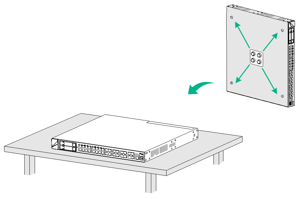

For adequate cooling of the device, follow these guidelines:
·     Install the device at the installation site with its airflow direction meeting the ventilation requirements.
¡     Workbench mountingEnsure a minimum clearance of 100 mm (3.94 in) around the air inlet and outlet vents of the chassis.
¡     19-inch rack mountingEnsure a minimum clearance of 80 mm (3.15 in) around the air inlet and outlet vents of the chassis and a distance of 1U (44.45 mm, or 1.75 in) between the chassis and other devices.
·     Make sure the installation site has a good cooling system.

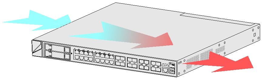

The device provides left side-intake and right side-exhaust airflow for heat dissipation.
Figure1-2 Airflow through the chassis

·     Ensure a minimum clearance of 100 mm (3.94 in) around the air inlet and outlet vents of the chassis for workbench mounting.
·     Ensure a minimum clearance of 80 mm (3.15 in) around the air inlet and outlet vents of the chassis and a distance of 1U (44.45 mm, or 1.75 in) between the chassis and other devices for 19-inch rack mounting.
·     A good ventilation system is available at the installation site.

·     Ensure good ventilation and a minimum clearance of 100 mm (3.94 in) around the chassis for heat dissipation.
·     Avoid placing heavy objects on the device.
·     To stack devices, make sure a minimum vertical distance of 15 mm (0.59 in) is available between two adjacent devices.
If a standard 19-inch rack is not available, you can place the device on a workbench.
To install the device on a workbench:
1.     Verify that the workbench is sturdy and reliably grounded.
2.     Place the device upside down on the workbench and clean the four round holes in the chassis bottom with a dry cloth.
3.     Attach the four rubber feet to the round holes in the chassis bottom.
4.     Place the device with upside up on the workbench.
Figure2-1 Mounting the device on a workbench

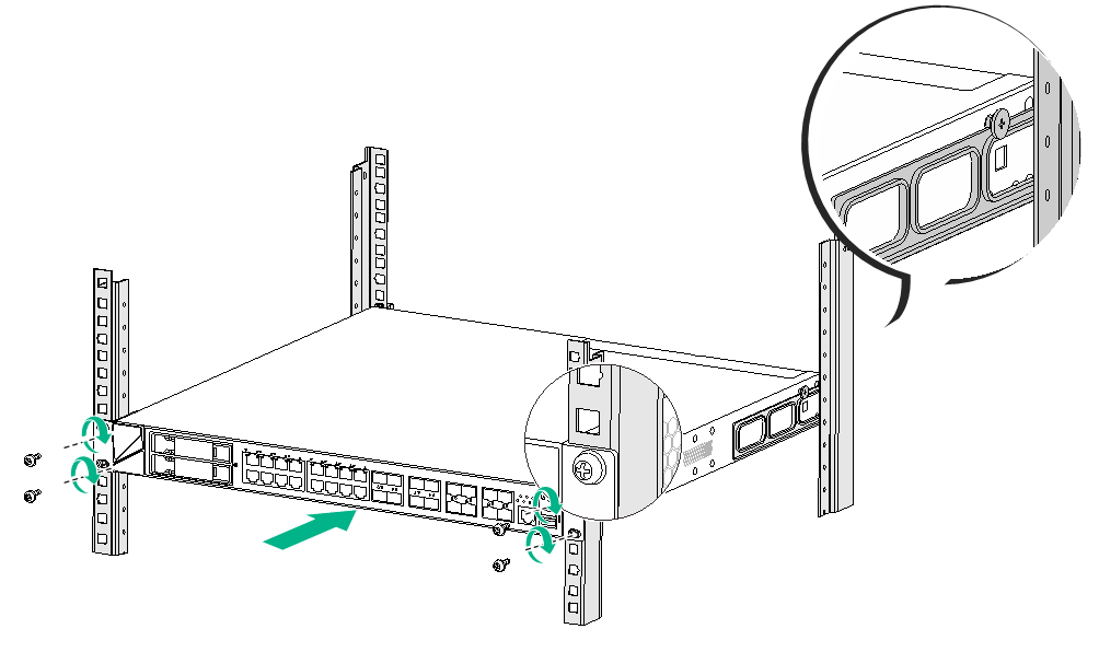

Installing the device in a standard 19-inch rack
WARNING
WARNING!
To avoid bodily injury and device damage, use a minimum of two persons to rack-mount the device.
CAUTION
CAUTION:
·     For adequate heat dissipation, ensure a minimum clearance of 80 mm (3.15 in) around the air inlet and outlet vents of the chassis and a distance of 1U (44.45 mm, or 1.75 in) between the chassis and other devices in the rack.
·     As a best practice, use a rack shelf together with the mounting brackets to support the weight of the chassis.
To install the device in a standard 19-inch rack:
1.     Unpack the device and accessories.

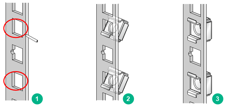

2.     Mark the cage nut installation positions on the rack posts by using the mounting brackets.
Use a front mounting bracket to mark the installation positions on the front rack posts and use a rear mounting bracket to mark the installation positions on the rear rack posts. Install cage nuts.
Figure2-2 Installing cage nuts

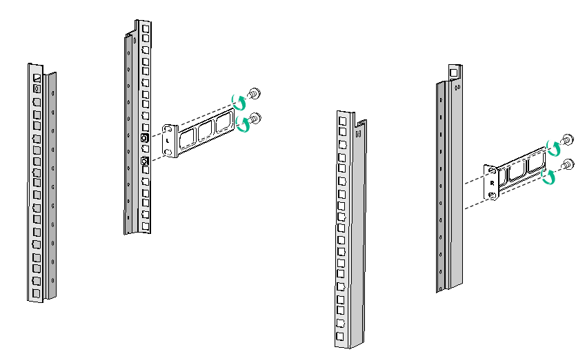

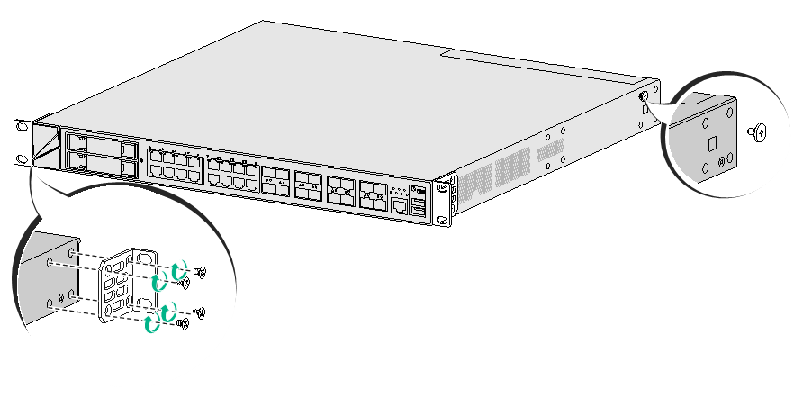

3.     Attach the front mounting brackets and shoulder screws to both sides of the device with M4 screws provided with the device.
Figure2-3 Attaching mounting brackets and shoulder screws to the device

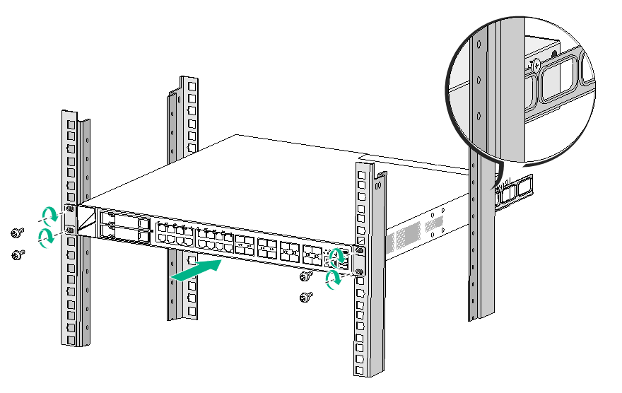

4.     Attach the rear mounting brackets to the rear rack posts. The rear mounting brackets can be attached to the rear rack posts with the wide flange inside or outside the rack.
Table2-2 Installation methods for rear mounting brackets
Distance between the front and rear rack posts
Rear mounting bracket installation method
405 to 569 mm (15.94 to 22.40 in)
With the wide flange inside the rack.
247 to 411 mm (9.72 to 16.18 in)
With the wide flange outside the rack.
Caution:
To prevent the rear mounting brackets from obstructing the closing of the rack door, ensure a distance greater than 153 mm (6.02 in) between the rear rack posts and the interior side of the rack door.
Figure2-4 Attaching the rear mounting brackets to the rear rack posts (with the wide flange inside the rack)
Figure2-5 Attaching the rear mounting brackets  to the rear rack posts (with the wide flange outside the rack)
5.     Mount the device in the rack. Use M6 screws to secure the mounting brackets to the front rack posts and make sure the shoulder screws rest firmly on the upper edge of the rear mounting brackets.
Figure2-6 Mounting the device in the rack (with the wide flange of the rear mounting brackets inside the rack)
Figure2-7 Mounting the device in the rack (with the wide flange of the rear mounting brackets outside the rack)

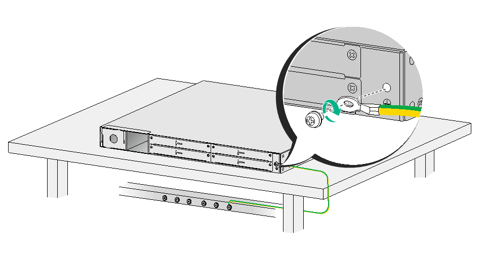

Grounding the device
WARNING
WARNING!
·     Correctly connecting the device grounding cable is crucial to lightning protection and EMI protection.
·     Do not connect the device grounding cable to a fire main or lightning rod.
You can ground the device in one of the following ways, depending on the grounding conditions available at the installation site.
Grounding the device with a grounding strip
If a grounding strip is available at the installation site, connect the grounding cable through the grounding strip.
To connect the grounding cable:
1.     Remove the grounding screw from the device chassis.
2.     Attach the grounding screw to the ring terminal of the grounding cable.
3.     Use a Phillips screwdriver to fasten the grounding screw into the grounding hole on the device.
4.     Remove the hex nut from the grounding strip.
5.     Use a pair of needle-nose pliers to bend a hook at the other end of the grounding cable. Attach the hook to the grounding point, and secure the hook with a screw.
Figure2-8 Grounding the device with a grounding strip

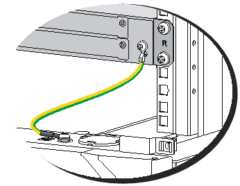

Grounding the device with the grounding terminal on the rack
4.     Remove the grounding screw from the grounding point on the rack.
5.     Attach the ring terminal at the other end of the grounding cable to the grounding point on the rack.
Figure2-9 Grounding the device with the grounding terminal on the rack

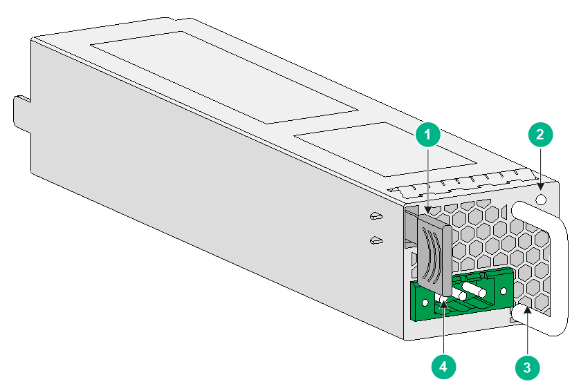

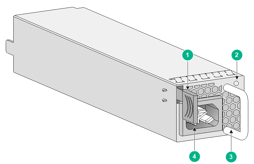

Installing a power supply
CAUTION:
·     Before installing a power supply, make sure the power supply is powered off and the grounding cable is correctly connected.
·     Do not install AC and DC power supplies on the same device.
To install a power supply:

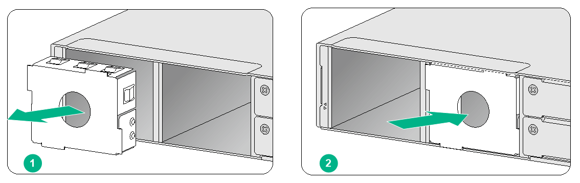

1.     Remove the filler panel (if any) from the target power supply slot.
The device comes with the PWR1 slot empty and the PWR0 slot installed with a filler panel.
Figure2-10 Removing the filler panel from a device
2.     Orient the power supply with its handle at the right. Holding the handle of the module with one hand and supporting the module bottom with the other, slide the power supply slowly into the slot along the guide rails.
Figure2-11 Installing a power supply for a device

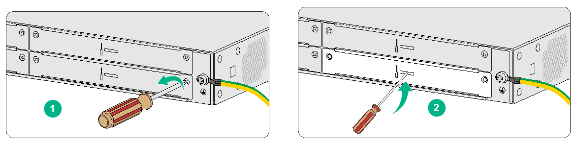

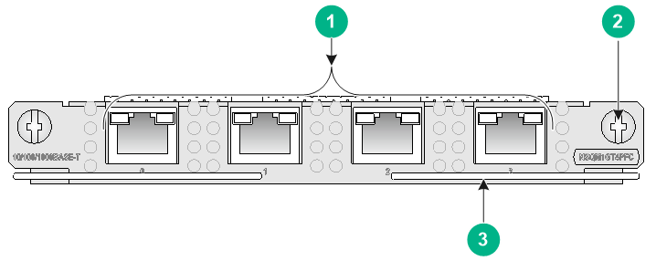

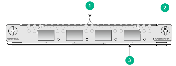

Installing an interface module
CAUTION
CAUTION:
·     Interface modules are not hot swappable.
·     To install two or more interface modules, use the upper interface module slots as a best practice. If you have installed an interface module in a lower slot, you must press down the ejector levers of the interface module while inserting it into an upper slot.
No interface modules are provided with the device. Purchase them as needed. For interface module compatibility with the devices, see "Appendix A  Chassis views and technical specifications."
The installation procedure is the same for all interface modules.

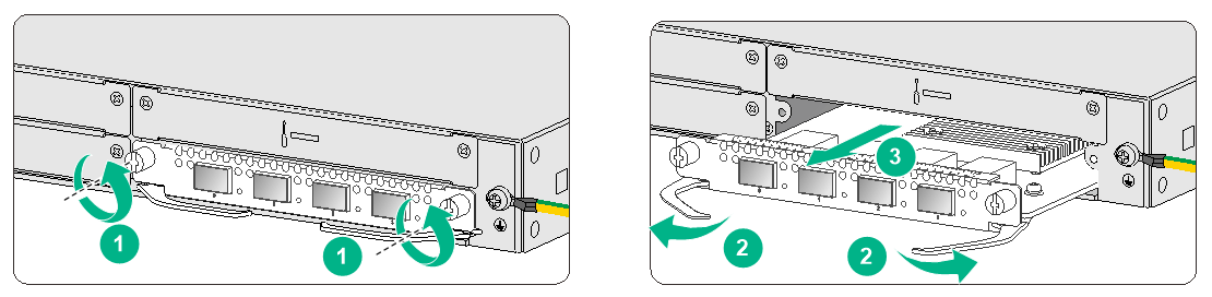

To install an interface module:
1.     Face the rear panel of the device.
2.     Use a Phillips screwdriver to remove the screws on the filler panel and then remove the filler panel.
Keep the filler panel for future use.
Figure2-12 Removing the filler panel

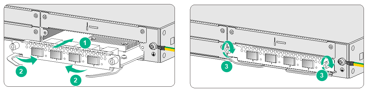

3.     Pull the ejector levers on the module outward and slide the module slowly into the slot along the guide rails.
4.     Press the ejector levers inward until they touch the panel tightly and the module seats into the slot securely.
5.     Use a Phillips screwdriver to fasten the captive screws on the module.
Figure2-13 Installing an interface module

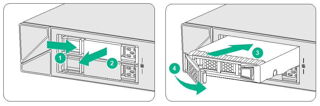

Installing a drive
CAUTION
CAUTION:
·     Drives are not hot swappable.
·     To avoid damage to drives, always hold a drive by its sides. Do not touch any components and do not squeeze, vibrate, or strike a drive.
·     Install a filler panel in empty drive slots to prevent dust and ESD damage.
IMPORTANT
IMPORTANT:
·     The device does not come with any drives and cannot recognize drives from other vendors. Purchase drives from H3C as needed.
·     Before using the drive, execute the fdisk and format commands from the CLI to partition and format the drive.

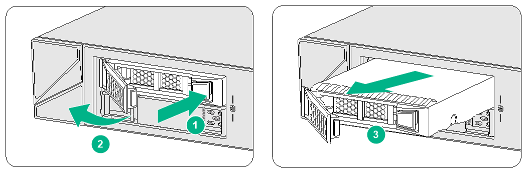

To install a drive:
1.     Remove the filler panel from the drive slot.
2.     Press the button on the drive panel to release the locking lever.
3.     Hold the locking lever and push the drive into the slot slowly along the guide rails. Then close the locking lever.
Figure2-14 Installing a drive

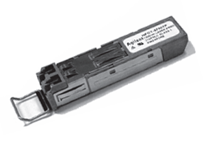

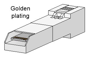

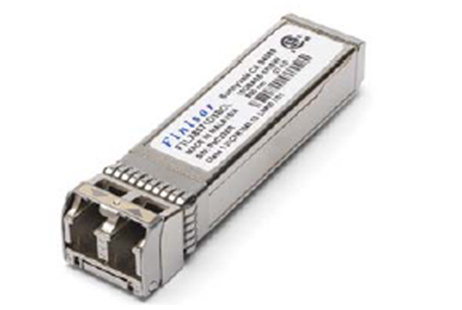

The device supports GE SFP transceiver modules and 10GE SFP+ transceiver modules. For the transceiver module specifications, see port specifications in "Appendix A  Chassis and FRU views and technical specifications."
No transceiver module is provided with the device. As a best practice, use H3C transceiver modules.
Figure2-15 GE SFP transceiver module
图-1副本
Figure2-16 10GE SFP+ transceiver module

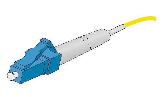

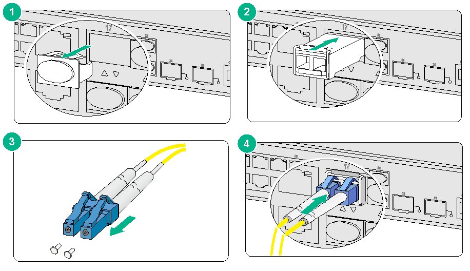

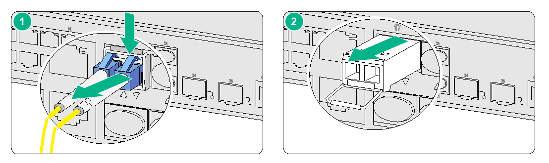

To connect the device to the network through an optical fiber:
1.     Remove the dust plug from the fiber port.
2.     Remove the dust cap from the transceiver module and insert it into the fiber port.
3.     Remove the dust cap of the optical fiber connector, and use dust free paper and absolute alcohol clean the end face of the fiber connector.
4.     Identify the Rx and Tx ports on the transceiver module. Plug one end of the optical fiber into the transceiver module in the device, and plug the other end into the transceiver module in the peer device.
Make sure the Rx port and the Tx port are connected to the Tx port and the Rx port on the peer device, respectively.
Figure2-17 Installing and connecting an optical fiber

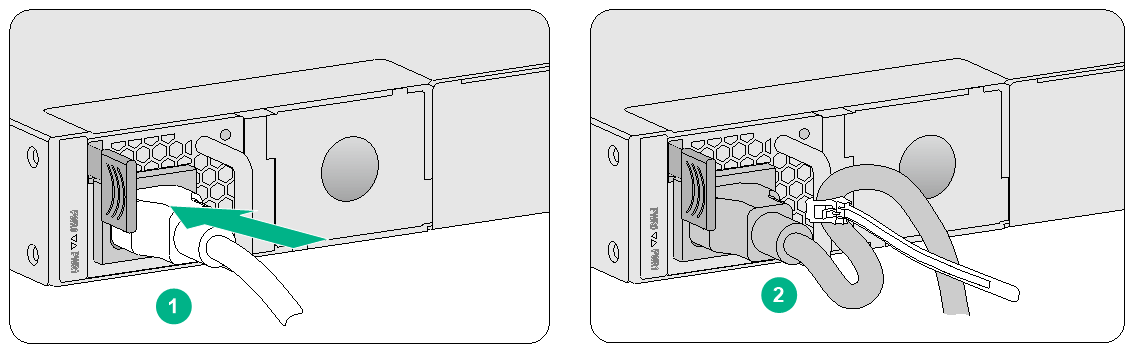

Connecting an AC power cord
1.     Connect the female connector of the AC power cord to the AC-input power receptacle on the power supply.
2.     Use a cable tie to secure the AC power cord to the power supply handle.
3.     Connect the other end of the power cord to an AC power source.
Figure2-18 Connecting an AC power cord

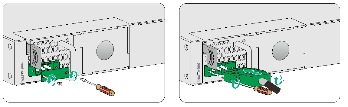

Connecting a DC power cord
1.     Correctly orient the DC power cord connector with the power receptacle on the power supply, and insert the connector into the receptacle.
The receptacle is foolproof. If you cannot insert the connector into the receptacle, re-orient the connector rather than use excessive force to push it in.
2.     Fasten the captive screws on the power cord connector with a flat-head screwdriver to secure the power cord connector.
3.     Use a cable tie to secure the power cord to the handle.
4.     Connect the other end of the power cord to a DC power source.
Figure2-19 Connecting a DC power cord

Replacing a power supply
CAUTION
CAUTION:
Before you replace a power supply, turn off the circuit breaker of the external power supply system and remove the power cord.
The replacement procedure is the same for an AC power supply and a DC power supply. This section takes an AC power supply as an example.
To replace a power supply:
2.     Remove the releasable cable tie from the power cord and then remove the power cord connector from the power supply.
3.     Hold the power supply handle with one hand, press the latch towards the handle, and then pull the power supply part way out of the slot. Supporting the power supply bottom with one hand, slowly pull the power supply out of the slot along the guide rails with the other.
4.     Put the removed power supply in an antistatic bag or on the workbench.
5.     Install a new power supply. For the installation procedure, see "Installing a power supply."
If you are not to install a new power supply, install a filler panel in the slot to ensure good ventilation in the device.
Figure4-1 Removing a power supply
Replacing an interface module
CAUTION
CAUTION:
·     Interface modules are not hot swappable. Power off the device before you replace an interface module.
To replace an interface module:
1.     Power off the device.
2.     Use a Phillips screwdriver to loosen the captive screws of the interface module.
3.     Holding the ejector levers of the interface module with both hands, pull the ejector levers outward, and pull the interface module part way out of the slot along the slide rails. Supporting the bottom of the interface module with one hand, gently pull the interface module out of the slot with the other.
4.     Put the removed interface module (with the circuit board facing upward) on an antistatic workbench or into an antistatic bag.
5.     Install a new interface module. For the installation procedure, see "Installing an interface module."
If you are not to install a new interface module, install a filler panel in the slot to ensure good ventilation in the device.
Figure4-2 Removing an interface module
Replacing a drive
CAUTION
CAUTION:
·     To avoid storage medium damage, execute the umount command from the CLI to unmount all the file systems before removing a drive.
·     Do not hot swap drives.
To replace a drive:
1.     Log in to the Web interface. Click the Unmount button on the Storage settings page.
2.     Wear an ESD wrist strap and make sure it makes good skin contact and is reliably grounded.
3.     Press the button on the drive panel to release the locking lever.
4.     Hold the locking lever and pull the drive out of the slot.
5.     Install a new drive. For the installation procedure, see "Installing a drive."
If you are not to install a new drive in the slot, install a filler panel in the slot to prevent dust and ensure good ventilation.
Figure4-3 Removing a drive
Replacing a transceiver module
WARNING
WARNING!
Disconnected optical fibers or transceiver modules might emit invisible laser light. Do not stare into beams or view directly with optical instruments when the device is operating.
When you replace a transceiver module, make sure the two transceiver modules connected by the same optical fiber are the same type. Do not touch the golden plating of the transceiver module.
Figure4-4 Transceiver module golden plating
To replace a transceiver module:
1.     Use the shutdown command in interface view at the CLI to shut down the optical source before you remove the fiber connector.
2.     Remove the LC connectors with the optical fiber from the transceiver module, and install dust caps to the LC connectors.
3.     Pivot the clasp of the transceiver module down to the horizontal position, and gently pull the transceiver module out.
Figure4-5 Removing the transceiver module
4.     Install dust caps to the removed transceiver module, and put it into the package.
5.     Install a new transceiver module. If you do not install a new transceiver module in the slot, install a dust cap. For information about installing a transceiver module, see "Connecting a fiber port."

Displaying transceiver module information
Identifying transceiver modules
To identify transceiver modules, you can use the following command to view the key parameters of the transceiver modules, including transceiver module type, connector type, central wavelength of the laser sent, transmission distance, and vendor name or name of the vendor who customizes the transceiver modules.
To display transceiver module information:
Remarks
Display key parameters of the transceiver module in a specific interface.
display transceiver interface [ interface-type interface-number ]
Available for all transceiver modules.
Troubleshooting transceiver modules
The system outputs alarm information for you to locate and troubleshoot faults of transceiver modules.
To display the alarming information or fault detection parameters of a transceiver module:
Remarks
Display the current alarm information of the transceiver module in a specific interface.
display transceiver alarm interface [ interface-type interface-number ]

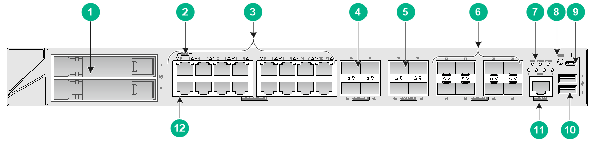

T1000-AI-50

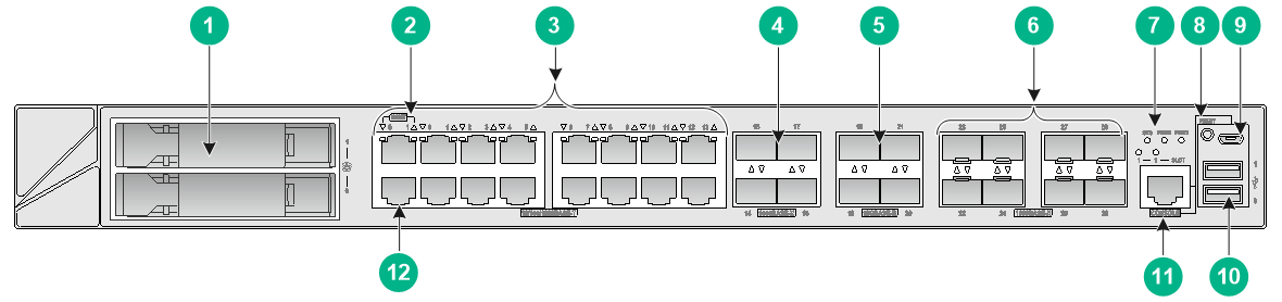

The T1000-AI-50 IPS device provides the following ports and slots on the front panel:
·     Sixteen 10/100/1000BASE-T autosensing Ethernet copper ports (including two out-of-band management Ethernet ports).
·     Twelve 1000BASE-X fiber ports.
·     Four 10GBASE-R fiber ports.
·     Two USB ports.
·     One console port.
·     One micro USB Console port.
·     Two drive slots.
Figure7-1 Front panel
(1) Drive slots
(2) out-of-band Management Ethernet port (1/MGMT)
(3) 10/100/1000BASE-T copper ports
(4) 1000BASE-X fiber ports
(5) 10GBASE-R fiber ports
(6) 1000BASE-X fiber ports
(7) LEDs
(8) Reset button (for device reboot only, and does not restore the factory default)
(9) Micro USB Console port
(10) USB ports
(11) Console port
(12) out-of-band Management Ethernet port (0/MGMT)

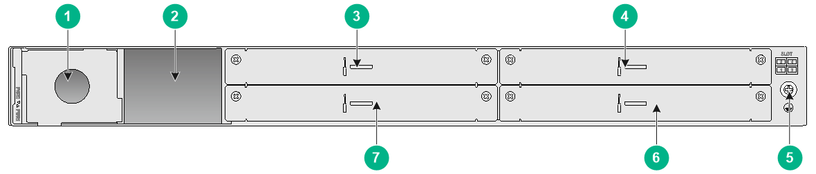

Figure7-2 Rear panel
(1) Power supply slot 1 (PWR0)
(2) Power supply slot 2 (PWR1)
(3) Interface module slot 2
(4) Interface module slot 4 (not supported)
(5) Grounding screw
(6) Interface module slot 3 (not supported)
(7) Interface module slot 1

Figure7-4 Rear panel
(5) Grounding screw

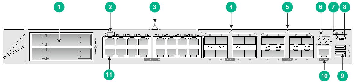

T1000-AI-70/T1000-AI-80/T1000-AI-90
The T1000-AI-70, T1000-AI-80, or T1000-AI-90 IPS device provides the following ports on the front panel:
·     Eight 1000BASE-X fiber ports.
·     Eight 10GBASE-R fiber ports.
·     Two USB ports.
·     One console port.
·     Two drive slots.
Figure7-5 Front panel
(1) Drive slots
(6) LEDs
(7) Reset button (for device reboot only, and does not restore the factory default)
(8) Micro USB port
(9) USB ports
(10) Console port
(11) out-of-band Management Ethernet port (0/MGMT)
Figure7-6 Rear panel
(5) Grounding screw

NSQM1GT4PFC
The NSQM1GT4PFC interface module provides four 10/100/1000BASE-T Ethernet copper ports.
·     When the device is operating correctly, the four ports operate as common data ports.
·     When the device is powered off, the four ports are divided into two bypass port pairs with ports 0 and 1 in one pair and ports 2 and 3 in another pair. The two ports in a pair can act as the uplink and downlink interfaces for a Layer 2 link and form a bypass link. This enables traffic to be transmitted through the device even if the device is powered off and ensures service continuity.
Figure7-7 Front panel of the NSQM1GT4PFC interface module
(1) 10/100/1000BASE-T copper ports
(2) Captive screw
(3) Ejector lever
NSQM1GP4FBA
The NSQM1GP4FBA interface module provides four 1000BASE-X fiber ports.
Figure7-8 Front panel of the NSQM1GP4FBA interface module
(1) 1000BASE-X fiber ports
(2) Captive screw
(3) Ejector lever

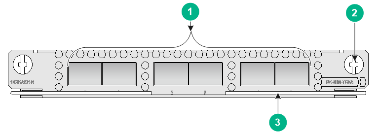

NS-NIM-TG6A
The NS-NIM-TG6A interface module provides six 10GBASE-R fiber ports.
Figure7-9 Front panel of the NS-NIM-TG6A interface module
(1) 10GBASE-R fiber ports
(2) Captive screw
(3) Ejector lever

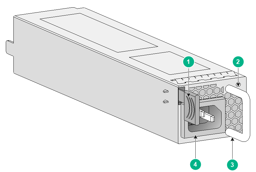

Power supplies
The device comes with power supply slot PWR0 installed with a filler panel and power supply slot PWR1 empty. It supports both AC and DC power supplies. No power supplies are provided with the device. Prepare power supplies for the device yourself as required.
To install two power supplies for the device, make sure they are the same model.
AC power supplies
The PSR250-12A1 power supply with a product code of PSR250-12A1provides a maximum output power of 250 W.
Figure7-10 PSR250-12A1 power supply
(1) Latch
(2) Status LED
(3) Handle
(4) Power receptacle
DC power supplies
The PSR450-12D power supply with a product code of PSR450-12D provides a maximum output power of 450 W.
Figure7-11 PSR450-12D power supply
(1) Latch
(2) Status LED
(3) Handle
High-voltage DC power supplies
The PSR450-12AHD power supply with a product code of PSR450-12AHD provides a maximum output power of 450 W.
Figure7-12 PSR450-12AHD power supply
(1) Latch
(2) Status LED
(3) Handle

10 GE fiber port
Table7-19 10 GE fiber port specifications
Item
Specification
Connector type
LC
Transceiver module type
SFP+
Standard compliance
10GBASE-R
Interface speed
LAN PHY: 10.3125 Gbps
Table7-20 10 Gbps SFP+ transceiver module specifications
Transceiver module
Central wavelength (nm)
Connector type
Cable specifications (µm)
Max transmission distance
SFP-XG-SX-MM850-A
850
LC
50/125, MMF
300 m (984.25 ft)
82 m (269.03 ft)
66 m (216.54 ft)
62.5/125, MMF
33 m (108.27 ft)
26 m (85.30 ft)
SFP-XG-LX220-MM1310
1310
LC
62.5/125, MMF
220 m (721.78 ft)
50/125, MMF
220 m (721.78 ft)
100 m (328.08 ft)
SFP-XG-LX-SM1310
1310
LC
9/125, SMF
10 km (6.21 miles)
SFP-XG-LH40-SM1550
1550
LC
9/125, SMF
40 km (24.86 miles)

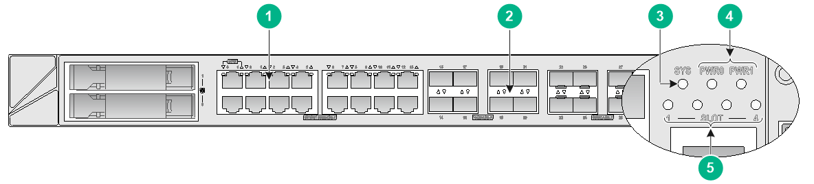

8 Appendix B  LEDs
The device uses similar LEDs. This section uses the LEDs on the T1000-AI-90 IPS device as an example.
Figure8-1 LEDs
(1) Ethernet copper port LED
(2) Ethernet fiber port LED
(3) System status LED
(4) Power supply status LED
(5) Interface module status LED
Table8-2 LED description
LED
Mark
Status
Description
10/100/1000BASE-T
Off
No link is present.
Steady green
A link is present.
Flashing green
The port is receiving and sending data.
1000BASE-X
Off
No link is present.
Steady green
A 1000 Mbps link is present.
Flashing green
The port is receiving and sending data at 1000 Mbps.
10GBASE-R
Off
No link is present.
Steady green
A 10 Gbps link is present.
Flashing green
The port is receiving and sending data at 10 Gbps.
System status LED
SYS
Off
The device is not powered on or has failed.
Slow flashing green
The device is operating correctly.
Fast flashing green
The device is loading software.
PWR0, PWR1
Off
No power supply is present or the power supply has failed.
Steady green
The power supply is operating correctly.
SLOT1, SLOT2, SLOT 3, SLOT 4
Off
No interface module is present or the interface module has failed.
Steady green
The interface module is operating correctly.

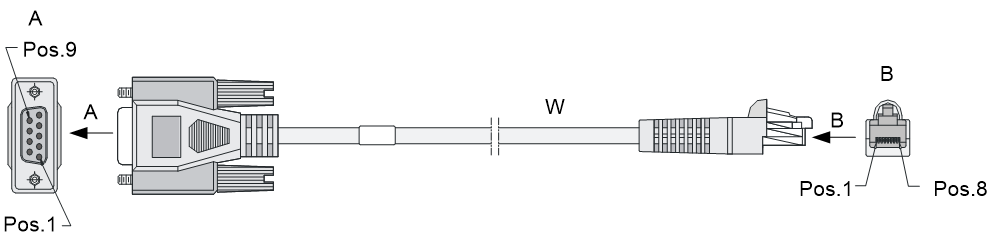

9 Appendix C  Cables
Console cable
RJ-45 to DB9 console cable
An RJ-45 to DB9 console cable is used to connect the console port on the firewall to the serial port on a configuration terminal (a PC for example):
·     Connect the DB9 female connector of the cable to the 8-core serial port on the configuration terminal.
·     Connect the RJ-45 connector of the cable to the console port on the firewall.
Figure9-1 RJ-45 to DB9 console cable
Table9-1 RJ-45 to DB9 console cable pinouts
RJ-45
Signal
Direction
DB-9
1
RTS
7
2
DTR
4
3
TXD
3
4
CD
1
5
GND
5
6
RXD
2
7
DSR
6
8
CTS
8

Fiber connectors are indispensable passive components in an optical fiber communication system. They allow the removable connection between optical channels, which makes the optical system debugging and maintenance more convenient. There are multiple types of fiber connectors. Figure9-6 shows an LC connector.
Figure9-6 Appearance of an LC connector
Follow these guidelines when you connect an optical fiber:
·     Before connecting an optical fiber, make sure the connector and cable type match the interface module.
·     The fiber Ethernet port of the firewall supports only the LC connector.
·     Fiber connectors are fitted with dust caps. Keep the dust caps secure when the fiber connectors are in use. Install dust caps when the fiber connectors are not in use to avoid damage to their end face. Replace the dust cap if it is loose or polluted.
·     Before connecting an optical fiber, use dust free paper and absolute alcohol to clean the end face of the two fiber connectors. You can brush the end faces only in one direction.
·     Never bend or curve a fiber when connecting it.
·     If the fiber has to pass through a metallic board hole, when passing through a metallic board hole or bending along the acute side of mechanical parts, the fiber must wear jackets or cushions.
