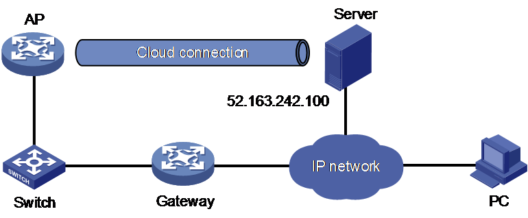

Example: Configuring a cloud connection
As shown in Figure 2, configure the AP to establish a cloud connection with the cloud server.
Figure 2 Network diagram
1.     Configure IP addresses for interfaces as shown in Figure 2, and configure a routing protocol to ensure that the devices can reach each other. (Details not shown.)
2.     Log in to the cloud server to add the serial number of the AP to the server. (Details not shown.)
3.     Configure the domain name of the cloud server as oasiscloud.h3c.com.
<AP> system-view
[AP] cloud-management server domain oasiscloud.h3c.com
·     The DNS service is provided by the ISP DNS server.
·     The cloud server domain name and IP address are for illustration only.
# Verify that the AP and the cloud server have established a cloud connection.
[AP] display cloud-management state
Cloud connection state                      : Established
Device state                                : Request_success
Cloud server address                        : 52.163.242.100
Cloud server domain name                    : oasiscloud.h3c.com
Cloud connection mode                       : Https
Cloud server authentication port            : 19443
Cloud server connection port                : 443
Connected at                                : Wed Jan 27 14:18:40 2018
Duration                                    : 00d 00h 02m 01s
Process state                               : Message received
Failure reason                              : N/A
Last down reason                            : socket connection error (Details:N/A)
Last down at                                : Wed Jan 27 13:18:40 2018
Last report failure reason                  : N/A
Last report failure at                      : N/A
Dropped packets after reaching buffer limit : 0
Total dropped packets                       : 1
Last report incomplete reason               : N/A
Last report incomplete at                   : N/A
Buffer full count                           : 0
