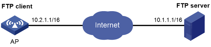

Example: Using the device as an FTP client
As shown in Figure 1, the PC is acting as an FTP server. A user account with username abc and password hello12345 has been created on the PC.
·           Use the AP as an FTP client to log in to the FTP server.
·           Download the temp.bin file from the PC to the AP.
·           Upload configuration file startup.cfg from the AP to the PC for backup.
Figure 1 Network diagram
# Configure IP addresses as shown in Figure 1. Make sure the AP and PC can reach each other. (Details not shown.)
# Examine the storage space of the AP. If the free space is insufficient, use the delete/unreserved file command to delete unused files. (Details not shown.)
# Log in to the FTP server at 10.1.1.1 by using username abc and password hello12345.
<Sysname> ftp 10.1.1.1
Press CTRL+C to abort.
Connected to 10.1.1.1 (10.1.1.1).
220 WFTPD 2.0 service (by Texas Imperial Software) ready for new user
User (10.1.1.1:(none)): abc
331 Give me your password, please
Password:
230 Logged in successfully
Remote system type is MSDOS.
ftp>
# Set the file transfer mode to binary.
ftp> binary
200 TYPE is now 8-bit binary
# Download the temp.bin file from the PC to the AP.
ftp> get temp.bin
local: temp.bin remote: temp.bin
150 Connecting to port 47457
226 File successfully transferred
23951480 bytes received in 95.399 seconds (251.0 kbyte/s)
# Use the ASCII mode to upload configuration file startup.cfg from the AP to the PC for backup.
ftp> ascii
200 TYPE is now ASCII
ftp> put startup.cfg back-startup.cfg
local: startup.cfg remote: back-startup.cfg
150 Connecting to port 47461
3494 bytes sent in 5.646 seconds (618.00 kbyte/s)
ftp> bye
221-Goodbye. You uploaded 2 and downloaded 2 kbytes.
221 Logout.
<Sysname>
