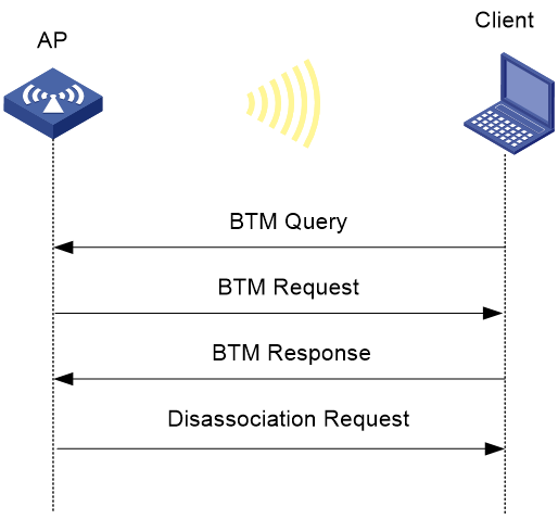

WLAN roaming enables clients to seamlessly roam among wireless services in the same ESS while retaining their IP address and authorization information during the roaming process.
WLAN roaming mechanism

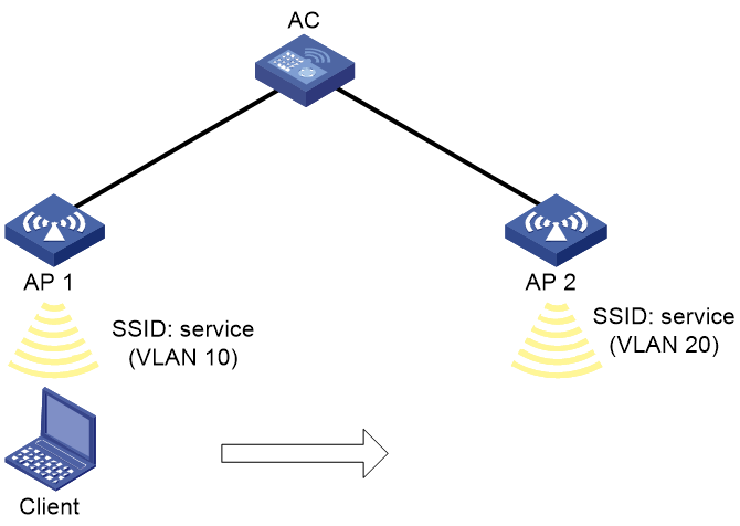

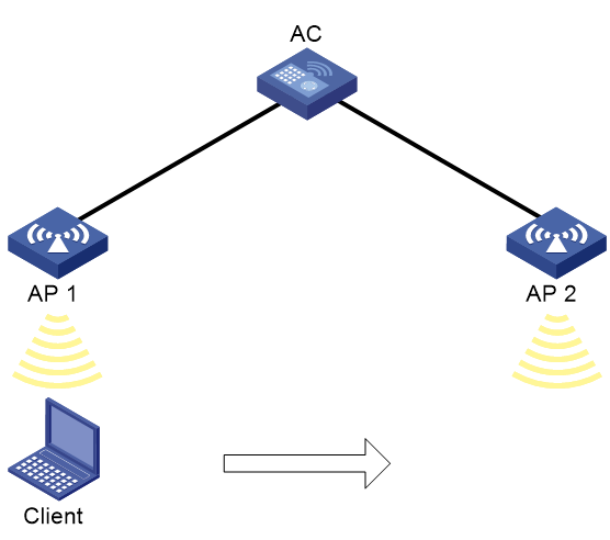

As shown in Figure 1, the client roams from AP 1 to AP 2 as follows:
1.     The client comes online from AP 1, and the AC creates a roaming entry for the client.
The entry records the initial SSID at association, PMKID, authentication method, security mode, and roaming VLAN.
2.     The client roams to AP 2. The AC examines the roaming entry.
3.     The client performs reauthentication and then comes online from AP 2.
Figure 1 WLAN roaming mechanism

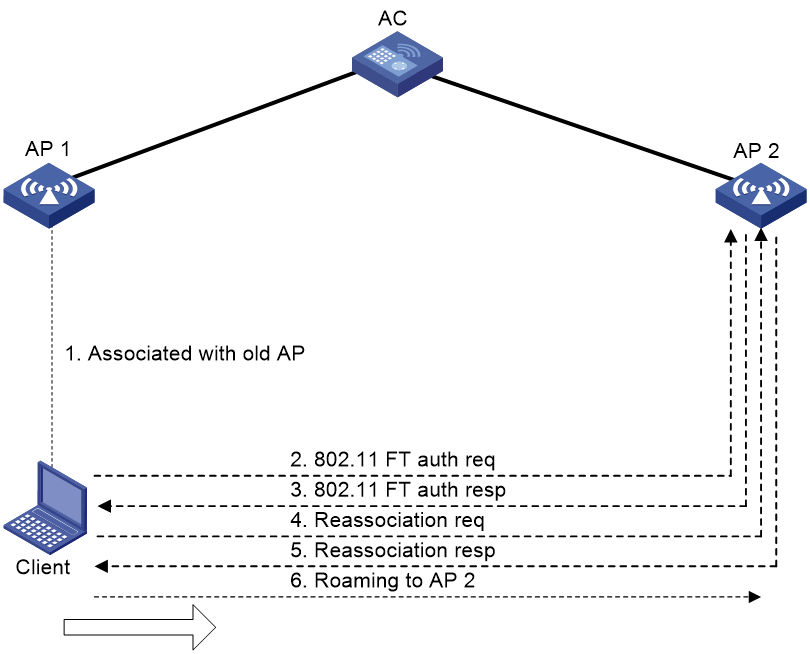

Layer 3 roaming
As shown in Figure 2, the client can roam between APs in different VLANs without special configuration. For the roaming procedure, see "WLAN roaming mechanism."
Figure 2 Layer 3 roaming

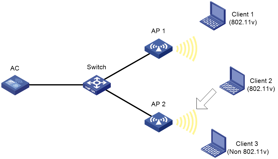

Example: Configuring WLAN roaming

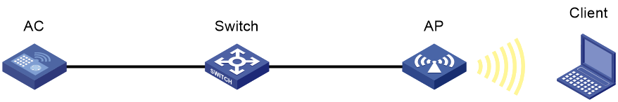

As shown in Figure 3, configure WLAN roaming to enable the client to roam from AP 1 to AP 2. The two APs are managed by the same AC.
Figure 3 Network diagram

802.1X fast roaming
802.1X fast roaming mechanism
As shown in Figure 4, 802.1X fast roaming operates as follows:
1.     The client comes online from AP 1 after passing RSN+802.1X authentication. AP 1 creates a roaming entry for the client.
For more information about 802.1X authentication, see User Access and Authentication Configuration Guide.
2.     The client roams to AP 2. The AP examines the roaming entry for the client and triggers 802.1X fast forwarding if the client carries the same PMKID as the AP.
The system uses the cached PMK to perform key negotiation and the client can associate with AP 2 without reauthentication.
The system supports using the following methods to cache PMKID:
·     Sticky Key Caching (SKC)—Directly caches the PMKIDs generated during 802.1X authentication of clients.
·     Opportunistic Key Caching (OKC)—Uses the currently associated BSSID, client MAC address, and cached PMK to generate a PMKID.
Both methods support 802.1X fast roaming without manual intervention.
Figure 4 802.1X fast roaming

As shown in Figure 4, MAC fast roaming operates as follows:
1.     The client comes online from AP 1 after passing MAC authentication. AP 1 creates a roaming entry for the client.
For more information about MAC authentication, see User Access and Authentication Configuration Guide.
2.     The client roams to AP 2. AP 2 examines the roaming entry for the client and triggers MAC authentication if fast-connect is enabled.
The client comes online from AP 2 without being reauthenticated.
Figure 5 MAC fast roaming

Intra-AC roaming through over-the-air FT
As shown in Figure 6, the client is associated with AP 1. Intra-AC roaming through over-the-air FT uses the following process:
1.     The client sends an FT authentication request to AP 2.
2.     AP 2 sends an FT authentication response to the client.
3.     The client sends a reassociation request to AP 2.
4.     AP 2 sends a reassociation response to the client.
5.     The client roams to AP 2.
Figure 6 Intra-AC roaming through over-the-air FT

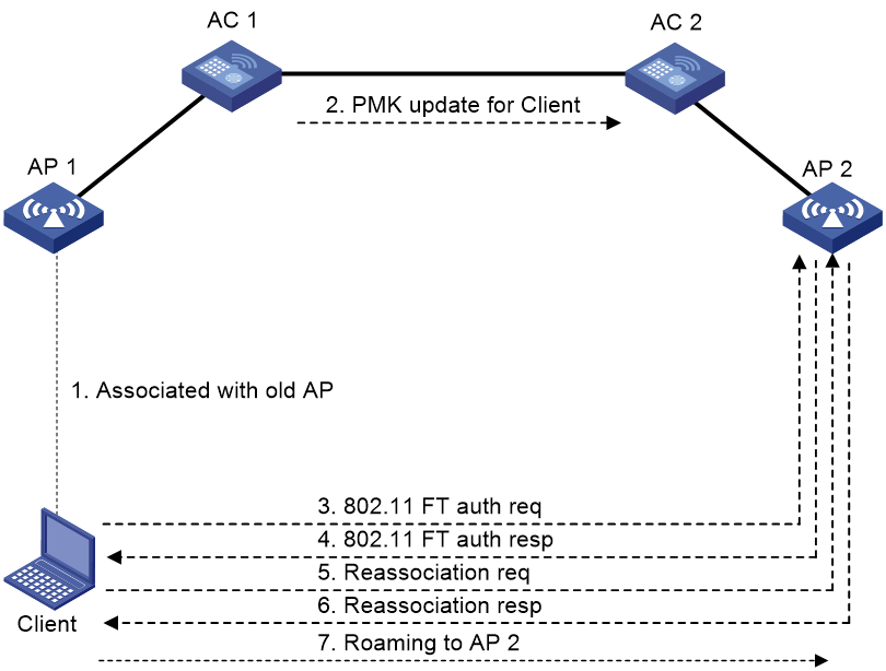

Inter-AC roaming through over-the-air FT
As shown in Figure 6, AP 1 and AP 2 are connected to AC 1 and AC 2, respectively. Inter-AC roaming through over-the-air FT uses the following process:
1.     The client associates with AP 1.
2.     AC 1 synchronizes client roaming information such as PMK and VLAN to AC 2.
3.     The client sends an FT authentication request to AP 2.
4.     AP 2 sends an FT authentication response to the client.
5.     The client sends a reassociation request to AP 2.
6.     AP 2 sends a reassociation response to the client.
7.     The client roams to AP 2.
Figure 7 Inter-AC roaming through over-the-air FT

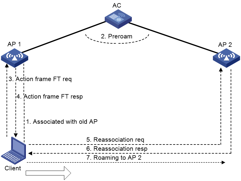

Intra-AC roaming over-the-DS FT
As shown in Figure 8, the client is associated with AP 1. Intra-AC roaming through over-the-DS FT uses the following process:
1.     After the client comes online, the AC creates a roaming entry and saves it for the client.
2.     The client sends an FT authentication request to AP 1.
3.     AP 1 sends an FT authentication response to the client.
4.     The client sends a reassociation request to AP 2.
5.     AP 2 sends a reassociation response to the client.
6.     The client roams to AP 2.
Figure 8 Intra-AC roaming through over-the-DS FT

Example: Configuring over-the-DS FT (PSK authentication)
As shown in Figure 9, configure intra-AC roaming through over-the-DS FT to enable the client to roam between AP 1 and AP 2. Configure PSK as the authentication and key management mode.
Figure 9 Network diagram

Example: Configuring over-the-DS FT (802.1X authentication)
As shown in Figure 9, configure intra-AC roaming through over-the-DS FT to enable the client to roam between AP 1 and AP 2. Configure 802.1X as the authentication and key management mode.

802.11v
About 802.11v
802.11v defines BSS transition management (BTM), which enables clients to roam to the optimal AP if the signal strength of the current AP is low or if a better AP is discovered.
As shown in Figure 10, BTM operates as follows:
1.     If the RSSI of the currently associated AP is too low or the client discovered a better AP, the client sends a BTM query to the associated AP. Upon receiving the query, the AP responds with a BTM request.
A BTM request contains information about recommended BSSs.
2.     Upon receiving the BTM request, the client determines whether to disconnect from the current AP and roam to a recommended AP.
3.     If the client determines to perform a roaming, it sends a BTM response to the AP. If the client fails to leave the current BSS before the disassociation timer expires, the AP sends a disassociation request to the client and logs off the client.

Example: Configuring 802.11v
As shown in Figure 11, configure 802.11v for the AP to guide the client to an optimal AP.
Figure 11 Network diagram
# Create service template service.
<AC> system-view
[AC] wlan service-template service
# Set the SSID to service.
[AC-wlan-st-service] ssid service
# Enable BTM.
[AC-wlan-st-service] bss transition-management enable
# Specify the BTM disassociation timeout as 45 seconds.
[AC-wlan-st-service] bss transition-management disassociation recommended timer 45
# Enable the service template.
[AC-wlan-st-service] service-template enable
[AC-wlan-st-service] quit
# Create AP ap1, specify the AP model and serial ID, enable the AP to obtain BSS candidate information, and bind service template service to radio 1 of AP ap1.
[AC] wlan ap ap1 model WA6320
[AC-wlan-ap-ap1] serial-id 219801A28N819CE0002T
[AC-wlan-ap-ap1] radio 1
[AC-wlan-ap-ap1-radio-1] sacp roam-optimize bss-candidate-list enable
[AC-wlan-ap-ap1-radio-1] service-template service
[AC-wlan-ap-ap1-radio-1] radio enable
[AC-wlan-ap-ap1-radio-1] quit
[AC-wlan-ap-ap1] quit
# Verify that BTM has been enabled.
[AC] display wlan service-template service verbose
Service template name                           : service
 Description                                     : Not configured
 SSID                                            : service
 SSID-hide                                       : Disabled
 User-isolation                                  : Disabled
 Service template status                         : Disabled
 Maximum clients per BSS                         : Not configured
 Frame format                                    : Dot3
 Seamless roam status                            : Disabled
 Seamless roam RSSI threshold                    : 50
 Seamless roam RSSI gap                          : 20
 VLAN ID                                         : 1
 Service VLAN ID                                 : N/A
 Service VLAN TPID                               : dot1q
 AKM mode                                        : Not configured
 Security IE                                     : Not configured
 Cipher suite                                    : Not configured
 TKIP countermeasure time                        : 0 sec
 PTK lifetime                                    : 43200 sec
 PTK rekey                                       : Enabled
 GTK rekey                                       : Enabled
 GTK rekey method                                : Time-based
 GTK rekey time                                  : 86400 sec
 GTK rekey client-offline                        : Disabled
 WPA3 status                                     : Disabled
 PPSK                                            : Disabled
 PPSK Fail Permit                                : Enabled
 Enhance-open status                             : Disabled
 Enhanced-open transition-mode service-template  : N/A
 User authentication mode                        : Bypass
 Intrusion protection                            : Disabled
 Intrusion protection mode                       : Temporary-block
 Temporary block time                            : 180 sec
 Temporary service stop time                     : 20 sec
 Fail VLAN ID                                    : Not configured
 802.1X handshake                                : Disabled
 802.1X handshake secure                         : Disabled
 802.1X domain                                   : Not configured
 MAC-auth domain                                 : Not configured
 Max 802.1X users per BSS                        : 512
 Max MAC-auth users per BSS                      : 512
 802.1X re-authenticate                          : Disabled
 Authorization fail mode                         : Online
 Accounting fail mode                            : Online
 Authorization                                   : Permitted
 Key derivation                                  : SHA1
 PMF status                                      : Disabled
 Hotspot policy number                           : Not configured
 Forwarding policy status                        : Disabled
 Forwarding policy name                          : Not configured
 Forwarder                                       : AC
 FT status                                       : Disabled
 QoS trust                                       : Port
 QoS priority                                    : 0
 QoS U-APSD mode                                 : 1
 BTM status                                      : Enabled
# Verify that the client has come online.
<AC> display wlan client
Total number of clients: 3
MAC address    Username             AP name               R IP address      VLAN
4581-61ac-885a N/A                  ap1                   1 192.168.66.230  1
# Verify that the client has been logged off 45 seconds after the AP recommends an optimal AP for the client. (Details not shown.)
Virtual BSS roaming
About virtual BSS roaming
Virtual BSS roaming enables multiple APs to provide the same virtual service for a client without service interruption when the client roams between the APs. When a client comes online from one AP, the other APs monitor the RSSI of the client. The AC switches the wireless service to a new AP if the AC detects that the new AP can provide higher-quality services.
As shown in Figure 12, virtual BSS roaming operates as follows:
1.     The AC generates a virtual service for the client when AP 1 or AP 2 receives a probe request from the client.
The BSSID of the virtual service contains the bridge MAC address of the AC, the AP's ID, and the client MAC address. The AP uses this virtual BSSID to communicate with the client.
2.     The AC notifies AP 2 of the virtual BSSID of AP 1 if the client comes online from AP 1. AP 2 replaces its local virtual BSSID with AP 1's virtual BSSID and monitors the RSSI of the client.
3.     The AC notifies AP 2 to provide wireless services to the client when the following conditions are met:
¡     The RSSI of the client frames received by AP 2 reaches or exceeds the specified RSSI threshold.
¡     The gap between the RSSIs of the client frames that AP 2 and AP 1 have received reaches or exceeds the RSSI gap threshold.
Figure 12 Virtual BSS roaming diagram

Example: Configuring cooperative roaming
As shown in Figure 11, most clients in the network support 802.11k and 802.11v. Configure cooperative roaming for clients to roam in the ESS seamlessly.
Figure 13 Network diagram
If most clients in the network do not support 802.11k or 802.11v, you can configure BTM, BTM disassociation, anti-sticky, and advanced data transmission holding for clients to perform seamless roaming.
# Configure interface IP addresses and route settings. Make sure the devices can reach each other. (Details not shown.)

Mobility group mechanism
A mobility group enables clients to roam among APs that are managed by different ACs. These ACs must be in the same mobility group and have established an IADTP tunnel with each other.
Figure 14 Mobility group mechanism
As shown in Figure 14, inter-AC roaming uses the following procedure:
1.     The client comes online from AP 2. AC 1 creates a roaming entry for the client and sends the information to AC 2 through the IADTP tunnel.
2.     The client roams to AP 3. AC 2 examines the roaming entry for the client and determines whether to perform fast roaming.
If the client uses RSN + 802.1X authentication and carries the same PMKID as the AC, fast roaming is used, and the client can associate with AP 3 without reauthentication If it is not, the client must be reauthenticated before associating with AP 3.
3.     The client associates with AP 3. AC 2 sends a roaming request to AC 1.
4.     AC 1 verifies the roaming request and performs either of the following operations:
¡     Sends a roaming response that indicates roaming failure to AC 2 if the request is invalid. AC 2 logs off the client.
¡     Saves the roaming trace and roam-out information and sends a roaming response that indicates roaming success to AC 2 if the request is valid. AC 2 saves roaming-in information for the client.

Example: Configuring a mobility group
As shown in Figure 16, configure a mobility group to enable the client to roam from AP 2 to AP 3 that are managed by different ACs.
Figure 16 Network diagram
1.     Configure AC 1:
# Create a service template named service, set the SSID to office, and enable the service template.
<AC1> system-view
[AC1] wlan service-template service
[AC1-wlan-st-test] ssid office
[AC1-wlan-st-test] service-template enable
[AC1-wlan-st-test] quit
# Create a manual AP named ap1, and specify the AP model and serial ID.
[AC1] wlan ap ap1 model WA6320
[AC1-wlan-ap-ap1] serial-id 219801A28N819CE0002T
# Bind the service template to radio 1 of AP 1.
[AC1-wlan-ap-ap1] radio 1
[AC1-wlan-ap-ap1-radio-1] radio enable
[AC1-wlan-ap-ap1-radio-1] service-template service
[AC1-wlan-ap-ap1-radio-1] quit
[AC1-wlan-ap-ap1] quit
# Create a manual AP named ap2, and specify the AP model and serial ID.
[AC1] wlan ap ap2 model WA6320
[AC1-wlan-ap-ap2] serial-id 219801A28N819CE0003T
# Bind the service template to radio 1 of AP 2.
[AC1-wlan-ap-ap2] radio 1
[AC1-wlan-ap-ap2-radio-1] radio enable
[AC1-wlan-ap-ap2-radio-1] service-template service
[AC1-wlan-ap-ap2-radio-1] quit
[AC1-wlan-ap-ap2] quit
# Create a mobility group named office.
[AC1] wlan mobility group office
# Specify the IP address type for IADTP tunnels as IPv4.
[AC1-wlan-mg-office] tunnel-type ipv4
# Specify the source IP address for establishing IADTP tunnels as 10.1.4.22.
[AC1-wlan-mg-office] source ip 10.1.4.22
# Add AC 2 to the mobility group.
[AC1-wlan-mg-office] member ip 10.1.4.23
# Enable the mobility group.
[AC1-wlan-mg-office] group enable
[AC1-wlan-mg-office] quit
2.     Configure AC 2:
# Create a service template named service, specify the SSID as office, and enable the service template.
<AC2> system-view
[AC2] wlan service-template service
[AC2-wlan-st-service] ssid office
[AC2-wlan-st-service] service-template enable
[AC2-wlan-st-service] quit
# Create a manual AP named ap3, and specify the AP model and serial ID.
[AC2] wlan ap ap3 model WA6320
[AC2-wlan-ap-ap3] serial-id 219801A28N819CE0004T
# Bind the service template to radio 1 of AP 3.
[AC2-wlan-ap-ap3] radio 1
[AC2-wlan-ap-ap3-radio-1] radio enable
[AC2-wlan-ap-ap3-radio-1] service-template service
[AC2-wlan-ap-ap3-radio-1] quit
[AC2-wlan-ap-ap3] quit
# Create a manual AP named ap4, and specify the AP model and serial ID.
[AC2] wlan ap ap4 model WA6320
[AC2-wlan-ap-ap4] serial-id 219801A28N819CE0005T
# Bind the service template to radio 1 of AP 4.
[AC2-wlan-ap-ap4] radio 1
[AC2-wlan-ap-ap4-radio-1] radio enable
[AC2-wlan-ap-ap4-radio-1] service-template service
[AC2-wlan-ap-ap4-radio-1] quit
[AC2-wlan-ap-ap4] quit
[AC2] wlan mobility group office
[AC2-wlan-mg-office] tunnel-type ipv4
# Specify the source IP address for establishing IADTP tunnels as 10.1.4.23.
[AC2-wlan-mg-office] source ip 10.1.4.23
[AC2-wlan-mg-office] member ip 10.1.4.22
[AC2-wlan-mg-office] group enable
[AC2-wlan-mg-office] quit
# Verify that a mobility group has been created on AC 1.
[AC1] display wlan mobility group
Mobility group name: office
 Tunnel type: IPv4
 Source IPv4: 10.1.4.22
 Source IPv6: Not configured
 Authentication method: Not configured
 Mobility group status: Enabled
 Member entries: 1
 IP address                              State          Online time
 10.1.4.23                               Up             00hr 00min 12sec
# Verify that a mobility group has been created on AC 2.
[AC2] display wlan mobility group
 Tunnel type: IPv4
 Source IPv4: 10.1.4.23
 Member entries: 1
 10.1.4.22                               Up             00hr 00min 05sec
# Get the client online on AP 2 and then make the client roam to AP 3. (Details not shown.)
# Display client roaming information on AC 1 to verify that the client has come online from AP 2 and roamed to AP 3.
[AC1] display wlan mobility roam-track mac-address 9cd3-6d9e-6778
Total entries  : 2
Current entries: 2
BSSID           Created at           Online time       AC IP address  RID  AP name
000f-e203-8889  2016-06-14 11:12:28  00hr 06min 56sec  10.1.4.23      1    ap3
000f-e203-7777  2016-06-14 11:11:28  00hr 03min 30sec  127.0.0.1      1    ap2
# On AC 1, verify that the client has roamed to AC 2.
<AC1> display wlan mobility roam-out
Total entries: 1
MAC address     BSSID           VLAN ID  Online time       FA IP address
9cd3-6d9e-6778  000f-e203-8889  1        00hr 01min 59sec  10.1.4.23
# On AC 2, verify that the client has associated with AP 3, and the roaming status is Inter-AC roam.
<AC2> display wlan client verbose
Total number of clients: 1
MAC address                        : 9cd3-6d9e-6778
IPv4 address                       : 10.1.1.114
IPv6 address                       : N/A
Username                           : N/A
AID                                : 1
AP ID                              : 3
AP name                            : ap3
Radio ID                           : 1
SSID                               : 1
BSSID                              : 000f-e203-8889
VLAN ID                            : 1
VLAN ID2                           : N/A
Sleep count                        : 242
Wireless mode                      : 802.11ac
Channel bandwidth                  : 80MHz
SM power save                      : Enabled
SM power save mode                 : Dynamic
Short GI for 20MHz                 : Supported
Short GI for 40MHz                 : Supported
Short GI for 80MHz                 : Supported
Short GI for 160/80+80MHz          : Not supported
STBC RX capability                 : Not supported
STBC TX capability                 : Not supported
LDPC RX capability                 : Not supported
SU beamformee capability           : Not supported
MU beamformee capability           : Not supported
Beamformee STS capability          : N/A
Block Ack                          : TID 0 In
Supported VHT-MCS set              : NSS1 0, 1, 2, 3, 4, 5, 6, 7, 8
                                     NSS2 0, 1, 2, 3, 4, 5, 6, 7, 8
Supported HT MCS set               : 0, 1, 2, 3, 4, 5, 6, 7,
                                     8, 9, 10, 11, 12, 13, 14,
                                     15, 16, 17, 18, 19, 20,
                                     21, 22, 23
Supported rates                    : 6, 9, 12, 18, 24, 36,
                                     48, 54 Mbps
QoS mode                           : WMM
Listen interval                    : 10
RSSI                               : 62
Rx/Tx rate                         : 130/11
Authentication method              : Open system
Security mode                      : PRE-RSNA
Cipher suite                       : N/A
Authorization ACL ID               : 3001(Not effective)
Authorization user profile         : N/A
Roam status                        : Inter-AC roam
PMF status                         : Enabled
Forward policy name                : Not configured
Online time                        : 0days 0hours 5minutes 13seconds
FT status                          : Inactive
# Verify that the client has roamed from AC 1 to AC 2.
<AC2> display wlan mobility roam-in
Total entries: 1
MAC address     BSSID           VLAN ID  HA IP address
9cd3-6d9e-6778  000f-e203-8889  1        10.1.4.22
