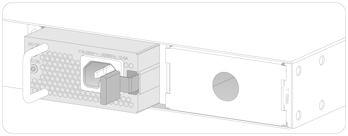

Power module filler panel
1, provided
S5570S-28S-EI
S5570S-54S-EI
S5570S-36F-EI
S5570S-54F-EI

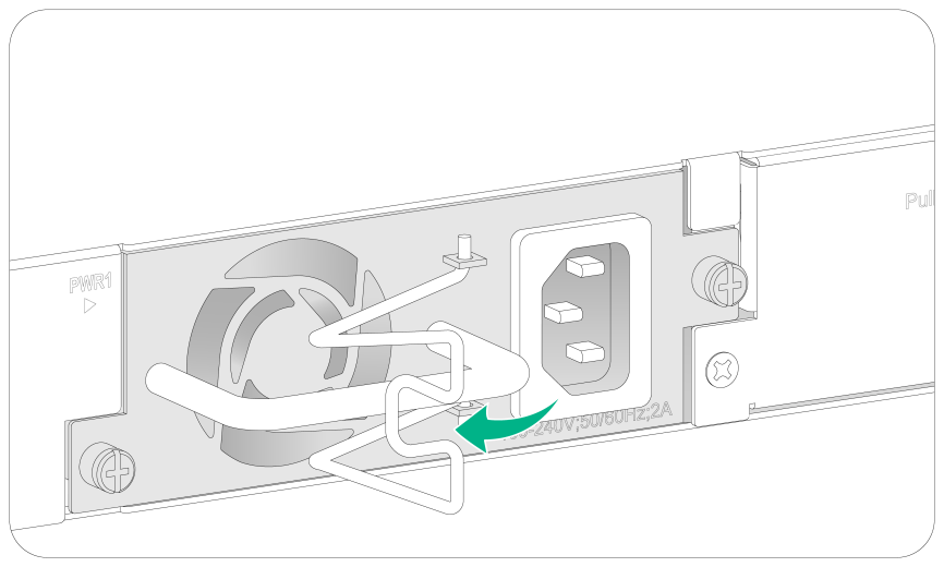

AC power cord bail latch
The appearance of the bail latch might differ.
1, provided with the CA-70A12 and PSR75-12A power supplies

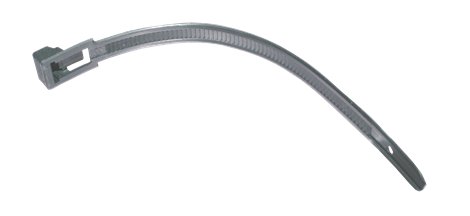

Releasable cable tie
1, provided with the PSR180-56A, PSR360-56A, PSR720-56A, PSR1110-56A, PSR600-54A-B, PSR920-54A-B, and PSR1600-54A-B power supplies

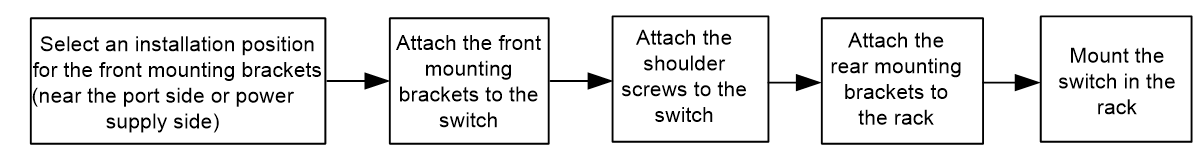

Installation procedure at a glance
Figure 2 Procedure for installing the switch in a 19-inch rack by using front mounting brackets
Figure 3 Procedure for installing the switch in a 19-inch rack by using front and rear mounting brackets
If a rack shelf is available, you can put the switch on the rack shelf, slide the switch to an appropriate location, and attach the switch to the rack by using the mounting brackets.

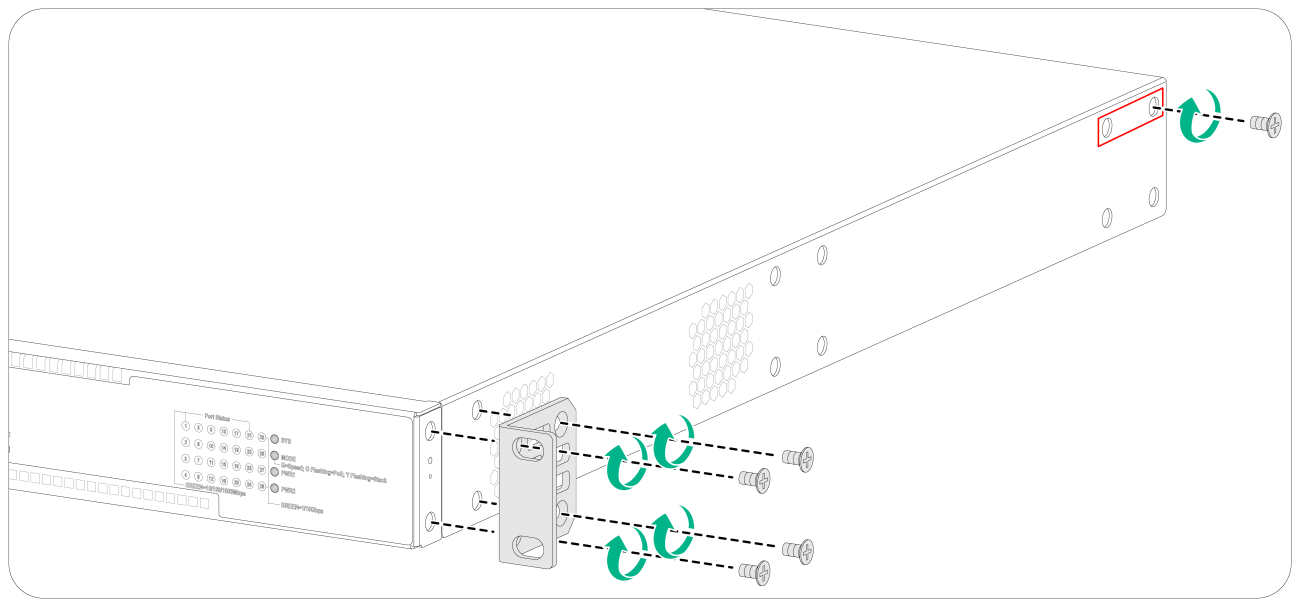

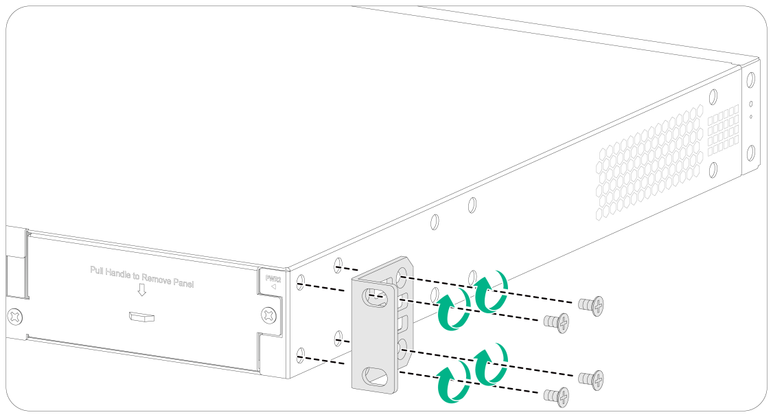

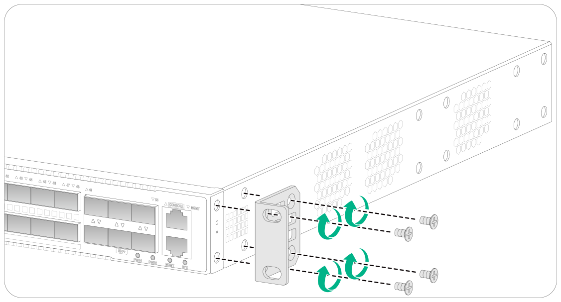

Attaching the front mounting brackets to the switch
For the S5170-28S-EI, S5170-54S-EI, S5170-36F-EI, and S5170-36F-EI-DP switches, you can install front mounting brackets only at the port side.
The switch has one mounting position near the network ports and the other mounting position near the power supplies for the front mounting brackets. Select one position as needed.
To attach the front mounting brackets to the chassis:
1.     Place the wide flange of the mounting bracket against the chassis side panel. Align the mounting bracket installation holes with the screw holes in the chassis.
¡     To install the mounting brackets at the port-side mounting position, see Figure 4.
¡     To install the mounting brackets at the power supply-side mounting position, see Figure 5.
2.     Fasten the M4 screws to secure the mounting bracket to the switch. As a best practice, use a torque of 12 kgf-cm (1.18 Nm) to fasten the M4 screws.
3.     Attach the front mounting bracket to the other side of the chassis in the same way.
Figure 4 Attaching the front mounting brackets to the port-side mounting position
Figure 5 Attaching the front mounting brackets to the power supply-side mounting position

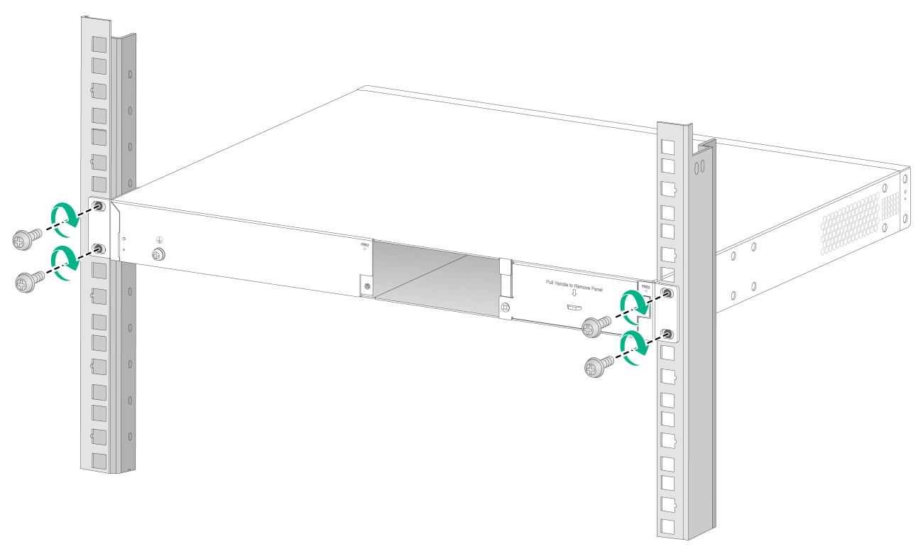

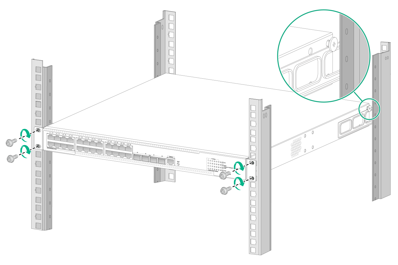

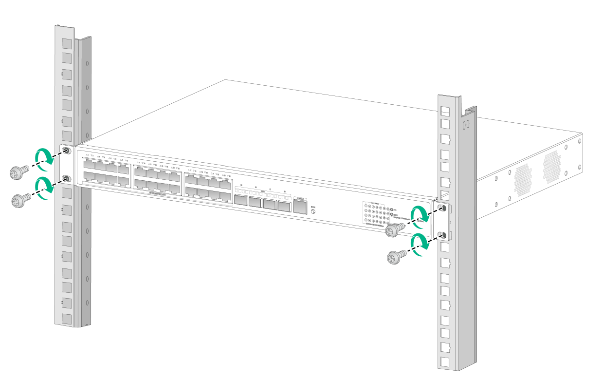

Mounting the switch in the rack
This task requires two people.
To mount the switch in the rack:
1.     Wear an ESD wrist strap and make sure it makes good skin contact and is reliably grounded.
2.     Verify that the front mounting brackets have been securely attached to the switch chassis. See "Attaching the front mounting brackets to the switch."
3.     Attach cage nuts to the front rack posts.
4.     One person supports the bottom of the switch, and moves the switch to an appropriate position based on the installation positions of the front mounting brackets.
5.     Another person uses user supplied M6 screws and cage nuts to attach the mounting brackets to the rack and verifies that the brackets are level and secure. As a best practice, use a torque of 30 kgf-cm (2.94 Nm) to fasten the M6 screws.
Figure 6 Mounting the switch in the rack (port-side mounting position for the front mounting brackets)
Figure 7 Mounting the switch in the rack (power supply-side mounting position for the front mounting brackets)

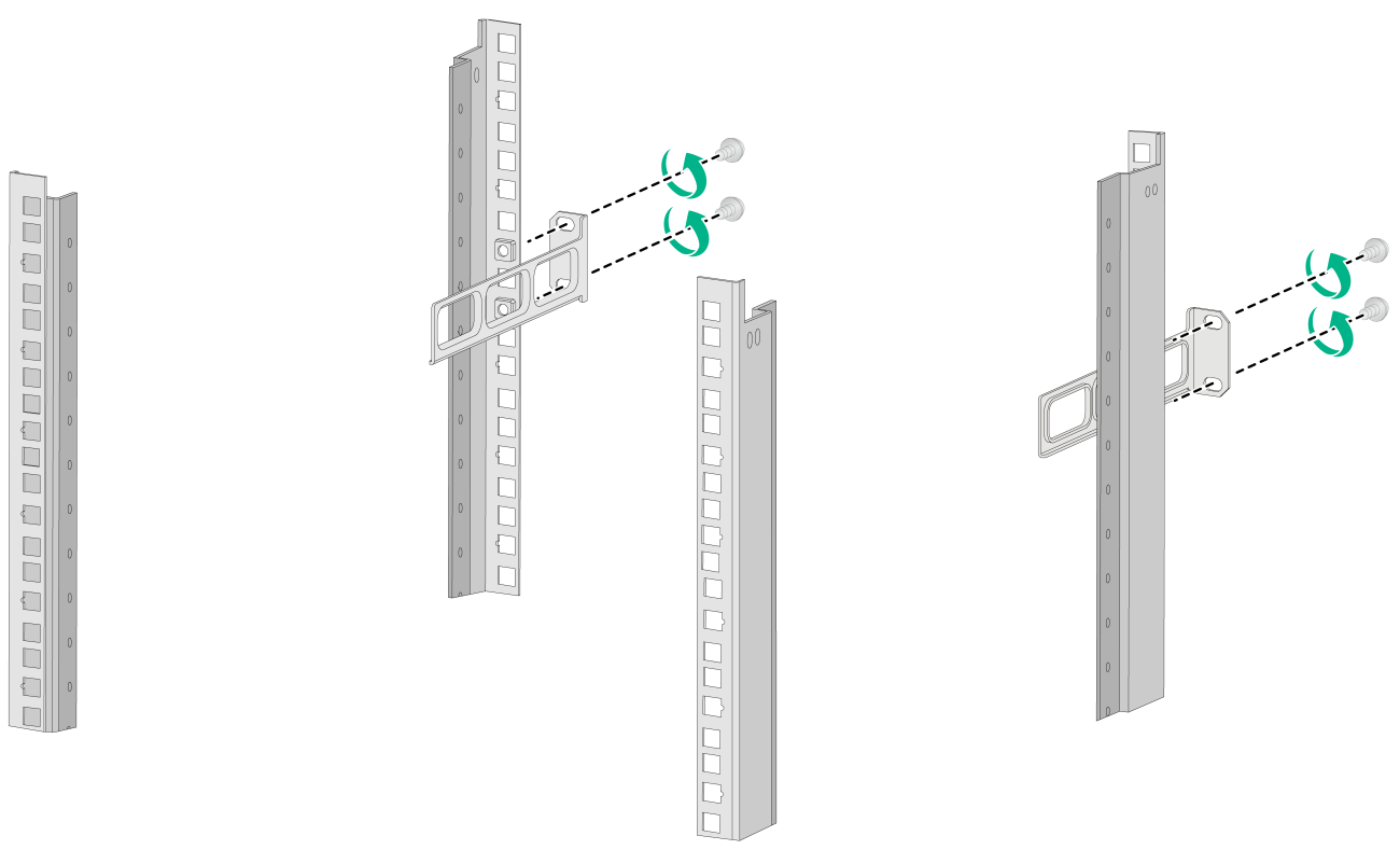

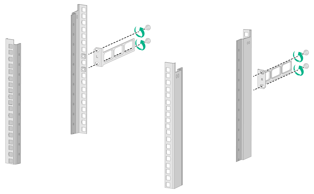

Attaching the rear mounting brackets to the rack
1.     Determine the switch installation position in the rack.
2.     Install cage nuts (user-supplied) in the rear rack posts. Make sure the corresponding cage nuts on the left and right rear rack posts are at the same height.
3.     Orient the rear mounting brackets with the wide flange inside or outside the rack as required.
4.     Use M6 screws (user-supplied) to attach the rear mounting brackets to the rear posts, as shown in Figure 9. As a best practice, use a torque of 30 kgf-cm (2.94 Nm) to fasten the M6 screws.
Do not fully tighten the M6 screws before mounting the switch in the rack.
Figure 9 Attaching the rear mounting brackets to the rack with the wide flange inside the rack
Figure 10 Attaching the rear mounting brackets to the rack with the wide flange outside the rack

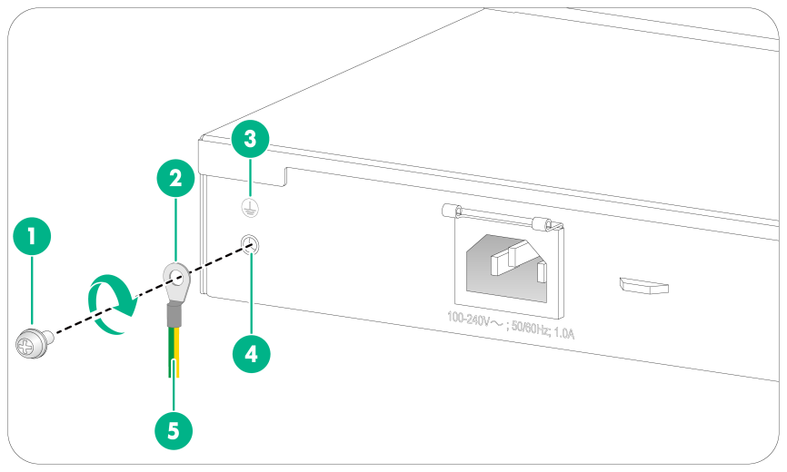

Connecting the grounding cable to the chassis
1.     Remove the grounding screw from the grounding hole in the chassis.
2.     Use the grounding screw to attach the ring terminal of the grounding cable to the grounding screw hole. Fasten the screw. As a best practice, use a torque of 5 kgf-cm (0.49 Nm) to fasten the grounding screw.
IMPORTANT
IMPORTANT:
Orient the grounding cable as shown in Figure 13 so that you can easily install or remove the removable components.
Figure 13 Connecting the grounding cable to the chassis
(1) Grounding screw
(2) Ring terminal
(3) Grounding sign
(4) Grounding hole
(5) Grounding cable

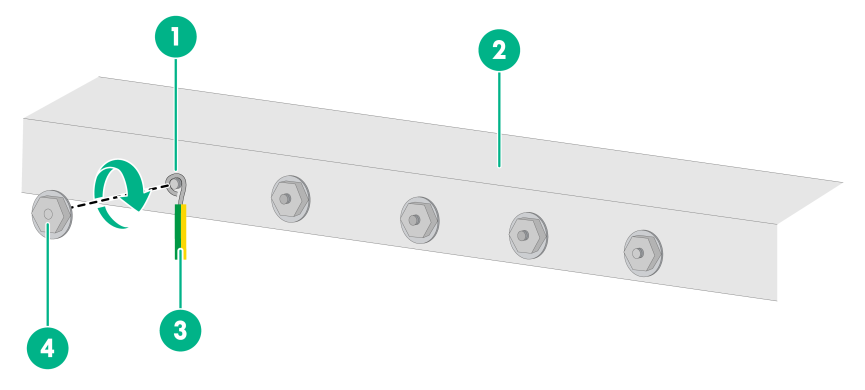

Connecting the grounding cable to a grounding strip
1.     Use needle-nose pliers to bend the bare metal part to the shape as shown in Figure 14. Make sure the bended part can securely attached to the grounding post on the grounding strip.
2.     Attach the bended part of the grounding cable to the grounding post and use the hex nut to fasten the bended part to the post.
Figure 14 Connecting the grounding cable to a grounding strip
(1) Grounding post
(2) Grounding strip
(3) Grounding cable
(4) Hex nut

a.     Use a multimeter to measure the resistance between the switch grounding terminal and grounding point, and make sure the resistance is less than 0.1W.
b.     Use a grounding resistance tester to measure the grounding resistance of the angle iron in the ground, and make sure the grounding resistance is less than 10W. For locations with high soil resistivity, sprinkle some resistance reducer to reduce soil resistivity or replace soil around the grounding strip with soil with lower resistance.
For information about resistance measurement, see H3C Network Devices Lightning Protection Guide.

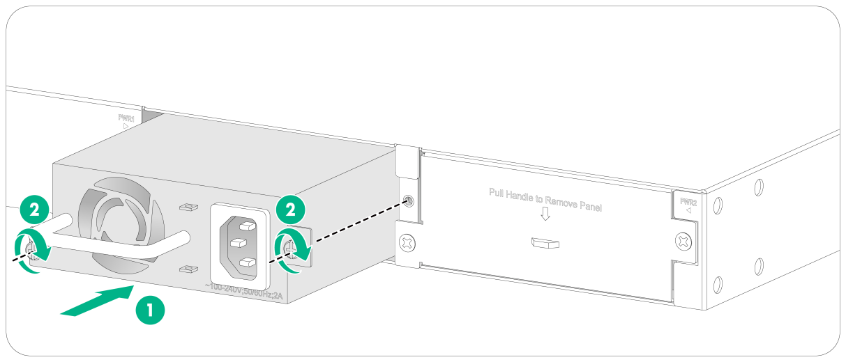

Installing/removing a power supply (1)
This section applies to the CA-70A12, PSR75-12A, and PSR150-D1 power supplies, which use a similar installation/removal procedure. A PSR75-12A power supply is used as an example.
Installing a power supply
2.     Remove the filler panel from the target power supply slot as follows:
a.     Remove the screws from the filler panel.
b.     Use a flathead screwdriver to remove the filler panel.
Figure 18 Removing the filler panel
3.     Unpack the power supply and verify that the power supply model is correct.
4.     Correctly orient the power supply with the power supply slot (use the letters on the power supply faceplate for orientation), grasp the handle of the power supply with one hand and support its bottom with the other, and slide the power supply slowly along the guide rails into the slot (see callout 1 in Figure 19).
5.     Fasten the captive screws on the power supply with a Phillips screwdriver to secure the power supply in the chassis (see callout 2 in Figure 19). If the captive screw cannot be tightly fastened, verify the installation of the power supply.
As a best practice, use a torque of 5 kgf-cm (0.49 Nm) to fasten the captive screws.
6.     Install the filler panel over the empty power supply slot to prevent dust and ensure good ventilation if you install only one power supply.
Figure 19 Installing a power supply

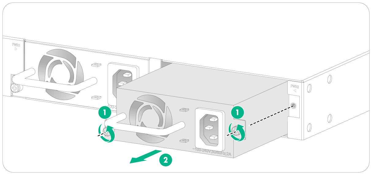

Removing a power supply
2.     Disconnect the power cord.
3.     Loosen the captive screws on the power supply with a Phillips screwdriver until they are completely disengaged.
4.     Grasp the handle of the power supply with one hand and pull it out a little, support the bottom with the other hand, and pull the power supply slowly along the guide rails out of the slot.
Put away the removed power supply in an antistatic bag or the power supply package bag for future use.
Figure 20 Removing a power supply

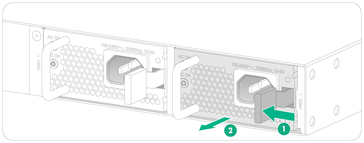

3.     Press the latch towards the handle, and pull the power supply along the guide rails until it is part-way out.
4.     Grasp the handle of the power supply with one hand, support the bottom with the other hand, and pull the power supply slowly along the guide rails out of the slot.
Keep the removed power supply in an antistatic bag or the power supply package bag for future use.
5.     Install the filler panel to prevent dust and ensure good ventilation if no power supply is installed in the slot.
Figure 24 Removing the power supply

Connecting the power cord for a built-in power supply

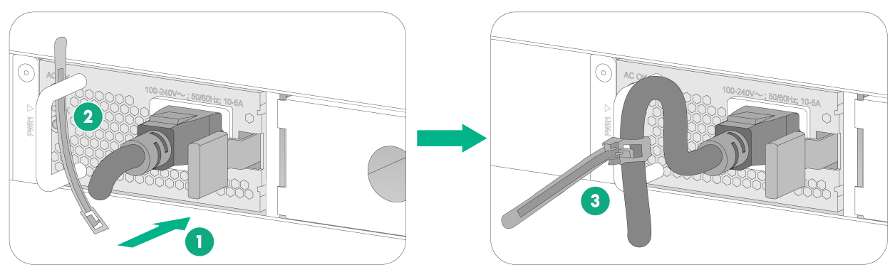

1.     Wear an ESD wrist strap. Make sure the strap makes good skin contact and is reliably grounded.
2.     Plug the female connector of the power cord into the power receptacle on the power supply, as shown in Figure 25.
3.     Use a cable tie to secure the power cord to the handle of the power supply, as shown in Figure 25.
4.     Connect the other end of the power cord to an AC power source.
Figure 25 Connecting the power cord for a built-in power supply(1)
Figure 26 Connecting the power cord for a built-in power supply(2)
Connecting the power cord for a CA-70A12 or PSR75-12A power supply
The power cord connection procedure is similar for the CA-70A12 and PSR75-12A power supplies. The following procedure connects the power cord for a PSR75-12A power supply.
To connect the power cord for a PSR75-12A power supply:
2.     Attach the power cord retainer clip (supplied with the power supply) into the two holes next to the AC-input power receptacle on the power supply, and pull the retainer clip leftwards (see Figure 27).
3.     Connect the female connector of the AC power cord supplied with the power supply to the power receptacle (see callout 1 in Figure 28).
4.     Pull the retainer clip rightwards to secure the connector to the AC-input power receptacle (see callout 2 in Figure 28).
5.     Connect the other end of the power cord to an AC power source.
Figure 27 Connecting a power cord (1)
Figure 28 Connecting a power cord (2)

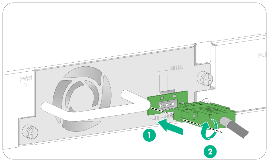

Connecting the power cord for a PSR150-D1 or PSR560-56D power supply
CAUTION
CAUTION:
·     Connect the other ends of the wires for a PSR150-D1 power supply to a –48 VDC power source, with the negative wire ( or L–) to the negative terminal () and the positive wire (+ or M/N) to the positive terminal (+).
·     To use a –48 VDC power source to supply power to the power supply, use the DC power cord supplied with the power supply.
·     To use an H3C RPS (–54 VDC) to supply power to the power supply, use a compatible RPS power cord to connect the RPS to the power supply.
·     The power cord color code scheme in Figure 29 is for illustration only. The cable delivered for your country or region might use a different color scheme. When you connect the power cord, always identify the polarity symbol on its wires.
The power cord connection procedure is the same for the PSR150-D1 and PSR560-56D power supplies. The following procedure uses a PSR150-D1 power supply as an example.
To connect the power cord for a PSR150-D1 power supply:
2.     Unpack the power cord, correctly orient the plug at one end of the cable with the power receptacle on the power supply, and insert the plug into the power receptacle (see callout 1 in Figure 29).
The power receptacle is foolproof. If you cannot insert the plug into the receptacle, re-orient the plug rather than use excessive force to push it in.
3.     Tighten the screws on the plug with a flat-blade screwdriver to secure the plug in the power receptacle (see callout 2 in Figure 29).
4.     Connect the two wires at the other end of the power cord to a –48 VDC power source or an RPS.
Figure 29 Connecting the power cord for a PSR150-D1 power supply

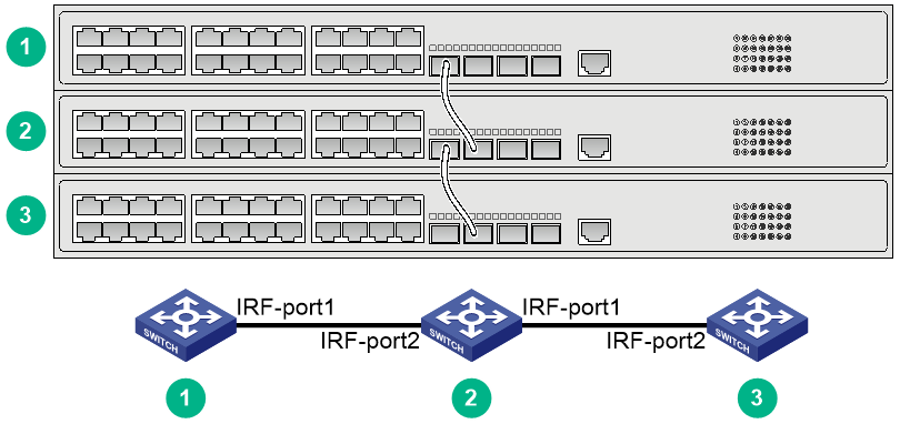

Figure 36 and Figure 37 show the topologies of an IRF fabric made up of three S5170-28S-EI switches. The IRF port connections in the two figures are for illustration only, and more connection methods are available.
Figure 36 IRF fabric in daisy chain topology
Figure 37 IRF fabric in ring topology

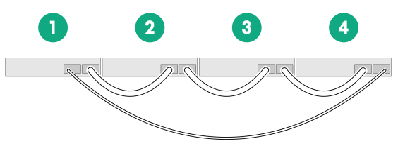

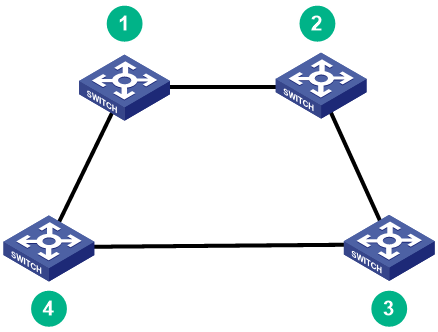

Connecting the IRF member switches in one rack

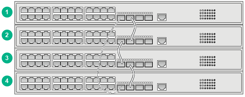

Connect the IRF member switches (4 switches in this example) in a rack as shown in Figure 38. The switches in the ring topology (see Figure 39) are in the same order as connected in the rack.
Figure 38 Connecting the switches in one rack
Figure 39 IRF fabric topology
