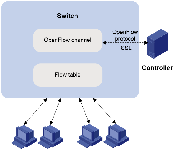

OpenFlow is the communications interface defined between the control and forwarding layers of a Software-Defined Networking architecture. With OpenFlow, you can perform centralized data forwarding management for physical and virtual devices through controllers.
OpenFlow network components
OpenFlow separates the data forwarding and routing decision functions. It keeps the flow-based forwarding function and employs a separate controller to make routing decisions. An OpenFlow switch communicates with the controller through an OpenFlow channel. An OpenFlow channel can be encrypted by using TLS or run directly over TCP. An OpenFlow switch exchanges control messages with the controller through an OpenFlow channel to perform the following operations:
·     Receive flow table entries or data from the controller.
·     Report information to the controller.
Unless otherwise stated, a switch refers to an OpenFlow switch throughout this document.
Figure 1 OpenFlow network diagram
OpenFlow switch
OpenFlow switches include the following types:
·     OpenFlow-only—Supports only OpenFlow operation.
·     OpenFlow-hybrid—Supports both OpenFlow operation and traditional Ethernet switching operation.

Configuring an OpenFlow instance to act as an SSL server to listen to controllers
About configuring SSL server for an OpenFlow instance
Typically, an OpenFlow instance actively connects to the controller acting as a TCP/SSL client. After the SSL server is enabled for an OpenFlow instance, the controller acts as the SSL client and actively connects to the OpenFlow instance. For more information about SSL, see Security Configuration Guide.
This feature can take effect without activation for an OpenFlow instance.
To re-configure the SSL server, first execute the undo form of the command to delete the existing SSL server configuration.
2.     Enter OpenFlow instance view.
openflow instance instance-id
3.     Configure an OpenFlow instance to act as an SSL server to listen to controllers.
listening port port-number ssl ssl-policy-name
By default, an OpenFlow instance is not configured to acts as an SSL server listen to controllers.

As shown in Figure 7, an OpenFlow switch communicates with the controller. Perform the following tasks on the OpenFlow switch:
·     Create OpenFlow instance 1, associate VLANs 4092 and 4094 with the OpenFlow instance, and activate the OpenFlow instance.
·     Configure the IP address for controller 1 to have the controller manage the OpenFlow switch.
Figure 7 Network diagram
