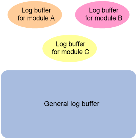

Outputting logs to the log buffer
This feature enables log output to log buffers based on the log source modules. As shown in Figure 2, log buffers include separate module-specific log buffers and the general log buffer.
Figure 2 Genratal log buffer and separate module-specific log buffers
·     Separate module-specific log buffers—Logs generated by modules that have separate log buffers are saved to their respective log buffers.
For example, logs generated by the CFGLOG module are saved to the CFGLOG log buffer. With separate buffers, you can manage and view the module-specific logs and general logs conveniently.
The modules that have separate log buffers are determined by factory settings. To view the names of supported modules, use the display logbuffer module ? command. You can use the display logbuffer module module-name command to view buffered logs of the specified module.
·     General log buffer—Logs generated by the system and the modules other than the modules that have separate log buffers are saved to the general log buffer.
You can use the display logbuffer command without the module keyword to view buffered logs in the general log buffer.

Setting the minimum storage period
About setting the minimum storage period
Use this feature to set the minimum storage period for logs in log buffers and log files. This feature ensures that logs will not be overwritten by new logs during a set period of time.
Logs of the modules that have separate log buffers and log files are output to their respective log buffers or log files. Logs of other modules and the system logs are output the general log buffer or log files.
For logs in the general log buffer or a module-specific log buffer/log file
By default, when the number of logs in a module-specific log buffer, a module-specific log file, or the general log buffer reaches the maximum, new logs will automatically overwrite the oldest logs. After the minimum storage period is set, the system identifies the storage period of a log to determine whether to delete the log. The system current time minus a log's generation time is the log's storage period.
·     If the storage period of a log is shorter than or equal to the minimum storage period, the system does not delete the log. The new log will not be saved.
·     If the storage period of a log is longer than the minimum storage period, the system deletes the log to save the new log.
For general log files
By default, when the last general log file is full, the device locates the oldest compressed general log file (logfileX.log.gz) and creates a new file by using the same name (logfileX.log). After the minimum storage period is set, the system identifies the storage period of the compressed log file before creating a new log file with the same name. The system current time minus the log file's last modification time is the log file's storage period.
·     If the storage period of the compressed log file is shorter than or equal to the minimum storage period, the system stops saving new logs.
·     If the storage period of the compressed log file is longer than the minimum storage period, the system creates a new file to save new logs.
