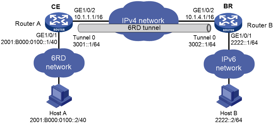

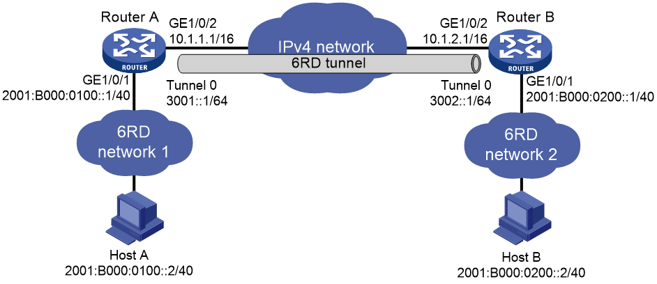

6RD tunneling
·     Ordinary 6RD tunneling
A 6RD tunnel is a point-to-multipoint automatic tunnel. It is an extension of 6to4 tunneling. The IPv6 prefix of a 6RD network is assigned by the service provider and is not limited to the prefix 2002::/16. 6RD does not require embedding all 32 bits of an IPv4 address in a 6RD address.
Figure 4 shows the format of 6RD address—an IPv6 address with a 6RD prefix and an embedded IPv4 address.
¡     6RD prefix—IPv6 prefix assigned by the service provider to a 6RD network.
¡     IPv4 address—All or part of the IPv4 tunnel source address in hexadecimal notation. For example, assume that the IPv4 tunnel source address is 1.2.3.4 and both the IPv4 prefix length and suffix length are specified as 8 bits. Then, the prefix of the IPv4 address 1.2.3.4 is 01, the suffix is 04, and the embedded IPv4 address is 0203.
¡     6RD delegated prefix—The 6RD prefix and the embedded IPv4 address together form a 6RD delegated prefix. It uniquely identifies a 6RD network (an IPv6 network where all hosts use 6RD addresses).
¡     Subnet ID—Identifies a subnet in the 6RD network.
¡     Interface ID—The subnet ID and the interface ID together identify a host in the 6RD network.
The device automatically identifies the tunnel destination IPv4 address according to the IPv4 address embedded in the 6RD address, the 6RD prefix, and the IPv4 prefix and suffix.
Figure 4 6RD address format
·     6RD relay
6 RD relay connects a 6RD network and an IPv6 network that uses a prefix other than a 6RD delegated prefix. A 6RD border relay (BR) router is a gateway that forwards packets from a 6RD network to an IPv6 network. The border router connected to the 6RD network is called 6RD CE.
As shown in Figure 5, for the 6RD network site 1 to communicate with the IPv6 network site 3 over a 6RD tunnel, you must configure 6RD relay. Configure a static route on the border router (Device A) in the 6RD network. The next hop address must be the 6RD address of the 6RD BR router (Device C). Device A forwards all packets destined for the IPv6 network over the 6RD tunnel, and Device C then forwards them to the IPv6 network.
Figure 5 Principle of 6RD tunneling and 6RD relay

Example: Configuring a 6RD tunnel
As shown in Figure 11, Host A and Host B are in different 6RD networks. Configure a 6RD tunnel between Router A and Router B so Host A and Host B can reach each other over the IPv4 network.
Figure 11 Network diagram
Requirements analysis
To enable communication between 6RD networks, you must perform the following tasks in addition to the 6RD tunnel configuration:
·     On Router A and Router B, configure the 6RD prefix as 2001:B000::/32, the IPv4 prefix length as 16, and the IPv4 suffix length as 8.
·     Configure 6RD addresses for Router A, Router B, and the hosts.
¡     On Router A, the tunnel source IPv4 address is 10.1.1.1/16, the IPv4 address of GigabitEthernet 1/0/2. Calculated based on this IPv4 address, the 6RD prefix, and the IPv4 prefix and suffix lengths, the 6RD delegated prefix for 6RD network 1 is 2001:B000:100::/40. The 6RD addresses of Router A and Host A must use this prefix.
¡     On Router B, the tunnel source IPv4 address is 10.1.2.1/16, the IPv4 address of GigabitEthernet 1/0/2. Calculated based on this IPv4 address, the 6RD prefix, and the IPv4 prefix and suffix lengths, the 6RD delegated prefix for 6RD network 2 is 2001:B000:200::/40. The 6RD addresses of Router B and Host B must use this prefix.
Make sure Router A and Router B can reach each other through IPv4.
1.     Configure Router A:
# Specify an IPv4 address for GigabitEthernet 1/0/2.
<RouterA> system-view
[RouterA] interface gigabitethernet 1/0/2
[RouterA-GigabitEthernet1/0/2] ip address 10.1.1.1 16
[RouterA-GigabitEthernet1/0/2] quit
# Specify a 6RD address for GigabitEthernet 1/0/1.
[RouterA] interface gigabitethernet 1/0/1
[RouterA-GigabitEthernet1/0/1] ipv6 address 2001:b000:0100::1/40
[RouterA-GigabitEthernet1/0/1] quit
# Create 6RD tunnel interface Tunnel 0.
[RouterA] interface tunnel 0 mode ipv6-ipv4 6rd
# Specify an IPv6 address for the tunnel interface.
[RouterA-Tunnel0] ipv6 address 3001::1/64
# Specify GigabitEthernet 1/0/2 as the source interface of the tunnel.
[RouterA-Tunnel0] source gigabitethernet 1/0/2
# Configure the 6RD prefix of the tunnel.
[RouterA-Tunnel0] tunnel 6rd prefix 2001:b000::/32
# Specify a prefix length and a suffix length for the tunnel.
[RouterA-Tunnel0] tunnel 6rd ipv4 prefix-len 16 suffix-len 8
[RouterA-Tunnel0] quit
# Configure a static route destined for 2001:B000::/32 through the tunnel.
[RouterA] ipv6 route-static 2001:b000:: 32 tunnel 0
2.     Configure Router B:
<RouterB> system-view
[RouterB] interface gigabitethernet 1/0/2
[RouterB-GigabitEthernet1/0/2] ip address 10.1.2.1 16
[RouterB-GigabitEthernet1/0/2] quit
[RouterB-GigabitEthernet1/0/1] ipv6 address 2001:b000:0200::1/40
[RouterB-GigabitEthernet1/0/1] quit
[RouterB] interface tunnel 0 mode ipv6-ipv4 6rd
[RouterB-Tunnel0] ipv6 address 3002::1/64
[RouterB-Tunnel0] source gigabitethernet 1/0/2
[RouterB-Tunnel0] tunnel 6rd prefix 2001:b000::/32
[RouterB-Tunnel0] tunnel 6rd ipv4 prefix-len 16 suffix-len 8
[RouterB-Tunnel0] quit
[RouterB] ipv6 route-static 2001:b000:: 32 tunnel 0
# Verify that Host A and Host B can ping each other.
D:\>ping6 -s 2001:b000:0100::2 2001:b000:0200::2
Pinging 2001:B000:0200::2
from 2001:B000:0100::2 with 32 bytes of data:
Reply from 2001:B000:0200::2: bytes=32 time=13ms
Reply from 2001:B000:0200::2: bytes=32 time=1ms
Reply from 2001:B000:0200::2: bytes=32 time<1ms
Ping statistics for 2001:B000:0200::2:
    Minimum = 0ms, Maximum = 13ms, Average = 3ms
Example: Configuring 6RD relay
As shown in Figure 12, Host A is in a 6RD network connected to Router A (a 6RD CE). Host B is in a common IPv6 network connected to Router B (a 6RD BR router). Configure a 6RD tunnel between Router A and Router B to make Host A and Host B reachable to each other.
Figure 12 Network diagram
To enable communication between the 6RD network and the IPv6 network, you must perform the following tasks in addition to the 6RD tunnel configuration:
·     Configure 6RD addresses for Router A and Host A in the 6RD network.
·     On Router A, you must configure a static route to the IPv6 network. The next hop address of the route is a 6RD address of Router B.
On Router B, the tunnel source IPv4 address is 10.1.4.1/16, the IPv4 address of GigabitEthernet 1/0/2. Calculated based on this IPv4 address, the 6RD prefix, and the IPv4 prefix and suffix lengths, the 6RD delegated prefix is 2001:B000:0400::/40. The next hop address of the static route can be any address using this prefix.
# Specify the BR address on the tunnel interface.
[RouterA-Tunnel0] tunnel 6rd br 10.1.4.1
# Configure a default route to reach the IPv6 network, which specifies the next hop as the 6RD address of Router B.
[RouterA] ipv6 route-static :: 0 2001:b000:0400::1
[RouterB-GigabitEthernet1/0/2] ip address 10.1.4.1 16
# Specify an IPv6 address for GigabitEthernet 1/0/1.
[RouterB-GigabitEthernet1/0/1] ipv6 address 2222::1/64
D:\>ping6 -s 2001:b000:0100::2 2222::2
Pinging 2001::2
Reply from 2222::2: bytes=32 time=13ms
Reply from 2222::2: bytes=32 time=1ms
Reply from 2222::2: bytes=32 time<1ms
Ping statistics for 2222::2:

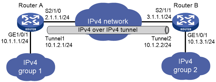

IPv4 over IPv4 tunneling
About IPv4 over IPv4 tunneling
IPv4 over IPv4 tunneling (RFC 1853) enables isolated IPv4 networks to communicate. For example, an IPv4 over IPv4 tunnel can connect isolated private IPv4 networks over a public IPv4 network.
Figure 13 IPv4 over IPv4 tunnel
Figure 13 shows the encapsulation and de-encapsulation processes.
·     Encapsulation:
a.     Device A receives an IP packet from an IPv4 host and submits it to the IP protocol stack.
b.     The IPv4 protocol stack determines how to forward the packet according to the destination address in the IP header. If the packet is destined for the IPv4 host connected to Device B, Device A delivers the packet to the tunnel interface.
c.     The tunnel interface adds a new IPv4 header to the IPv4 packet and submits it to the IP protocol stack.
In the new header, the source IP address specifies the tunnel source, and the destination IP address specifies the tunnel destination.
d.     The IP protocol stack uses the destination IP address of the new IP header to look up the routing table, and then sends the packet out.
·     De-encapsulation:
a.     After receiving the packet, Device B delivers it to the IP protocol stack.
b.     If the protocol number is 4 (indicating an IPv4 packet is encapsulated within the packet), the IP protocol stack delivers the packet to the tunnel module for de-encapsulation.
c.     The tunnel module de-encapsulates the IP packet and sends it back to the IP protocol stack.
d.     The protocol stack forwards the de-encapsulated packet.

IPv4 over IPv4 tunnel configuration examples
Example: Configuring an IPv4 over IPv4 tunnel
As shown in Figure 14, the two subnets IPv4 group 1 and IPv4 group 2 use private IPv4 addresses. Configure an IPv4 over IPv4 tunnel between Router A and Router B to make the two subnets reachable to each other.
Figure 14 Network diagram

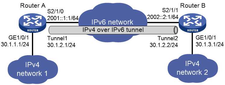

IPv4 over IPv6 tunneling
About IPv4 over IPv6 tunneling
Implementation
IPv4 over IPv6 tunneling adds an IPv6 header to IPv4 packets so that the IPv4 packets can pass an IPv6 network through a tunnel to realize interworking between isolated IPv4 networks.
Figure 15 IPv4 over IPv6 tunnel

Example: Configuring an IPv4 over IPv6 tunnel
As shown in Figure 18, configure an IPv4 over IPv6 manual tunnel between Router A and Router B so the two networks can reach each other over the IPv6 network.
Figure 18 Network diagram
Make sure Router A and Router B can reach each other through IPv6.

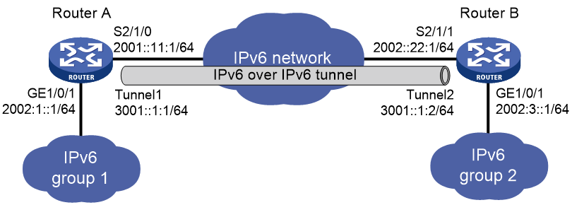

IPv6 over IPv6 tunneling
About IPv6 over IPv6 tunneling
IPv6 over IPv6 tunneling (RFC 2473) enables isolated IPv6 networks to communicate with each other over another IPv6 network. For example, two isolated IPv6 networks that do not want to show their addresses to the Internet can use an IPv6 over IPv6 tunnel to communicate with each other.
Figure 20 Principle of IPv6 over IPv6 tunneling
Figure 20 shows the encapsulation and de-encapsulation processes.
·     Encapsulation:
a.     After receiving an IPv6 packet, Device A submits it to the IPv6 protocol stack.
b.     The IPv6 protocol stack uses the destination IPv6 address of the packet to find the egress interface. If the egress interface is the tunnel interface, the stack delivers it to the tunnel interface.
c.     After receiving the packet, the tunnel interface adds an IPv6 header to it and submits it to the IPv6 protocol stack.
d.     The IPv6 protocol stack forwards the packet according to its destination IPv6 address.
·     De-encapsulation:
a.     Upon receiving the IPv6 packet, Device B delivers it to the IPv6 protocol stack.
b.     The IPv6 protocol stack checks the protocol type of the data portion encapsulated in the IPv6 packet. If the encapsulation protocol is IPv6, the stack delivers the packet to the tunnel module.
c.     The tunnel module de-encapsulates the packet and sends it back to the IPv6 protocol stack.
d.     The IPv6 protocol stack forwards the IPv6 packet.
