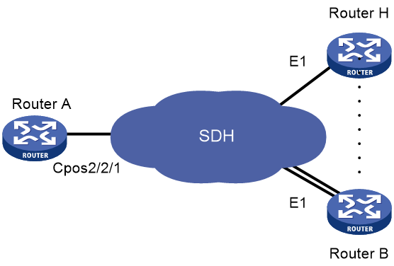

CPOS interface application scenarios
CPOS E1/T1 interfaces are typically used to aggregate E1 and T1 lines, as shown in Figure 1.
In actual applications, the connection between low-end devices and the CPOS interfaces might span more than one transmission network and might require relay.
Figure 1 CPOS E1/T1 interface application scenario

CPOS interface configuration examples
Example: Configuring CPOS-E1 channels
As shown in Figure 2, branch nodes Router B through Router H are uplinked to the central node Router A through E1 links. Router A aggregates these E1 links by using a CPOS interface.
Add one additional E1 link on Router B to expand its capacity, and use an MP-group interface to bind the two E1 links.
Figure 2 Network diagram
