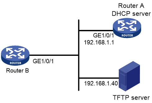

Using server-based automatic configuration
About server-based automatic configuration
As shown in Figure 1, server-based automatic configuration requires the following servers:
·     DHCP server.
·     File server (TFTP or HTTP server).
·     (Optional.) DNS server.
Figure 1 Server-based automatic configuration network diagram

Server-based automatic configuration examples
Example: Using a TFTP server for automatic configuration
As shown in Figure 2, Router B does not have a configuration file.
Configure the servers so Router B can obtain a configuration file to complete the following configuration tasks:
·     Enable the administrator to Telnet to Router B to manage Router B.
·     Require the administrator to enter the correct username and password at login.
Figure 2 Network diagram
1.     Configure the DHCP server:
# Enable DHCP.
<RouterA> system-view
[RouterA] dhcp enable
# Configure address pool 1 to assign IP addresses on the 192.168.1.0/24 subnet to clients. Specify the TFTP server and configuration file name for the clients.
[RouterA] dhcp server ip-pool 1
[RouterA-dhcp-pool-1] network 192.168.1.0 24
[RouterA-dhcp-pool-1] tftp-server ip-address 192.168.1.40
[RouterA-dhcp-pool-1] bootfile-name device.cfg
[RouterA-dhcp-pool-market] quit
2.     Configure the TFTP server:

# Start TFTP service software. (Details not shown.)
1.     Power on Router B.
2.     After Router B starts up, display assigned IP addresses on Router A.
<RouterA> display dhcp server ip-in-use
IP address       Client identifier/    Lease expiration      Type
                 Hardware address
192.168.1.2      0030-3030-632e-3239-  Dec 12 17:41:15 2013  Auto(C)
                 3035-2e36-3736-622d-
                 4574-6830-2f30-2f32
3.     Telnet to 192.168.1.2 from Router A.
<RouterA> telnet 192.168.1.2
4.     Enter username user and password abcabc as prompted. (Details not shown.)
You are logged in to Router B.

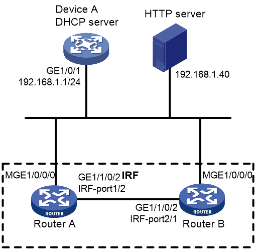

Example: Setting up an IRF fabric
As shown in Figure 5, Router A and Router B do not have a configuration file.
Configure the servers so the routers can obtain a Python script to complete their respective configurations and form an IRF fabric.
Figure 5 Network diagram
1.     Assign IP addresses to the interfaces. Make sure the devices can reach each other. (Details not shown.)
2.     Configure the following files on the HTTP server:
File
Content
Remarks
.cfg configuration file
Commands required for IRF setup.
You can create a configuration file by copying and modifying the configuration file of an existing IRF fabric.
sn.txt
Serial numbers of the member routers.
Each SN uniquely identifies a router.
These SNs will be used for assigning a unique IRF member ID to each member router.
(Optional.) .ipe or .bin software image file
Software images.
If the member routers are running different software versions, you must prepare the software image file used for software upgrade.
.py Python script file
Python commands that complete the following tasks:
a     (Optional.) Verify that the flash memory has sufficient space for the files to be downloaded.
b     Download the configuration file and sn.txt.
c     (Optional.) Download the software image file and specify it as the main startup image file.
d     Resolve sn.txt and assign a unique IRF member ID to each SN.
e     Specify the configuration file as the main next-startup configuration file.
f     Reboot the member routers.
For more information about Python script configuration, see "Using Python."
3.     Configure Device A as the DHCP server:
# Enable DHCP.
<DeviceA> system-view
[DeviceA] dhcp enable
[DeviceA] dhcp server ip-pool 1
[DeviceA-dhcp-pool-1] network 192.168.1.0 24
# Specify the URL of the script file for the clients.
[DeviceA-dhcp-pool-1] bootfile-name http://192.168.1.40/device.py
[DeviceA-dhcp-pool-1] quit
# Enable the DHCP server on GigabitEthernet 1/0/1.
[DeviceA-GigabitEthernet1/0/1] dhcp select server
[DeviceA-GigabitEthernet1/0/1] quit
4.     Power on Router A and Router B.
Router A and Router B will obtain the Python script file from the DHCP server and execute the script. After completing the IRF configuration, Router A and Router B reboot.
5.     After Router A and Router B start up again, use a cable to connect Router A and Router B through their IRF physical ports.
Router A and Router B will elect a master member. The subordinate member will reboot to join the IRF fabric.
# On Router A, display IRF member devices. You can also use the display irf command on Router B to display IRF member devices.
<Router A> display irf
MemberID    Role    Priority  CPU-Mac         Description
   1        Standby 1         00e0-fc0f-8c02  ---
 *+2        Master  30        00e0-fc0f-8c14  ---
