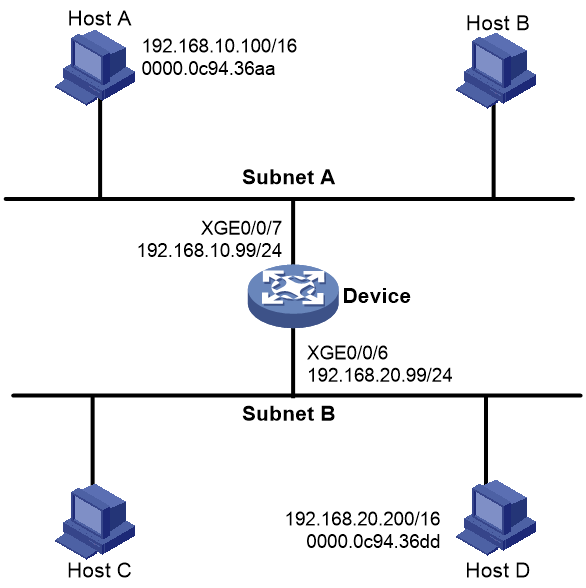

ARP operating mechanism
As shown in Figure 2, Host A and Host B are on the same subnet. Host A sends a packet to Host B as follows:
1.     Host A looks through the ARP table for an ARP entry for Host B. If one entry is found, Host A uses the MAC address in the entry to encapsulate the IP packet into a data link layer frame. Then Host A sends the frame to Host B.
2.     If Host A finds no entry for Host B, Host A buffers the packet and broadcasts an ARP request. The payload of the ARP request contains the following information:
¡     Sender IP address and sender MAC address—Host A's IP address and MAC address.
¡     Target IP address—Host B's IP address.
¡     Target MAC address—An all-zero MAC address.
All hosts on this subnet can receive the broadcast request, but only the requested host (Host B) processes the request.
3.     Host B compares its own IP address with the target IP address in the ARP request. If they are the same, Host B operates as follows:
a.     Adds the sender IP address and sender MAC address into its ARP table.
b.     Encapsulates its MAC address into an ARP reply.
c.     Unicasts the ARP reply to Host A.
4.     After receiving the ARP reply, Host A operates as follows:
a.     Adds the MAC address of Host B into its ARP table.
b.     Encapsulates the MAC address into the packet and sends the packet to Host B.
Figure 2 ARP address resolution process

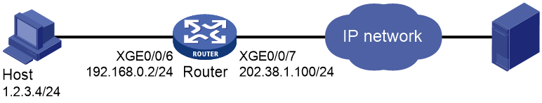

If Host A and Host B are on different subnets, Host A sends a packet to Host B as follows:
1.     Host A broadcasts an ARP request where the target IP address is the IP address of the gateway.
2.     The gateway responds with its MAC address in an ARP reply to Host A.
3.     Host A uses the gateway's MAC address to encapsulate the packet, and then sends the packet to the gateway.
4.     If the gateway has an ARP entry for Host B, it forwards the packet to Host B directly. If not, the gateway broadcasts an ARP request, in which the target IP address is the IP address of Host B.
5.     After the gateway gets the MAC address of Host B, it sends the packet to Host B.

Example: Configuring common proxy ARP
As shown in Figure 5, Host A and Host D have the same prefix and mask, but they are located on different subnets. No default gateway is configured on Host A and Host D.
Configure common proxy ARP on the router to ensure communication between Host A and Host D.
Figure 5 Network diagram
# Configure the IP address of Ten-GigabitEthernet 0/0/7.
<Router> system-view
[Router] interface ten-gigabitethernet 0/0/7
[Router-Ten-GigabitEthernet0/0/7] ip address 192.168.10.99 255.255.255.0
# Enable common proxy ARP on Ten-GigabitEthernet 0/0/7.
[Router-Ten-GigabitEthernet0/0/7] proxy-arp enable
[Router-Ten-GigabitEthernet0/0/7] quit
# Configure the IP address of Ten-GigabitEthernet 0/0/6.
[Router] interface ten-gigabitethernet 0/0/6
[Router-Ten-GigabitEthernet0/0/6] ip address 192.168.20.99 255.255.255.0
# Enable common proxy ARP on Ten-GigabitEthernet 0/0/6.
[Router-Ten-GigabitEthernet0/0/6] proxy-arp enable
[Router-Ten-GigabitEthernet0/0/6] quit
# Verify that Host A and Host D can ping each other.

As shown in Figure 6, all clients are in VLAN 2, and access the network through the switch. They have obtained IP addresses through DHCP.
Enable ARP snooping and ARP fast-reply for VLAN 2. The switch directly returns an ARP reply without broadcasting received ARP requests in the VLAN.
Figure 6 Network diagram
# Enable ARP snooping for VLAN 2 on the switch.
<Switch> system-view
[Switch] vlan 2
[Switch-vlan2] arp snooping enable
# Enable ARP fast-reply for VLAN 2 on the switch.
[Switch-vlan2] arp fast-reply enable
[Switch-vlan2] quit

As shown in Figure 7, configure the ARP PnP feature to allow the host at 1.2.3.4 to access the external server through Ten-GigabitEthernet 0/0/6.
Figure 7 Network diagram
1.     Configure NAT:
# Specify IP addresses for Ten-GigabitEthernet 0/0/6 and Ten-GigabitEthernet 0/0/7.
[Router-Ten-GigabitEthernet0/0/6] ip address 192.168.0.2 24
[Router-Ten-GigabitEthernet0/0/7] ip address 202.38.1.100 24
# Configure ACL 2000 to identify packets from subnet 192.168.0.0/24.
[Router] acl basic 2000
[Router-acl-ipv4-basic-2000] rule permit source 192.168.0.0 0.0.0.255
[Router-acl-ipv4-basic-2000] quit
# Create address group 1, and add address 202.38.1.100 to the group.
[Router] nat address-group 1
[Router-nat-address-group-1] address 202.38.1.100 202.38.1.100
[Router-nat-address-group-1] quit
# Enable outbound PAT on interface Ten-GigabitEthernet 0/0/7 to translate the source address of outgoing packets matching ACL 2000 into the address in address group 1.
[Router-Ten-GigabitEthernet0/0/7] nat outbound 2000 address-group 1
2.     Enable the ARP PnP feature on Ten-GigabitEthernet 0/0/6.
[Router-Ten-GigabitEthernet0/0/6] arp pnp
# Verify that the router creates an ARP PnP mapping for the host IP address 1.2.3.4 on Ten-GigabitEthernet 0/0/6.
[Router] display arp pnp interface ten-gigabitethernet 0/0/6
Total number of entries : 1
Agent IP address   User IP address   MAC address      Interface   Aging
192.168.0.3        1.2.3.4           00e0-fc00-0001   XGE0/0/6    10
