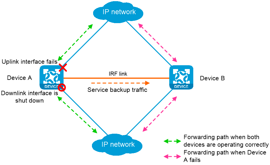

IRF HA works as follows, as shown in Figure 1:
1.     When both devices are working correctly, Device A forwards traffic, and service data and entries are backed up from Device A to Device B.
2.     Track detects that the uplink interface of Device A fails.
3.     The redundancy group shuts down the downlink interface of Device A.
4.     Traffic is switched to Device B for forwarding. Because Device B already has service data and entries, traffic migration almost has no impact on the services.
Figure 1 IRF HA workflow

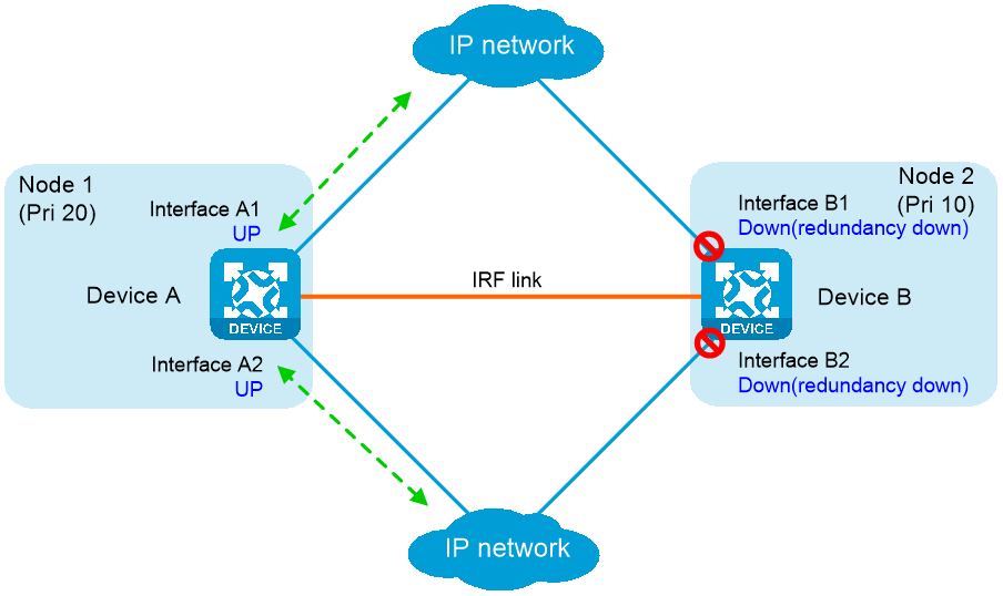

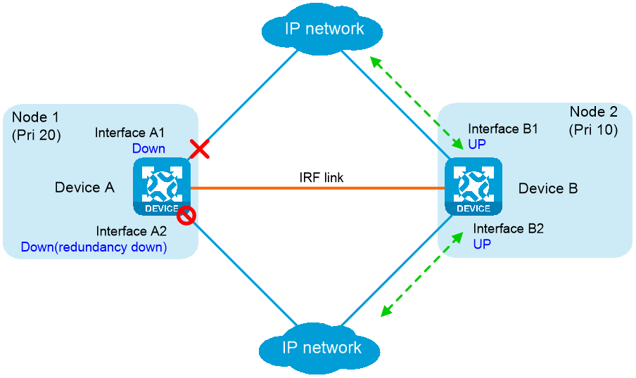

As shown in Figure 2, Port 1 and Port 2 are on Node 1, and Port 3 and Port 4 are on Node 2. When Node 1 is in primary state, Port 1 and Port 2 are up to forward traffic, while Port 3 and Port 4 are shut down by the Reth module.
When Port 1 goes down, the Reth module places Node 1 in secondary state and shuts down Port 2. Node 2 changes to the primary state, and Port 3 and Port 4 come up to forward traffic, as shown in Figure 3.
Figure 2 States of the member interfaces when both nodes are operating correctly
Figure 3 States of the member interfaces after a switchover

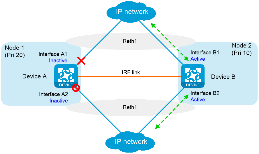

As shown in Figure 4, redundancy group 1 contains Reth 1 for uplink traffic and Reth 2 for downlink traffic. Reth 1 contains Port 1 (on Node 1) and Port 3 (on Node 2). Reth 2 contains Port 2 (on Node 1) and Port 4 (on Node 2).
When Node 1 is in primary state, Port 1 in Reth 1 and Port 2 in Reth 2 are active to forward uplink and downlink traffic, respectively.
When Port 1 fails, the Reth module places Node 1 in secondary state and shuts down Port 2, as shown in Figure 5. Node 2 changes to the primary state, and Port 3 and Port 4 become active to forward uplink and downlink traffic.
Figure 4 States of each Reth interface's members when both nodes are operating correctly
Figure 5 States of each Reth interface's members after a switchover

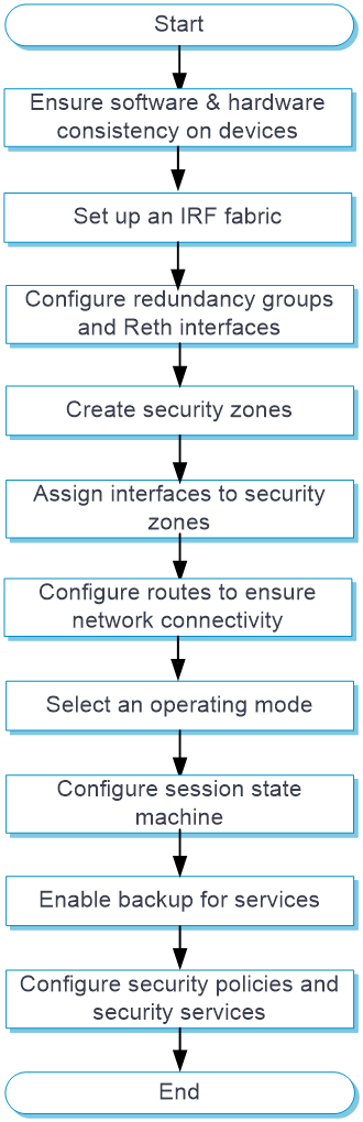

Set up an IRF fabric by using two devices before you configure IRF HA on them.
IRF HA configuration flow
Figure 6 IRF HA configuration flow chart
