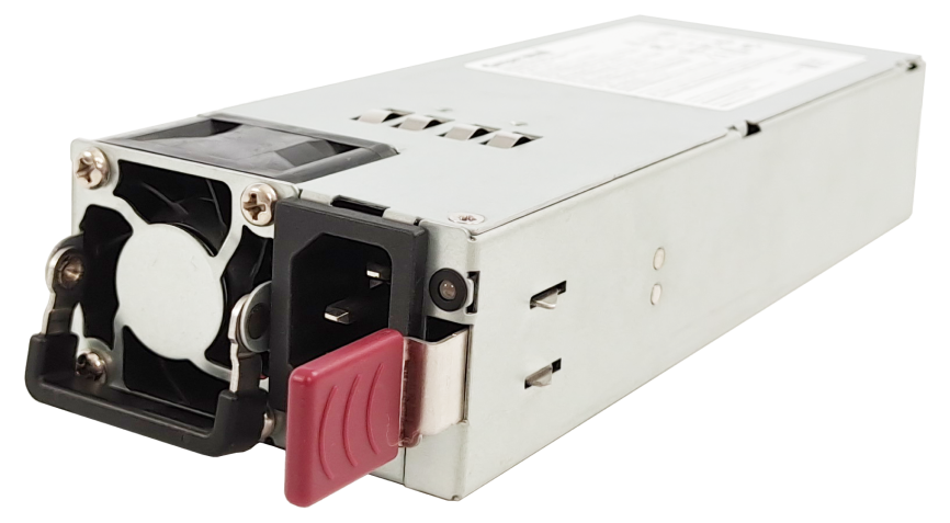

Figure1-1 PS-2801-9L3 power supply
Figure1-2 Front panel
(1) Power supply LED
(2) Latch
(3) Power receptacle
(4) Handle
