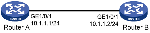

As shown in Figure 1, configure the Layer 3 connection keepalive feature on Router A to meet the following requirements:
·     Router A sends Layer 3 packets to Router B when Router B works correctly.
·     Router A stops sending Layer 3 packets to Router B when Router B becomes abnormal.
Figure 1 Network diagram

The output shows that the track entry associated with the feature is in Positive state, which means that Router B works correctly.
# Delete the IP address of GigabitEthernet 2/0/1 on Router B, and execute the display l3-keepalive command after a period of time.
Interface            Track ID       State
GE2/0/1              1              Negative
The output shows that the track entry associated with the feature is in Negative state, which means that Router B becomes abnormal. In this case, GigabitEthernet 2/0/1 on Switch A stops sending Layer 3 packets to the peer interface.
