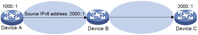

IPv6 Unicast Reverse Path Forwarding (uRPF) protects a network against source address spoofing attacks, such as DoS and DDoS attacks.
IPv6 uRPF application scenario
Attackers send packets with a forged source address to access a system that uses IPv6-based authentication, in the name of authorized users or even the administrator. Even if the attackers or other hosts cannot receive any response packets, the attacks are still disruptive to the attacked target.
Figure 5 Source address spoofing attack
As shown in Figure 5, an attacker on Device A sends the server (Device B) requests with a forged source IPv6 address 2000::1 at a high rate. Device B sends response packets to IPv6 address 2000::1 (Device C). Consequently, both Device B and Device C are attacked. If the administrator disconnects Device C by mistake, the network service is interrupted.
Attackers can also send packets with different forged source addresses or attack multiple servers simultaneously to block connections or even break down the network.
IPv6 uRPF can prevent these source address spoofing attacks. It checks whether an interface that receives a packet is the output interface of the FIB entry that matches the source address of the packet. If not, IPv6 uRPF considers it a spoofing attack and discards the packet.

[RouterA-GigabitEthernet2/0/1] ipv6 address 1000::1/64
# Configure strict uRPF check on GigabitEthernet 2/0/1 and allow using the default route for IPv6 uRPF check.
[RouterA-GigabitEthernet2/0/1] ipv6 urpf strict allow-default-route
