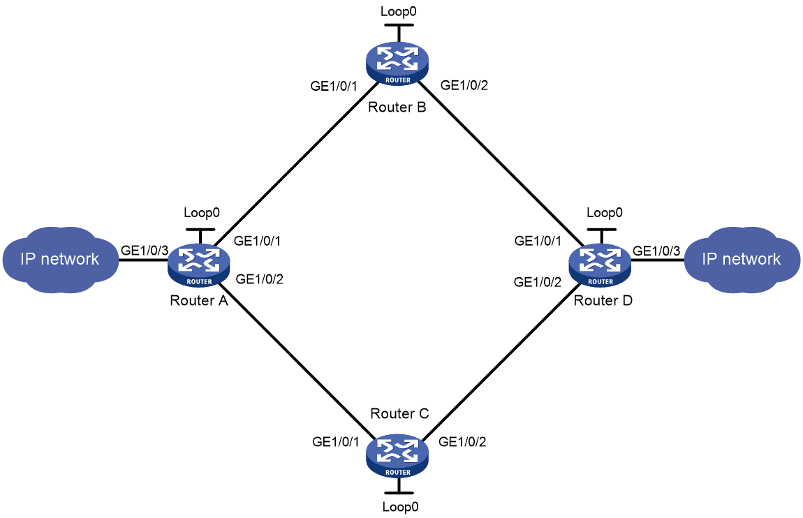

·     1:1 protection switching—Typically, traffic travels along the working tunnel. When either of the following events occurs, the ingress node selects the traffic forwarding tunnel (working or protection tunnel) according to the protection state:
¡     The ingress or egress node detects a failure on the working tunnel.
¡     An external switching command is executed on the node.
·     1+1 protection switching—Typically, traffic travels along both the working and protection tunnels, and the egress node receives traffic from the working tunnel. When either of the following events occurs, the egress node determines from which tunnel it receives traffic according to the protection state:
·     The tunnel ingress or egress node can detect tunnel failures through BFD for MPLS or other detection mechanisms. For more information about BFD for MPLS, see "Configuring MPLS OAM."
·     The protection state indicates the comprehensive status of a protection switching protection group. For more information, see the display mpls forwarding protection command in MPLS Command Reference.
Path switching modes
A bidirectional MPLS TE tunnel switches the traffic forwarding path in one of the following modes:
·     Unidirectional path switching—When an external switching command or a signal fail triggers protection switching for traffic in one direction, protection switching switches the traffic forwarding tunnel only in this direction. The traffic forwarding tunnel in the other direction does not change.
·     Bidirectional path switching—When an external switching command or a signal fail triggers protection switching for traffic in one direction, protection switching switches the traffic forwarding tunnels in both directions.
The ingress node and the egress node periodically send Protection State Coordination (PSC) packets to each other to coordinate the protection state. When one tunnel end performs a protection switching, the other end also performs a protection switching.
1:1 protection switching supports both unidirectional and bidirectional path switching. 1+1 protection switching supports only bidirectional path switching.

Example: Configuring MPLS TE tunnel 1:1 protection switching
Router A, Router B, Router C, and Router D run IS-IS.
Establish two MPLS TE tunnels (Tunnel 1 and Tunnel 2) from Router A to Router D to allow communication between two IP networks over the MPLS TE tunnels. Tunnel 1 uses the path Router A—Router B—Router D. Tunnel 2 uses the path Router A—Router C—Router D.
Configure protection switching on Router A by creating an MPLS protection group, and specify Tunnel 1 as the working tunnel and Tunnel 2 as the protection tunnel.
Figure 1 Network diagram
Device
Interface
IP address
Device
Interface
IP address
Router A
Loop0
1.1.1.1/32
Router D
Loop0
4.4.4.4/32
GE1/0/1
2.1.1.1/24
GE1/0/1
4.1.1.2/24
GE1/0/2
3.1.1.1/24
GE1/0/2
5.1.1.2/24
GE1/0/3
100.1.1.1/24
GE1/0/3
100.1.2.1/24
Router B
Loop0
2.2.2.2/32
Router C
Loop0
3.3.3.3/32
GE1/0/1
2.1.1.2/24
GE1/0/1
3.1.1.2/24
GE1/0/2
4.1.1.1/24
GE1/0/2
5.1.1.1/24
