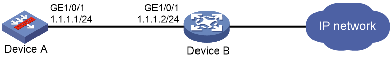

uRPF application scenario
Attackers send packets with a forged source address to access a system that uses IPv4-based authentication, in the name of authorized users or even the administrator. Even if the attackers or other hosts cannot receive any response packets, the attacks are still disruptive to the attacked target.
Figure 1 Source address spoofing attack
As shown in Figure 1, an attacker on Device A sends the server (Device B) requests with a forged source IP address 2.2.2.1 at a high rate. Device B sends response packets to IP address 2.2.2.1 (Device C). Consequently, both Device B and Device C are attacked. If the administrator disconnects Device C by mistake, the network service is interrupted.
Attackers can also send packets with different forged source addresses or attack multiple servers simultaneously to block connections or even break down the network.
uRPF can prevent these source address spoofing attacks. It checks whether an interface that receives a packet is the output interface of the FIB entry that matches the source address of the packet. If not, uRPF considers it a spoofing attack and discards the packet.

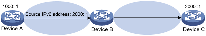

Example: Configuring uRPF for interfaces
As shown in Figure 4, perform the following tasks:
·     Configure strict uRPF check on GigabitEthernet 1/0/1 of Router B and permit packets from network 10.1.1.0/24.
·     Configure strict uRPF check on GigabitEthernet 1/0/1 of Router A and allow using the default route for uRPF check.
Figure 4 Network diagram
1.     Configure Router B:
# Configure ACL 2010 to permit traffic from network 10.1.1.0/24.
<RouterB> system-view
[RouterB] acl basic 2010
[RouterB-acl-ipv4-basic-2010] rule permit source 10.1.1.0 0.0.0.255
[RouterB-acl-ipv4-basic-2010] quit
# Specify an IP address for GigabitEthernet 1/0/1.
[RouterB-GigabitEthernet1/0/1] ip address 1.1.1.2 255.255.255.0
# Configure strict uRPF check on GigabitEthernet 1/0/1.
[RouterB-GigabitEthernet1/0/1] ip urpf strict acl 2010
2.     Configure Router A:
<RouterA> system-view
[RouterA] interface gigabitethernet 1/0/1
[RouterA-GigabitEthernet1/0/1] ip address 1.1.1.1 255.255.255.0
# Configure strict uRPF check on GigabitEthernet 1/0/1 and allow using the default route for uRPF check.
[RouterA-GigabitEthernet1/0/1] ip urpf strict allow-default-route

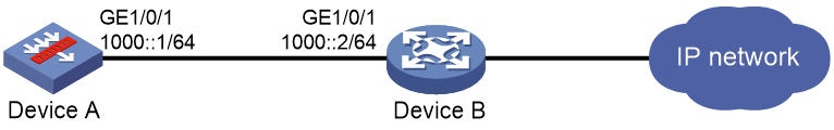

IPv6 uRPF application scenario
Attackers send packets with a forged source address to access a system that uses IPv6-based authentication, in the name of authorized users or even the administrator. Even if the attackers or other hosts cannot receive any response packets, the attacks are still disruptive to the attacked target.
Figure 5 Source address spoofing attack
As shown in Figure 5, an attacker on Device A sends the server (Device B) requests with a forged source IPv6 address 2000::1 at a high rate. Device B sends response packets to IPv6 address 2000::1 (Device C). Consequently, both Device B and Device C are attacked. If the administrator disconnects Device C by mistake, the network service is interrupted.
IPv6 uRPF can prevent these source address spoofing attacks. It checks whether an interface that receives a packet is the output interface of the FIB entry that matches the source address of the packet. If not, IPv6 uRPF considers it a spoofing attack and discards the packet.
[RouterB] acl ipv6 basic 2010
[RouterB-acl-ipv6-basic-2010] rule permit source 1010:: 64
[RouterB-acl-ipv6-basic-2010] quit
# Specify an IPv6 address for GigabitEthernet 1/0/1.
[RouterB-GigabitEthernet1/0/1] ipv6 address 1000::2/64
[RouterB-GigabitEthernet1/0/1] ipv6 urpf strict acl 2010
[RouterA-GigabitEthernet1/0/1] ipv6 address 1000::1/64
# Configure strict uRPF check on GigabitEthernet 1/0/1 and allow using the default route for IPv6 uRPF check.
[RouterA-GigabitEthernet1/0/1] ipv6 urpf strict allow-default-route
