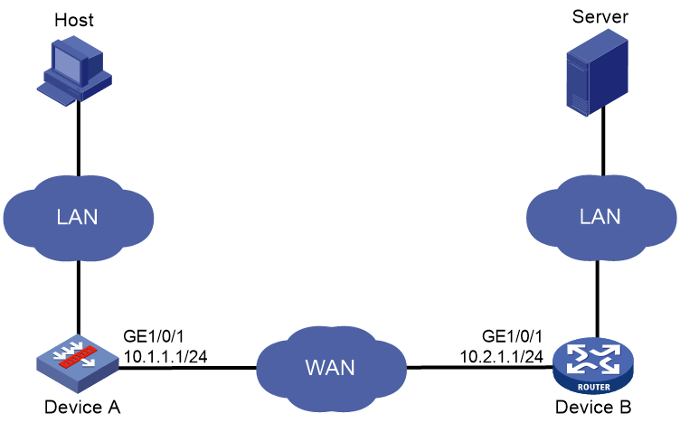

Restrictions and guidelines: WAAS configuration
For the WAAS feature to work correctly, make sure fast forwarding load sharing is disabled. For information about fast forwarding load sharing, see Layer 3IP Services Configuration Guide.
WAAS tasks at a glance
To configure WAAS, perform the following tasks:
1.     Configure TCP optimization:
a.     Configuring a WAAS class
b.     Configuring TFO parameters
c.     Configuring DRE optimization parameters
d.     (Optional.) Configuring the TFO blacklist autodiscovery feature
e.     Configuring a WAAS policy for TCP traffic
f.     Applying a WAAS policy to an interface
2.     Configure FEC optimization:
a.     Configuring an RTP WAAS class
b.     Configuring FEC optimization parameters
c.     Configuring a WAAS policy for RTP traffic
d.     Applying a WAAS policy to an interface
·     (Optional.) Configuring WAAS to operate in asymmetric mode
·     (Optional.) Restoring predefined WAAS settings
·     (Optional.) Deleting all WAAS settings

WAAS configuration examples
Example: Applying the predefined WAAS policy
As shown in Figure 1, apply the predefined WAAS policy on Device A and Device B.
The host downloads data from the server. Examine the optimization effect by comparing DRE statistics for the first download and second download.
·     For the first download, both WAAS devices create data dictionary entries and Device A sends both indexes and metadata.
·     For the second download, Device A replaces repeated data with indexes.
Figure 1 Network diagram
