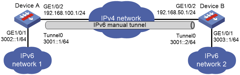

IPv6 over IPv4 manual tunneling
An IPv6 over IPv4 manual tunnel is a point-to-point link. To establish a manual tunnel, you must manually configure the source and destination addresses of the tunnel at both ends of the tunnel.
Manual tunneling provides the following solutions:
·     Connects isolated IPv6 networks over an IPv4 network.
·     Connects an IPv6 network and an IPv4/IPv6 dual-stack host over an IPv4 network.

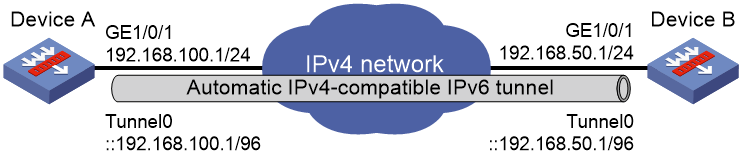

Automatic IPv4-compatible IPv6 tunneling
An automatic IPv4-compatible IPv6 tunnel is a point-to-multipoint link. The ends of an automatic IPv4-compatible IPv6 tunnel are IPv4-compatible IPv6 addresses. The address format is 0:0:0:0:0:0:a.b.c.d/96, where a.b.c.d is an IPv4 address. The destination IPv4 address of an automatic IPv4-compatible IPv6 tunnel is embedded in the destination IPv4-compatible IPv6 address. This mechanism enables the device to automatically obtain the tunnel destination address.
Automatic IPv4-compatible IPv6 tunnels have limitations because IPv4-compatible IPv6 addresses must use globally unique IPv4 addresses.

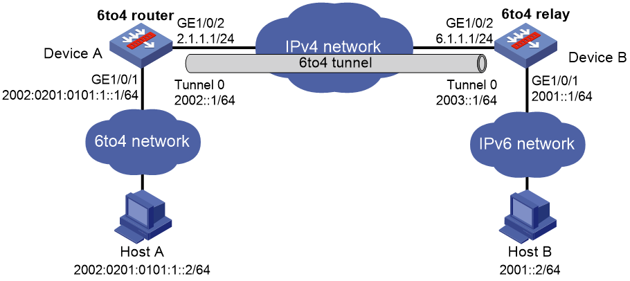

·     6to4 relay
6to4 relay connects a 6to4 network and an IPv6 network that uses an IP prefix other than 2002::/16. A 6to4 relay router is a gateway that forwards packets from a 6to4 network to an IPv6 network.
As shown in Figure 2, 6to4 network Site 1 communicates with IPv6 network Site 3 over a 6to4 tunnel. Configure a static route on the border router (Device A) in the 6to4 network. The next hop address must be the 6to4 address of the 6to4 relay router (Device C). Device A forwards all packets destined for the IPv6 network over the 6to4 tunnel, and Device C then forwards them to the IPv6 network.

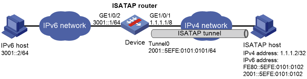

ISATAP tunneling
An ISATAP tunnel is a point-to-multipoint automatic tunnel. It provides a solution to connect an IPv6 host and an IPv6 network over an IPv4 network.
The destination address of an ISATAP tunnel is an ISATAP address. The address format is prefix:0:5EFE:abcd:efgh/64.
·     The 64-bit prefix is a valid IPv6 unicast address prefix.
·     The abcd:efgh/64 segments represent a 32-bit IPv4 address in hexadecimal notation, which identifies the tunnel destination but does not require global uniqueness.
ISATAP tunnels are mainly used for communication between IPv6 routers or between an IPv6 host and an IPv6 router over an IPv4 network.

Configuring an IPv6 over IPv4 manual tunnel
When you perform tasks in this section, follow these restrictions and guidelines:
·     The tunnel destination address specified on the local device must be identical with the tunnel source address specified on the tunnel peer device.
·     Do not specify the same tunnel source and destination addresses for different tunnels in the same mode on a device.
·     To ensure correct packet forwarding, identify whether the destination IPv6 network and the IPv6 address of the local tunnel interface are on the same subnet. If they are not, configure a route reaching the destination IPv6 network through the tunnel interface. You can configure the route by using one of the following methods:
¡     Configure a static route, and specify the local tunnel interface as the egress interface or specify the IPv6 address of the peer tunnel interface as the next hop.
¡     Enable a dynamic routing protocol on both the local and remote tunnel interfaces.
For more information about route configuration, see Layer 3—IP Routing Configuration Guide.

Configuring an automatic IPv4-compatible IPv6 tunnel
Follow these guidelines when you configure an automatic IPv4-compatible IPv6 tunnel:
·     You do not need to configure a destination address for an automatic IPv4-compatible IPv6 tunnel. The destination address of the tunnel is embedded in the destination IPv4-compatible IPv6 address.
·     Do not specify the same tunnel source addresses for tunnels of the same tunnel mode.

Example: Configuring 6to4 relay
As shown in Figure 7, Device A is a 6to4 router, and 6to4 addresses are used on the connected IPv6 network. Device B acts as a 6to4 relay router and is connected to an IPv6 network (2001::/16). Configure a 6to4 tunnel between Device A and Device B to make Host A and Host B reachable to each other.
The configuration on a 6to4 relay router is similar to that on a 6to4 router. However, to enable communication between the 6to4 network and the IPv6 network, you must configure a route to the IPv6 network on the 6to4 router. The IPv4 address of GigabitEthernet 1/0/2 on the relay router is 6.1.1.1/24 and its corresponding 6to4 prefix is 2002:0601:0101::/48. The next hop of the static route must be an address using this prefix.
Figure 7 Network diagram
Make sure Device A and Device B can reach each other through IPv4.
1.     Configure Device A:
# Specify an IPv4 address for GigabitEthernet 1/0/2.
<DeviceA> system-view
[DeviceA] interface gigabitethernet 1/0/2
[DeviceA-GigabitEthernet1/0/2] ip address 2.1.1.1 255.255.255.0
[DeviceA-GigabitEthernet1/0/2] quit
# Specify a 6to4 address for GigabitEthernet 1/0/1.
[DeviceA-GigabitEthernet1/0/1] ipv6 address 2002:0201:0101:1::1/64
[DeviceA-GigabitEthernet1/0/1] quit
# Create 6to4 tunnel interface Tunnel 0.
[DeviceA] interface tunnel 0 mode ipv6-ipv4 6to4
# Specify an IPv6 address for the tunnel interface.
[DeviceA-Tunnel0] ipv6 address 2002::1/64
# Specify GigabitEthernet 1/0/2 as the source interface of the tunnel.
[DeviceA-Tunnel0] source gigabitethernet 1/0/2
[DeviceA-Tunnel0] quit
# Configure a static route to the 6to4 relay router.
[DeviceA] ipv6 route-static 2002:0601:0101:: 64 tunnel 0
# Configure a default route to reach the IPv6 network, which specifies the next hop as the 6to4 address of the relay router.
[DeviceA] ipv6 route-static :: 0 2002:0601:0101::1
2.     Configure Device B:
<DeviceB> system-view
[DeviceB] interface gigabitethernet 1/0/2
[DeviceB-GigabitEthernet1/0/2] ip address 6.1.1.1 255.255.255.0
[DeviceB-GigabitEthernet1/0/2] quit
# Specify an IPv6 address for GigabitEthernet 1/0/1.
[DeviceB-GigabitEthernet1/0/1] ipv6 address 2001::1/16
[DeviceB-GigabitEthernet1/0/1] quit
[DeviceB] interface tunnel 0 mode ipv6-ipv4 6to4
[DeviceB-Tunnel0] ipv6 address 2003::1/64
[DeviceB-Tunnel0] source gigabitethernet 1/0/2
[DeviceB-Tunnel0] quit
# Configure a static route destined for 2002::/16 through the tunnel.
[DeviceB] ipv6 route-static 2002:: 16 tunnel 0
# Verify that Host A and Host B can ping each other.

Example: Configuring an ISATAP tunnel
As shown in Figure 8, configure an ISATAP tunnel between the ISATAP router (Device) and the ISATAP host so the ISATAP host in the IPv4 network can access the IPv6 network.
Figure 8 Network diagram

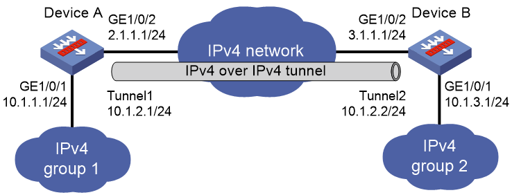

IPv4 over IPv4 tunneling
About IPv4 over IPv4 tunneling
IPv4 over IPv4 tunneling (RFC 1853) enables isolated IPv4 networks to communicate. For example, an IPv4 over IPv4 tunnel can connect isolated private IPv4 networks over a public IPv4 network.
Figure 9 IPv4 over IPv4 tunnel
Figure 9 shows the encapsulation and de-encapsulation processes.

Example: Configuring an IPv4 over IPv4 tunnel
As shown in Figure 10, the two subnets IPv4 group 1 and IPv4 group 2 use private IPv4 addresses. Configure an IPv4 over IPv4 tunnel between Device A and Device B to make the two subnets reachable to each other.
Figure 10 Network diagram

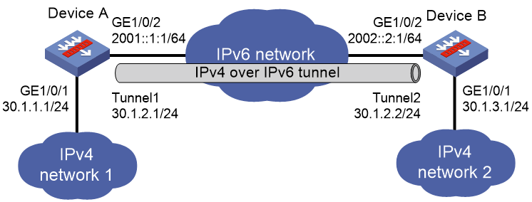

IPv4 over IPv6 tunneling adds an IPv6 header to IPv4 packets so that the IPv4 packets can pass an IPv6 network through a tunnel to realize interworking between isolated IPv4 networks.
Figure 11 IPv4 over IPv6 tunnel
Figure 11 shows the encapsulation and de-encapsulation processes.
·     Encapsulation:
a.     Upon receiving an IPv4 packet, Device A delivers it to the IPv4 protocol stack.
b.     The IPv4 protocol stack uses the destination address of the packet to determine the egress interface. If the egress interface is the tunnel interface, the IPv4 protocol stack delivers the packet to the tunnel interface.
c.     The tunnel interface adds an IPv6 header to the original IPv4 packet and delivers the packet to the IPv6 protocol stack.
d.     The IPv6 protocol stack uses the destination IPv6 address of the packet to look up the routing table, and then sends it out.
·     De-encapsulation:
a.     Upon receiving the IPv6 packet from the attached IPv6 network, Device B delivers the packet to the IPv6 protocol stack to examine the protocol type encapsulated in the data portion of the packet.
b.     If the protocol type is IPv4, the IPv6 protocol stack delivers the packet to the tunneling module.
c.     The tunneling module removes the IPv6 header and delivers the remaining IPv4 packet to the IPv4 protocol stack.
d.     The IPv4 protocol stack forwards the IPv4 packet.

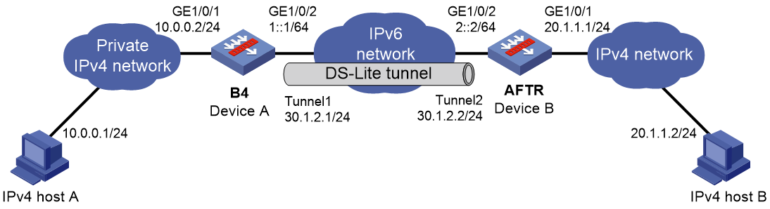

Dual Stack Lite (DS-Lite) is a combination of the tunneling and NAT technologies. NAT translates the private IPv4 addresses of the IPv4 hosts before the hosts reach the IPv4 public network.
DS-Lite tunnel supports only an IPv4 host in a private network initiating communication with an IPv4 host on the Internet. It does not support an IPv4 host on the Internet initiating communication with an IPv4 host in a private network.
Figure 12 DS-Lite tunnel
As shown in Figure 12, the DS-Lite feature contains the following components:
·     Basic Bridging BroadBand (B4) element
The B4 element is typically a CPE router that connects end hosts. IPv4 packets entering the B4 router are encapsulated into IPv6 packets and sent to the AFTR. IPv6 packets from the AFTR are de-encapsulated into IPv4 packets and sent to the subscriber's network.
Hosts that can act as the B4 router are referred to as DS-Lite hosts.
·     Address Family Transition Router (AFTR)
An AFTR resides in the ISP network and terminates the tunnel from the B4 router. NAT is also implemented on the interface that is connected to the public IPv4 network.
An AFTR de-encapsulates the tunneled packet, translates the network address, and routes the packet to the destination IPv4 network. For IPv4 packets coming from the public IPv4 network, the AFTR performs reverse address translation and sends them to the B4 router by using the DS-Lite tunnel.
Figure 13 Packet forwarding process in DS-Lite
As shown in Figure 13, the packet forwarding process in DS-Lite is as follows:
1.     Upon receiving a packet from the private IPv4 network, the B4 router adds an IPv6 header to the packet and sends the IPv6 packet to the AFTR through the tunnel.
2.     The AFTR performs the following operations:
a.     Removes the IPv6 header from the tunneled packet.
b.     Assigns a tunnel ID for the B4 router.
c.     Records the mapping between the IPv6 address of the B4 router (the source IPv6 address of the packet), and the tunnel ID.
3.     After de-encapsulation, the AFTR translates the source private IPv4 address of the packet into a public IPv4 address and sends the packet to the destination IPv4 host. The AFTR also maps the NAT entries to the tunnel ID so that IPv4 networks connected to different B4 routers can use the same address space.
4.     Upon receiving the response packet from the public network, the AFTR translates the destination public IPv4 address into the private IPv4 address. The AFTR performs the following operations:
a.     Looks up the IPv6 address-tunnel ID mapping to obtain the IP address of the B4 router.
b.     Uses the address as the destination address of the encapsulated IPv6 packet.
c.     Forwards the packet to the B4 router.
Figure 13 shows an example of PAT translation for dynamic NAT. Typically, dynamic NAT is used. When you use static NAT for DS-Lite tunneling, make sure the IP addresses of private IPv4 networks connected to different B4 routers do not overlap. For more information about NAT, see "Configuring NAT."
