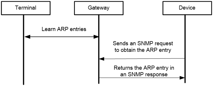

Working mechanism
Figure 1 MAC address learning through a Layer device workflow
As shown in Figure 1, MAC address learning through a Layer 3 device proceeds as follows:
1. The gateway learns the IP-MAC binding of the terminal, and then generates an ARP entry.
2. The device sends SNMP requests to the gateway at the specified intervals to request the ARP entry.
3. The gateway sends a response that contains the ARP entry to the device.
4. Upon receiving the response, the device saves the ARP entry in the memory. Then it can learn the MAC address of the terminal.

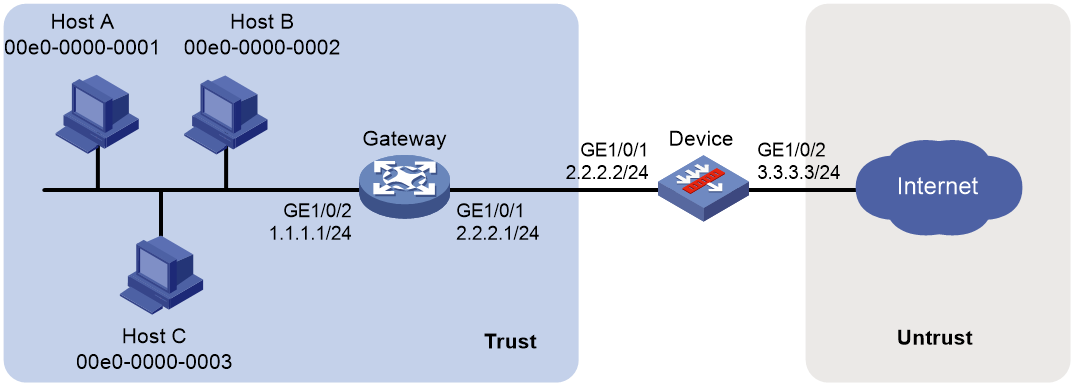

Example: Configuring MAC address learning through a Layer 3 device
As shown in Figure 2, hosts in an internal network are connected to the device through a Layer 3 gateway and the device is connected to the Internet.
· Configure MAC address learning through a Layer 3 device to ensure that the device can learn the MAC addresses of the hosts through the gateway.
· Configure security policies by using the learned MAC addresses to allow only Host A and Host B to access the Internet.

1. Verify that ARP entries have been synchronized to the device.
[Device] display snmp-server arp-sync table
IP Address MAC Address Aging(M)
1.1.1.1 00e0-0000-0001 1
1.1.1.2 00e0-0000-0002 1
1.1.1.3 00e0-0000-0003 1
Total:3
2. Verify that Host A and Host B can access the external network but Host C cannot.
