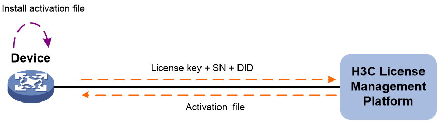

Configuring local licensing
About local licensing
Local licensing requires license activation device by device. It is applicable to small-sized networks.
To install a license on a device:
1.     Obtain the license key and the device SN and DID information of the device.
2.     Access H3C License Management Platform to apply for an activation file based on the license key and the device's SN and DID information.
3.     Install the activation file on the device to activate the license.
The activation file for a license is device locked. You cannot install the activation file for one device to activate the license on another device.
Figure 1 Local licensing procedure
