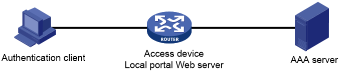

Web authentication system
A typical Web authentication system consists of four basic components: authentication client, access device, local portal Web server, and AAA server.
Figure 1 Web authentication system using the local portal server

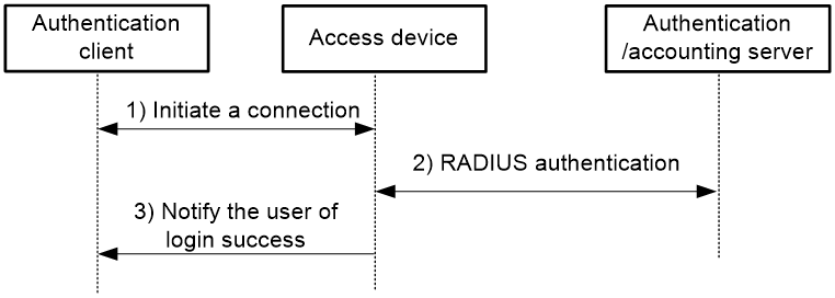

Web authentication process
Figure 2 Web authentication process
The Web authentication process is as follows:
1. An unauthenticated user sends an HTTP or HTTPS request. When the access device receives the HTTP or HTTPS request on a Layer 2 Ethernet interface enabled with Web authentication, it redirects the request to the Web authentication page. The user enters the username and password on the Web authentication page.
If the user requests the Web authentication page or free Web resources, the access device permits the request. No Web authentication is performed.
2. The access device and the AAA server exchange RADIUS packets to authenticate the user.
3. If the user passes RADIUS authentication, the local portal Web server pushes a login success page to the authentication client.
If the user fails RADIUS authentication, the local portal Web server pushes a login failure page to the authentication client.
