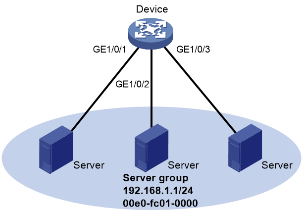

·     Multiport ARP entry—It contains the IP address, MAC address, VLAN information.
The device can use a multiport ARP entry that has the same MAC address, VLAN as a multicast or multiport unicast MAC address entry for packet forwarding. A multiport ARP entry is manually configured. It does not age out and cannot be overwritten by any dynamic ARP entry.
To communicate with a host by using a fixed IP-to-MAC mapping, configure a short static ARP entry on the device. To communicate with a host by using a fixed IP-to-MAC mapping through an interface in a VLAN, configure a long static ARP entry on the device.

Configuring a multiport ARP entry
About multiport ARP entries
A multiport ARP entry contains an IP address, MAC address, output interface, and VLAN ID information. The VLAN and output interfaces are specified by a multiport unicast MAC address entry or a multicast MAC address entry. For more information about multiport unicast MAC address entries, see Layer—2 LAN Switching Configuration Guide. For more information about multicast MAC address entries, see IP Multicast Configuration Guide.
A multiport ARP entry can overwrite a dynamic, short static or long static ARP entry. Conversely, a short static or long static ARP entry can overwrite a multiport ARP entry.
For a multiport ARP entry to be effective for packet forwarding, make sure the following conditions are met:
·     A multiport unicast MAC address entry or a multicast MAC address entry exists.
·     The multiport ARP entry must have the same MAC address as the multiport unicast MAC address entry or the multicast MAC address entry.
·     The IP address in the multiport ARP entry must reside on the same subnet as the VLAN interface of the specified VLAN.
If an aggregate interface is the output interface of an entry and its member ports reside on multiple IRF member devices, the device cannot use the entry to forward packets. To resolve this issue, set the global link-aggregation load sharing mode to a mode other than source or destination MAC address-based by using the link-aggregation global load-sharing mode command. For more information about this command, see Ethernet link aggregation in Layer 2—LAN Switching Command Reference.
2.     Configure a multiport unicast MAC address entry or a multicast MAC address entry.
¡     In a common network, configure a multiport unicast MAC address entry.
mac-address multiport mac-address interface interface-list vlan vlan-id
¡     In a common network, configure a multicast MAC address entry.
mac-address multicast mac-address interface interface-list vlan vlan-id
3.     Configure a multiport ARP entry.
arp multiport ip-address mac-address vlan-id [ vpn-instance vpn-instance-name ]

Example: Configuring a multiport ARP entry
As shown in Figure 5, a device connects to three servers through interfaces GigabitEthernet 1/0/1, GigabitEthernet 1/0/2, and GigabitEthernet 1/0/3 in VLAN 10. The servers share the IP address 192.168.1.1/24 and MAC address 00e0-fc01-0000.
Configure a multiport ARP entry so that the device sends IP packets with the destination IP address 192.168.1.1 to the three servers.
Figure 5 Network diagram
# Create VLAN 10.
<Device> system-view
[Device] vlan 10
[Device-vlan10] quit
# Add GigabitEthernet 1/0/1, GigabitEthernet 1/0/2, and GigabitEthernet 1/0/3 to VLAN 10.
[Device-GigabitEthernet1/0/1] port access vlan 10
[Device] interface gigabitethernet 1/0/2
[Device-GigabitEthernet1/0/2] port access vlan 10
[Device-GigabitEthernet1/0/2] quit
[Device] interface gigabitethernet 1/0/3
[Device-GigabitEthernet1/0/3] port access vlan 10
[Device-GigabitEthernet1/0/3] quit
# Create VLAN-interface 10 and specify its IP address.
[Device] interface vlan-interface 10
[Device-vlan-interface10] ip address 192.168.1.2 24
[Device-vlan-interface10] quit
# Configure a multiport unicast MAC address entry that has MAC address 00e0-fc01-0000, and output interfaces GigabitEthernet 1/0/1, GigabitEthernet 1/0/2, and GigabitEthernet 1/0/3 in VLAN 10.
[Device] mac-address multiport 00e0-fc01-0000 interface gigabitethernet 1/0/1 to gigabitethernet 1/0/3 vlan 10
# Configure a multiport ARP entry with IP address 192.168.1.1 and MAC address 00e0-fc01-0000.
[Device] arp multiport 192.168.1.1 00e0-fc01-0000 10
# Verify that the device has a multiport ARP entry with IP address 192.168.1.1 and MAC address 00e0-fc01-0000.
[Device] display arp
  Type: S-Static   D-Dynamic   O-Openflow   R-Rule   M-Multiport  I-Invalid
IP address      MAC address    VLAN/VSI   Interface                Aging Type
192.168.1.1     00e0-fc01-0000 10         --                       --    M
