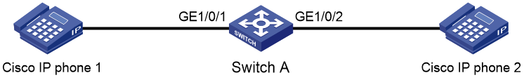

LLDP exchanges packets between neighbor agents and creates and maintains neighbor information for them. Figure 1 shows the neighbor relationships for these LLDP agents.
Figure 1 LLDP neighbor relationships

Configuring CDP compatibility
About CDP compatibility
To enable your device to exchange information with a directly connected Cisco device that supports only CDP, you must enable CDP compatibility.
CDP compatibility enables your device to receive and recognize CDP packets from the neighboring CDP device and send CDP packets to the neighboring device. The CDP packets sent to the neighboring CDP device carry the following information:
·     Device ID.
·     ID of the port connecting to the neighboring device.
·     Port IP address.
·     TTL.
The port IP address is the primary IP address of a VLAN interface in up state. The VLAN ID of the VLAN interface must be the lowest among the VLANs permitted on the port. If no VLAN interfaces of the permitted VLANs are assigned an IP address or all VLAN interfaces are down, no port IP address will be advertised.
You can view the neighboring CDP device information that can be recognized by the device in the output of the display lldp neighbor-information command. For more information about the display lldp neighbor-information command, see LLDP commands in Layer 2—LAN Switching Command Reference.
To make your device work with Cisco IP phones, you must enable CDP compatibility.
If your LLDP-enabled device cannot recognize CDP packets, it does not respond to the requests of Cisco IP phones for the voice VLAN ID configured on the device. As a result, a requesting Cisco IP phone sends voice traffic without any tag to your device. Your device cannot differentiate the voice traffic from other types of traffic.
CDP compatibility enables your device to receive and recognize CDP packets from a Cisco IP phone and respond with CDP packets carrying TLVs with the configured voice VLAN. If no voice VLAN is configured for CDP packets, CDP packets carry the voice VLAN of the port or the voice VLAN assigned by the RADIUS server. The assigned voice VLAN has a higher priority. According to TLVs with the voice VLAN configuration, the IP phone automatically configures the voice VLAN. As a result, the voice traffic is confined in the configured voice VLAN and is differentiated from other types of traffic.
For more information about voice VLANs, see "Configuring voice VLANs."
When the device is connected to a Cisco IP phone that has a host attached to its data port, the host must access the network through the Cisco IP phone. If the data port goes down, the IP phone will send a CDP packet to the device so the device can log out the user.
CDP-compatible LLDP operates in one of the following modes:
·     TxRx—CDP packets can be transmitted and received.
·     Rx—CDP packets can be received but cannot be transmitted.
·     Disable—CDP packets cannot be transmitted or received.
When you configure CDP compatibility for LLDP, follow these restrictions and guidelines:
·     To make CDP-compatible LLDP take effect on a port, follow these steps:
a.     Enable CDP-compatible LLDP globally.
b.     Configure CDP-compatible LLDP to operate in TxRx mode on the port.
·     The maximum TTL value that CDP allows is 255 seconds. To make CDP-compatible LLDP work correctly with Cisco IP phones, configure the LLDP frame transmission interval to be no more than 1/3 of the TTL value.
Before you configure CDP compatibility, complete the following tasks:
·     Globally enable LLDP.
·     Enable LLDP on the port connecting to a CDP device.
·     Configure LLDP to operate in TxRx mode on the port.
2.     Enable CDP compatibility globally.
lldp compliance cdp
By default, CDP compatibility is disabled globally.
3.     Enter Layer 2/Layer 3 Ethernet interface view or management Ethernet interface view.
4.     Configure CDP-compatible LLDP to operate in TxRx mode.
lldp compliance admin-status cdp txrx
By default, CDP-compatible LLDP operates in disable mode.
5.     Set the voice VLAN ID carried in CDP packets.
cdp voice-vlan vlan-id
By default, no voice VLAN ID is configured to be carried in CDP packets.

Example: Configuring CDP-compatible LLDP
As shown in Figure 6, GigabitEthernet 1/0/1 and GigabitEthernet 1/0/2 of Switch A are each connected to a Cisco IP phone, which sends tagged voice traffic.
Configure voice VLAN 2 on Switch A. Enable CDP compatibility of LLDP on Switch A to allow the Cisco IP phones to automatically configure the voice VLAN. The voice VLAN feature performs the following operations:
·     Confines the voice traffic to the voice VLAN.
·     Isolates the voice traffic from other types of traffic.
Figure 6 Network diagram
1.     Configure a voice VLAN on Switch A:
# Create VLAN 2.
<SwitchA> system-view
[SwitchA] vlan 2
[SwitchA-vlan2] quit
# Set the link type of GigabitEthernet 1/0/1 and GigabitEthernet 1/0/2 to trunk, and enable voice VLAN on them.
[SwitchA] interface gigabitethernet 1/0/1
[SwitchA-GigabitEthernet1/0/1] port link-type trunk
[SwitchA-GigabitEthernet1/0/1] voice-vlan 2 enable
[SwitchA-GigabitEthernet1/0/1] quit
[SwitchA] interface gigabitethernet 1/0/2
[SwitchA-GigabitEthernet1/0/2] port link-type trunk
[SwitchA-GigabitEthernet1/0/2] voice-vlan 2 enable
[SwitchA-GigabitEthernet1/0/2] quit
2.     Configure CDP-compatible LLDP on Switch A:
# Enable LLDP globally, and enable CDP compatibility globally.
[SwitchA] lldp global enable
[SwitchA] lldp compliance cdp
# Enable LLDP on GigabitEthernet 1/0/1. By default, LLDP is enabled on ports.
[SwitchA-GigabitEthernet1/0/1] lldp enable
# Configure LLDP to operate in TxRx mode on GigabitEthernet 1/0/1.
[SwitchA-GigabitEthernet1/0/1] lldp admin-status txrx
# Configure CDP-compatible LLDP to operate in TxRx mode on GigabitEthernet 1/0/1.
[SwitchA-GigabitEthernet1/0/1] lldp compliance admin-status cdp txrx
# Enable LLDP on GigabitEthernet 1/0/2. By default, LLDP is enabled on ports.
[SwitchA-GigabitEthernet1/0/2] lldp enable
# Configure LLDP to operate in TxRx mode on GigabitEthernet 1/0/2.
[SwitchA-GigabitEthernet1/0/2] lldp admin-status txrx
# Configure CDP-compatible LLDP to operate in TxRx mode on GigabitEthernet 1/0/2.
[SwitchA-GigabitEthernet1/0/2] lldp compliance admin-status cdp txrx
# Verify that Switch A has completed the following operations:
·     Discovering the IP phones connected to GigabitEthernet 1/0/1 and GigabitEthernet 1/0/2.
·     Obtaining IP phone information.
[SwitchA] display lldp neighbor-information
CDP neighbor-information of port 1[GigabitEthernet1/0/1]:
LLDP agent nearest-bridge:
 CDP neighbor index  : 1
 Chassis ID          : SEP00141CBCDBFE
 Port ID             : Port 1
CDP neighbor-information of port 2[GigabitEthernet1/0/2]:
 CDP neighbor index  : 2
 Chassis ID          : SEP00141CBCDBFF
 Port ID             : Port 1
