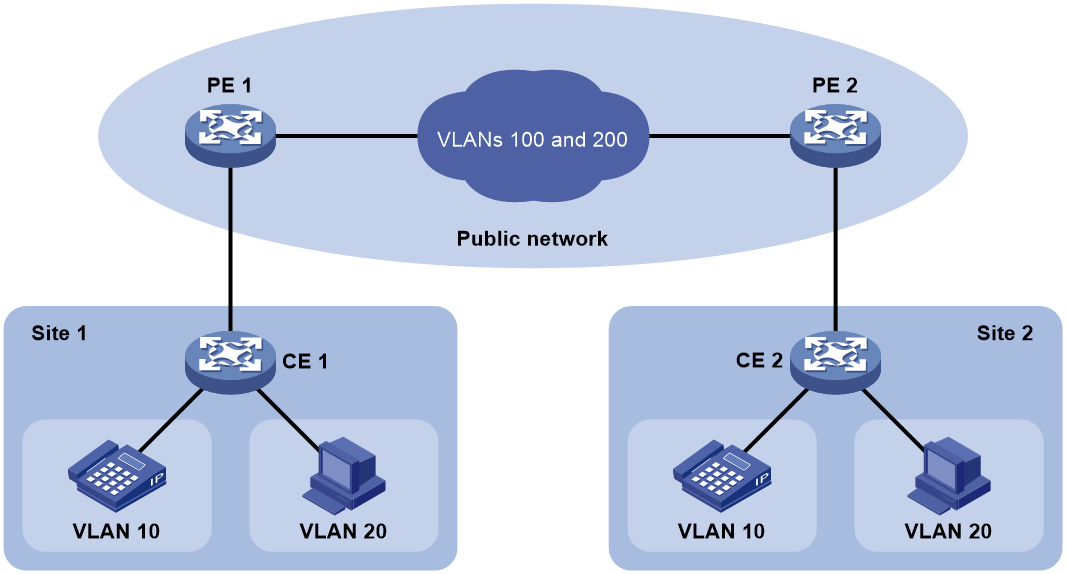

One-to-two VLAN mapping
As shown in Figure 2, one-to-two VLAN mapping is used to transmit different types of CVLAN packets with different SVLAN tags over the service provider network.
Figure 2 Application scenario of one-to-two VLAN mapping
As shown in Figure 2, users of Site 1 and Site 2 are in VLAN 10 and VLAN 20. The service provider assigns VLAN 100 and VLAN 200 to the customer network. When packets from Site 1 arrive at PE 1, PE 1 adds an SVLAN tag to the packets based on the packet type.
One-to-two VLAN mapping enables the customer to plan CVLANs without conflicting with SVLANs. The service provider can distinguish traffic of the customer network with different SVLANs, and apply transmission policies to the customer traffic.

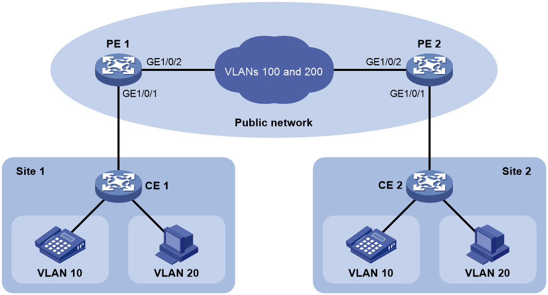

Example: Configuring one-to-two VLAN mapping
As shown in Figure 7, Site 1 and Site 2 of a company use VLAN 10 and VLAN 20 to transmit VoIP and PC traffic, respectively. The service provider assigns VLAN 100 and VLAN 200 to the customer network.
Configure one-to-two VLAN mappings to enable the service provider network to transmit VoIP and PC traffic with SVLAN 100 and SVLAN 200, respectively.
Figure 7 Network diagram
1.     Configure PE 1:
# Create VLANs 10, 20, 100, and 200.
<PE1> system-view
[PE1] vlan 10
[PE1-vlan10] quit
[PE1] vlan 20
[PE1-vlan20] quit
[PE1] vlan 100
[PE1-vlan100] quit
[PE1] vlan 200
[PE1-vlan200] quit
# Configure a one-to-two VLAN mapping on the customer-side port (GigabitEthernet 1/0/1) to add SVLAN tag 100 to packets from CVLAN 10.
[PE1] interface gigabitethernet 1/0/1
[PE1-GigabitEthernet1/0/1] vlan mapping nest single 10 nested-vlan 100
# Configure a one-to-two VLAN mapping on GigabitEthernet 1/0/1 to add SVLAN tag 200 to packets from CVLAN 20.
[PE1-GigabitEthernet1/0/1] vlan mapping nest single 20 nested-vlan 200
# Configure GigabitEthernet 1/0/1 as a hybrid port.
[PE1-GigabitEthernet1/0/1] port link-type hybrid
# Assign GigabitEthernet 1/0/1 to VLANs 100 and 200 as an untagged member.
[PE1-GigabitEthernet1/0/1] port hybrid vlan 100 200 untagged
[PE1-GigabitEthernet1/0/1] quit
# Configure the network-side port (GigabitEthernet 1/0/2) as a trunk port, and assign the port to VLANs 100 and 200.
[PE1] interface gigabitethernet 1/0/2
[PE1-GigabitEthernet1/0/2] port link-type trunk
[PE1-GigabitEthernet1/0/2] port trunk permit vlan 100 200
[PE1-GigabitEthernet1/0/2] quit
2.     Configure PE 2 in the same way PE 1 is configured. (Details not shown.)
# Verify VLAN mapping information on PE 1.
[PE1] display vlan mapping
Interface GigabitEthernet1/0/1:
  Outer VLAN    Inner VLAN    Translated Outer VLAN    Translated Inner VLAN
  10             N/A           100                      10
  20             N/A           200                      20

Interface GigabitEthernet1/0/2:
  10             N/A           100                      10
  20             N/A           200                      20
