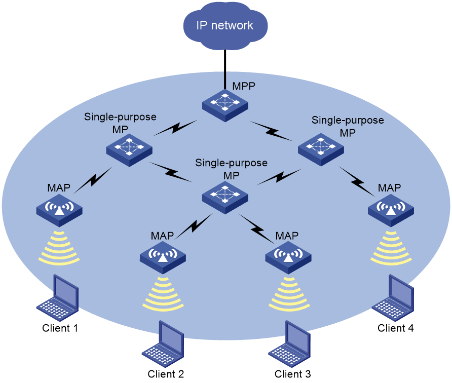

WLAN mesh network
Figure 1 shows a WLAN mesh network.
APs on a WLAN mesh network are mesh points (MPs). MPs play the following roles:
·     Single-purpose MP—Provides only mesh services.
·     Mesh access point (MAP)—Provides both mesh and access services.
·     Mesh portal point (MPP)—Provides a wired connection to a wired network.
Figure 1 WLAN mesh network diagram
