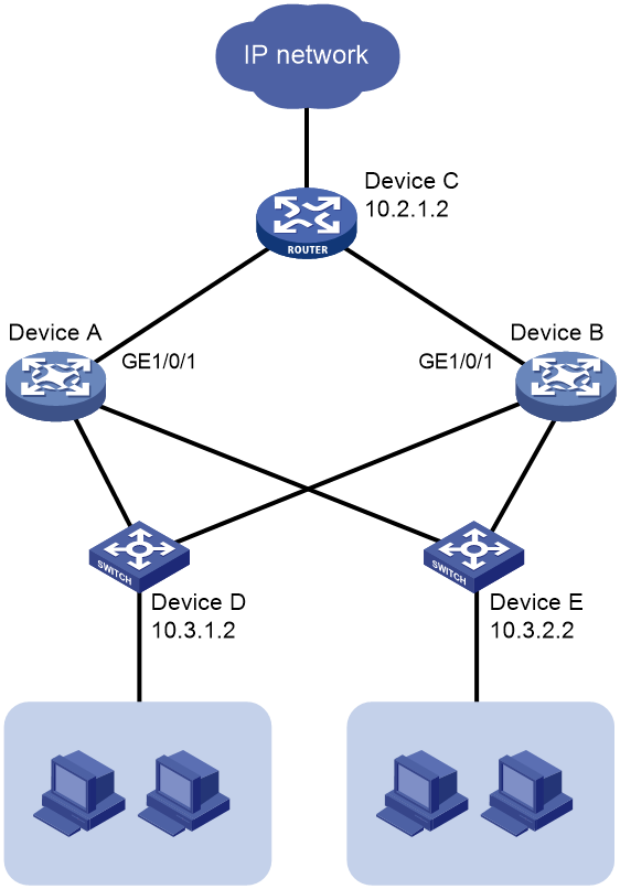

Embedded Automation Architecture (EAA) is a monitoring framework that enables you to self-define monitored events and actions to take in response to an event. It allows you to create monitor policies by using the CLI or Tcl scripts.
EAA framework
EAA framework includes a set of event sources, a set of event monitors, a real-time event manager (RTM), and a set of user-defined monitor policies, as shown in Figure 1.
Figure 1 EAA framework
Event sources
Event sources are software or hardware modules that trigger events (see Figure 1).
For example, the CLI module triggers an event when you enter a command. The Syslog module (the information center) triggers an event when it receives a log message.

Example: Configuring a track event monitor policy from the CLI
As shown in Figure 3, Device A has established BGP sessions with Device D and Device E. Traffic from Device D and Device E to the Internet is forwarded through Device A.
Configure a CLI-defined EAA monitor policy on Device A to disconnect the sessions with Device D and Device E when GigabitEthernet 1/0/1 connected to Device C is down. In this way, traffic from Device D and Device E to the Internet can be forwarded through Device B.
Figure 3 Network diagram
# Display BGP peer information for Device A.
<DeviceA> display bgp peer ipv4
 BGP local router ID: 1.1.1.1
 Local AS number: 100
 Total number of peers: 3                  Peers in established state: 3
  * - Dynamically created peer
  Peer                    AS  MsgRcvd  MsgSent OutQ PrefRcv Up/Down  State
  10.2.1.2                200       13       16    0       0 00:16:12 Established
  10.3.1.2                300       13       16    0       0 00:10:34 Established
  10.3.2.2                300       13       16    0       0 00:10:38 Established
# Create track entry 1 and associate it with the link state of GigabitEthernet 1/0/1.
<Device A> system-view
[Device A] track 1 interface gigabitethernet 1/0/1
# Configure a CLI-defined EAA monitor policy so that the system automatically disables session establishment with Device D and Device E when GigabitEthernet 1/0/1 is down.
[Device A] rtm cli-policy test
[Device A-rtm-test] event track 1 state negative
[Device A-rtm-test] action 0 cli system-view
[Device A-rtm-test] action 1 cli bgp 100
[Device A-rtm-test] action 2 cli peer 10.3.1.2 ignore
[Device A-rtm-test] action 3 cli peer 10.3.2.2 ignore
[Device A-rtm-test] user-role network-admin
[Device A-rtm-test] commit
[Device A-rtm-test] quit
# Shut down GigabitEthernet 1/0/1.
[Device A] interface gigabitethernet 1/0/1
[Device A-GigabitEthernet1/0/1] shutdown
# Execute the display bgp peer ipv4 command on Device A to display BGP peer information. If no BGP peer information is displayed, Device A does not have any BGP peers.
