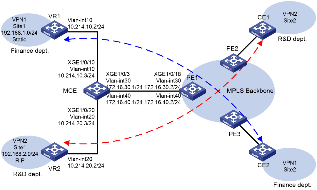

As shown in Figure 1, an enterprise has two MPLS L3VPNs. VPN 1 for the finance department uses static routes, and VPN 2 for the R&D department uses RIP routes. Site 1 of VPN 1 and Site 1 of VPN 2 are connected to the MPLS backbone through the same CE device (MCE). Site 2 of VPN 1 and Site 2 of VPN 2 are connected to the MPLS backbone through separate CEs (CE 1 and CE 2).
Configure the MCE to allow communication between the local and remote sites of the same VPN and isolate access between sites of different VPNs.
Configure the MCE and PE 1 to use OSPF to exchange VPN routes.
Figure 1 Network diagram

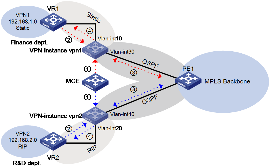

Figure 2 Network diagram
Follow these restrictions and guidelines when you configure the MCE to advertise VPN routes to the PE by using OSPF:
·     Associating an interface with a VPN instance by using the ip binding vpn-instance command deletes the IP address of the interface. You must reconfigure the interface's IP address after the association.
·     An OSPF process can belong to only one VPN instance, but a VPN instance can use multiple OSPF processes to advertise private routes. The OSPF processes in a VPN instance must have the same domain ID to ensure correct route advertisement.

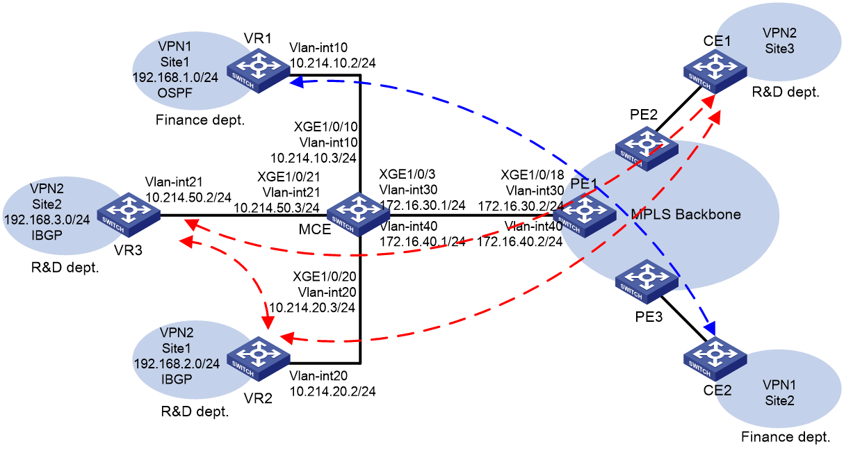

Example: Configuring the MCE to advertise VPN routes to the PE by using BGP
As shown in Figure 3, an enterprise has two MPLS L3VPNs. VPN 1 for the finance department uses OSPF, and VPN 2 for the R&D department uses IBGP. Site 1 of VPN 1, Site 2 of VPN 2, and Site 1 of VPN 2 are connected to the MPLS backbone through the same CE device (MCE). Site 3 of VPN 2 and Site 2 of VPN 1 are connected to the MPLS backbone through separate CEs (CE 1 and CE 2).
Configure the MCE and PE 1 to use BGP to exchange VPN routes.
Figure 3 Network diagram

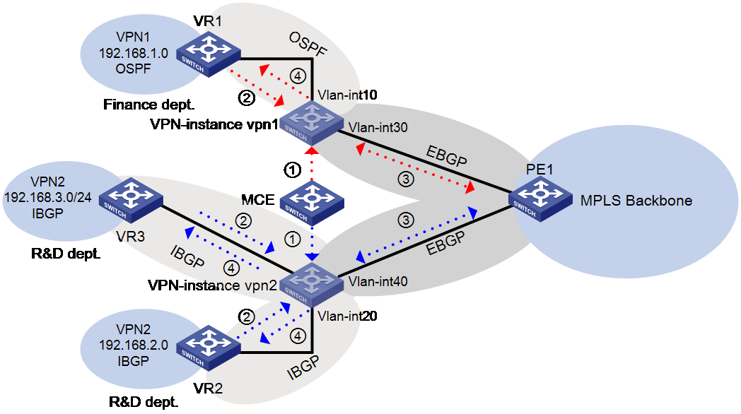

Analysis
To meet the network requirements, you must perform the following tasks:
1.     Create VPN instances on the MCE and PE 1, and bind each VPN instance to the interfaces that need to forward data for that VPN instance.
2.     Redistribute the VPN routes to the routing table of the corresponding VPN instance.
IBGP requires a fully meshed network or a router reflector. In this example, you must configure the MCE as the IBGP route reflector.
3.     Advertise the VPN routes to PE 1 through EBGP, and receive remote VPN routes from PE 1.
4.     Redistribute the remote VPN routes to the local VPN sites.

3.     Configure routing between the MCE and PE 1:
# On the MCE, create the BGP-VPN instance vpn1, and specify 172.16.30.2 (PE 1) as the EBGP peer in AS 200.
[MCE] bgp 100
[MCE-bgp-default] ip vpn-instance vpn1
[MCE-bgp-default-vpn1] peer 172.16.30.2 as-number 200
# Redistribute OSPF routes for BGP-VPN instance vpn1, and advertise network 172.16.30.0/24.
[MCE-bgp-default-vpn1] address-family ipv4
[MCE-bgp-default-ipv4-vpn1] import-route ospf
[MCE-bgp-default-ipv4-vpn1] peer 172.16.30.2 enable
[MCE-bgp-default-ipv4-vpn1] network 172.16.30.0 24
[MCE-bgp-default-ipv4-vpn1] quit
[MCE-bgp-default-vpn1] quit
# On PE 1, enter the view of the BGP-VPN instance vpn1, specify 172.16.30.1 (the MCE) as the EBGP peer in AS 100, and advertise network 172.16.30.0/24.
[PE1] bgp 200
[PE1-bgp-default] ip vpn-instance vpn1
[PE1-bgp-default-vpn1] peer 172.16.30.1 as-number 100
[PE1-bgp-default-vpn1] address-family ipv4
[PE1-bgp-default-ipv4-vpn1] peer 172.16.30.1 enable
[PE1-bgp-default-ipv4-vpn1] network 172.16.30.0 24
[PE1-bgp-default-ipv4-vpn1] quit
[PE1-bgp-default-vpn1] quit
# On the MCE, enter the view of the BGP-VPN instance vpn2, specify 172.16.40.2 (PE 1) as the EBGP peer in AS 200, and advertise network 172.16.40.0/24.
[MCE-bgp-default] ip vpn-instance vpn2
[MCE-bgp-default-vpn2] peer 172.16.40.2 as-number 200
[MCE-bgp-default-vpn2] address-family ipv4
[MCE-bgp-default-ipv4-vpn2] peer 172.16.40.2 enable
[MCE-bgp-default-ipv4-vpn2] network 172.16.40.0 24
[MCE-bgp-default-ipv4-vpn2] quit
[MCE-bgp-default-vpn2] quit
[MCE-bgp-default] quit
# On PE 1, enter the view of the BGP-VPN instance vpn2, specify 172.16.40.1 (the MCE) as the EBGP peer in AS 100, and advertise network 172.16.40.0/24.
[PE1-bgp-default] ip vpn-instance vpn2
[PE1-bgp-default-vpn2] peer 172.16.40.1 as-number 100
[PE1-bgp-default-vpn2] address-family ipv4
[PE1-bgp-default-ipv4-vpn2] peer 172.16.40.1 enable
[PE1-bgp-default-ipv4-vpn2] network 172.16.40.0 24
[PE1-bgp-default-ipv4-vpn2] quit
[PE1-bgp-default-vpn2] quit
[PE1-bgp-default] quit
# On PE 1, verify that the VPN instance vpn1 has learned the BGP route to VPN 1 site 1.
[PE1] display ip routing-table vpn-instance vpn1
Destinations : 5        Routes : 5
127.0.0.0/8         Direct 0    0            127.0.0.1       InLoop0
127.0.0.1/32        Direct 0    0            127.0.0.1       InLoop0
172.16.30.0/24      Direct 0    0            172.16.30.2     Vlan30
172.16.30.2/24      Direct 0    0            127.0.0.1       InLoop0
192.168.1.0/24      BGP    255  3            172.16.30.1     Vlan30
# On PE 1, verify that the VPN instance vpn2 has learned the BGP routes to the sites of VPN 2.
[PE1] display ip routing-table vpn-instance vpn2
Destinations : 16        Routes : 16
Destination/Mask   Proto   Pre Cost        NextHop         Interface
0.0.0.0/32         Direct  0   0           127.0.0.1       InLoop0
10.214.20.0/24     BGP     255 0           172.16.40.1     Vlan40
10.214.50.0/24     BGP     255 0           172.16.40.1     Vlan40
127.0.0.0/32       Direct  0   0           127.0.0.1       InLoop0
127.255.255.255/32 Direct  0   0           127.0.0.1       InLoop0
172.16.40.0/24     Direct  0   0           172.16.40.2     Vlan40
172.16.40.0/32     Direct  0   0           172.16.40.2     Vlan40
172.16.40.2/32     Direct  0   0           127.0.0.1       InLoop0
172.16.40.255/32   Direct  0   0           172.16.40.2     Vlan40
192.168.2.0/24     BGP     255 0           172.16.40.1     Vlan40
192.168.3.0/24     BGP     255 0           172.16.40.1     Vlan40
224.0.0.0/4        Direct  0   0           0.0.0.0         NULL0
224.0.0.0/24       Direct  0   0           0.0.0.0         NULL0
255.255.255.255/32 Direct  0   0           127.0.0.1       InLoop0
