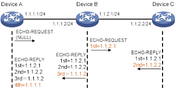

You can use the ping –r command to display the routers through which ICMP echo requests have passed. The test procedure of ping –r is as shown in Figure 1:
1.      The source device (Device A) sends an ICMP echo request to the destination device (Device C) with the RR option empty.
2.      The intermediate device (Device B) adds the IP address of its outbound interface (1.1.2.1) to the RR option of the ICMP echo request, and forwards the packet.
3.      Upon receiving the request, the destination device copies the RR option in the request and adds the IP address of its outbound interface (1.1.2.2) to the RR option. Then the destination device sends an ICMP echo reply.
4.      The intermediate device adds the IP address of its outbound interface (1.1.1.2) to the RR option in the ICMP echo reply, and then forwards the reply.
5.      Upon receiving the reply, the source device adds the IP address of its inbound interface (1.1.1.1) to the RR option. The detailed information of routes from Device A to Device C is formatted as: 1.1.1.1 <-> {1.1.1.2; 1.1.2.1} <-> 1.1.2.2.
Figure 1 Ping operation

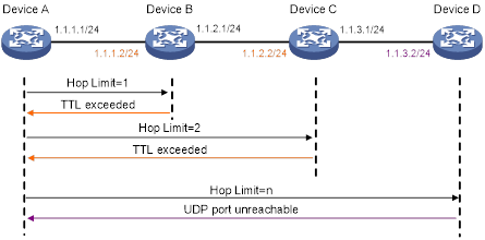

Tracert uses received ICMP error messages to get the IP addresses of devices. Tracert works as shown in Figure 2:
1.      The source device sends a UDP packet with a TTL value of 1 to the destination device. The destination UDP port is not used by any application on the destination device.
2.      The first hop (Device B, the first Layer 3 device that receives the packet) responds by sending a TTL-expired ICMP error message to the source, with its IP address (1.1.1.2) encapsulated. This way, the source device can get the address of the first Layer 3 device (1.1.1.2).
3.      The source device sends a packet with a TTL value of 2 to the destination device.
4.      The second hop (Device C) responds with a TTL-expired ICMP error message, which gives the source device the address of the second Layer 3 device (1.1.2.2).
5.      This process continues until a packet sent by the source device reaches the ultimate destination device. Because no application uses the destination port specified in the packet, the destination device responds with a port-unreachable ICMP message to the source device, with its IP address encapsulated. This way, the source device gets the IP address of the destination device (1.1.3.2).
6.      The source device determines that:
¡  The packet has reached the destination device after receiving the port-unreachable ICMP message.
¡  The path to the destination device is 1.1.1.2 to 1.1.2.2 to 1.1.3.2.

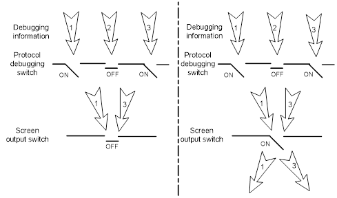

The following switches control the display of debugging information:
·           Module debugging switch—Controls whether to generate the module-specific debugging information.
·           Screen output switch—Controls whether to display the debugging information on a certain screen. Use the terminal monitor and terminal logging level commands to turn on the screen output switch. For more information about the commands, see information center commands in Network Management and Monitoring Command Reference.
As shown in Figure 3, the device can provide debugging for the three modules 1, 2, and 3. The debugging information can be output on a terminal only when both the module debugging switch and the screen output switch are turned on.
Debugging information is typically displayed on a console. You can also send debugging information to other destinations. For more information, see "Configuring the information center."
Figure 3 Relationship between the module and screen output switch
