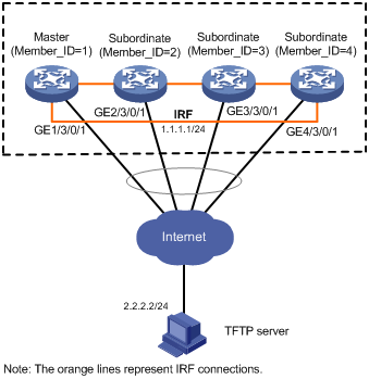

Performing an ISSU by using issu commands
Perform this task only on a multichassis IRF fabric.
Always start ISSU with a subordinate member.
When you use issu commands for an ISSU, you do not need to upgrade LPUs or switching fabric modules separately. They are upgraded automatically when MPUs are upgraded.
Performing a compatible upgrade
Step
Remarks
N/A
2.     Disable automatic rollback.
issu rollback-timer 0
By default, the automatic rollback timer is set to 45 minutes.
As a best practice, do not use the automatic rollback feature. This feature is complicated.
3.     Return to user view.
N/A
4.     Load the upgrade images as main startup software images on subordinate members.
·     Use .bin image files:
issu load file { boot filename | system filename | feature filename&<1-30> | patch filename&<1-16> } * chassis chassis-number [ reboot ]

Examples of using issu commands for ISSU on a dual-member IRF fabric
Feature upgrade to a compatible version
Upgrade requirements
As shown in Figure 1, the IRF fabric has two members. Each member has one active MPU (slot 6) and one standby MPU (slot 7).
Upgrade the boot, system, and feature images from T0001015 to T0001016. The two versions are compatible.
Figure 1 Network diagram
Upgrade procedure

Feature upgrade to an incompatible version
As shown in Figure 2, the IRF fabric has two members. Each member has one MPU in slot 6 (active MPU) and one MPU in slot 7 (standby MPU).
Upgrade the boot, system, and feature images from T0001015 to T0001017. The two versions are incompatible.
Figure 2 Network diagram
Upgrade procedure

Examples of using issu commands for ISSU on a four-member IRF fabric
As shown in Figure 3, the IRF fabric has four members. Each member has one active MPU (slot 6), one standby MPU (slot 7), and one LPU (slot 3).
Figure 3 Network diagram

Feature upgrade to an incompatible version (upgrading one subordinate member first)
As shown in Figure 4, the IRF fabric has four members. Each member has one active MPU (slot 6), one standby MPU (slot 7), and one LPU (slot 3).
Figure 4 Network diagram
Upgrade procedure
# Download the upgrade image files from the TFTP server.

Examples of using install commands for ISSU on an IRF fabric
Feature upgrade example
As shown in Figure 6, the IRF fabric has two members. Each member has one MPU in slot 6 (active MPU) and one MPU in slot 7 (standby MPU).
Upgrade the feature1 feature from R0201 to R0202. The two versions are compatible.
Figure 6 Network diagram
