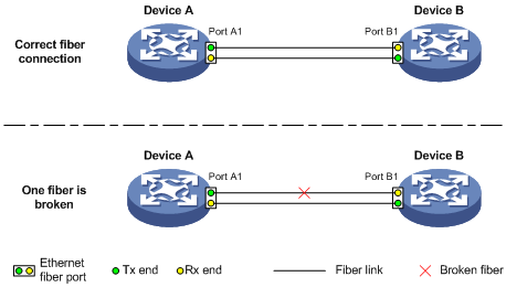

A link becomes unidirectional when only one end of the link can receive packets from the other end.
Unidirectional fiber links occur in the following cases:
·           Fibers are cross-connected.
·           A fiber is not connected at one end or one fiber of a fiber pair is broken.
Figure 1 shows a correct fiber connection and two types of unidirectional fiber connections.
When DLDP detects unidirectional links, it can automatically shut down the faulty port to avoid network problems. Alternatively, a user can manually shut down the faulty port.
Figure 1 Correct and incorrect fiber connections

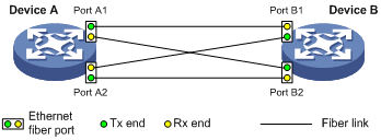

Figure 2 Cross-connected fibers
As shown in Figure 2, before you enable DLDP, the optical fibers between Device A and Device B are cross-connected. After you enable DLDP, the four ports are all up and in unidirectional state, and they send RecoverProbe packets. Take Port A1 as an example to illustrate the unidirectional link detection process.
a.    Port A1 receives the RecoverProbe packet from Port B2, and returns a RecoverEcho packet.
b.    Port B2 cannot receive any RecoverEcho packet from Port A1, so Port B2 cannot become the neighbor of Port A1.
c.    Port B1 can receive the RecoverEcho packet from Port A1, but Port B1 is not the intended destination, so Port B1 cannot become the neighbor of Port A1.
The same process occurs on the other three ports. The four ports are all in unidirectional state.

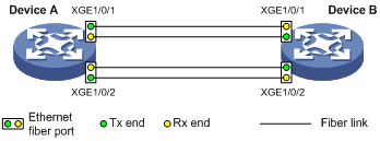

Example: Configuring the auto port shutdown mode
As shown in Figure 5, Device A and Device B are connected through two fiber pairs.
Configure DLDP to automatically shut down the faulty port upon detecting a unidirectional link, and automatically bring up the port after you clear the fault.
Figure 5 Network diagram
1.      Configure Device A:
# Enable DLDP globally.
<DeviceA> system-view
[DeviceA] dldp global enable
# Configure Ten-GigabitEthernet 1/0/1 to operate in full duplex mode and at 10000 Mbps, and enable DLDP on the port.
[DeviceA] interface ten-gigabitethernet 1/0/1
[DeviceA-Ten-GigabitEthernet1/0/1] duplex full
[DeviceA-Ten-GigabitEthernet1/0/1] speed 10000
[DeviceA-Ten-GigabitEthernet1/0/1] dldp enable
[DeviceA-Ten-GigabitEthernet1/0/1] quit
# Configure Ten-GigabitEthernet 1/0/2 to operate in full duplex mode and at 10000 Mbps, and enable DLDP on the port.
[DeviceA] interface ten-gigabitethernet 1/0/2
[DeviceA-Ten-GigabitEthernet1/0/2] duplex full
[DeviceA-Ten-GigabitEthernet1/0/2] speed 10000
[DeviceA-Ten-GigabitEthernet1/0/2] dldp enable
[DeviceA-Ten-GigabitEthernet1/0/2] quit

As shown in Figure 6, Device A and Device B are connected through two fiber pairs.
Configure DLDP to detect unidirectional links. When a unidirectional link is detected, the administrator must manually shut down the port.
Figure 6 Network diagram

<DeviceB> system-view
[DeviceB] dldp global enable
# Configure Ten-GigabitEthernet 1/0/1 to operate in full duplex mode and at 10000 Mbps, and enable DLDP on it.
[DeviceB] interface ten-gigabitethernet 1/0/1
[DeviceB-Ten-GigabitEthernet1/0/1] duplex full
[DeviceB-Ten-GigabitEthernet1/0/1] speed 10000
[DeviceB-Ten-GigabitEthernet1/0/1] dldp enable
[DeviceB-Ten-GigabitEthernet1/0/1] quit
# Configure Ten-GigabitEthernet 1/0/2 to operate in full duplex mode and at 10000 Mbps, and enable DLDP on it.
[DeviceB] interface ten-gigabitethernet 1/0/2
[DeviceB-Ten-GigabitEthernet1/0/2] duplex full
[DeviceB-Ten-GigabitEthernet1/0/2] speed 10000
[DeviceB-Ten-GigabitEthernet1/0/2] dldp enable
[DeviceB-Ten-GigabitEthernet1/0/2] quit
# Set the global port shutdown mode to hybrid.
[DeviceB] dldp unidirectional-shutdown hybrid
# Display the DLDP configuration globally and on all the DLDP-enabled ports of Device A.
[DeviceA] display dldp
 DLDP global status: Enabled
 DLDP advertisement interval: 5s
 DLDP authentication-mode: None
 DLDP unidirectional-shutdown mode: Hybrid
 DLDP delaydown-timer value: 1s
 Number of enabled ports: 2
Interface Ten-GigabitEthernet1/0/1
 DLDP port state: Bidirectional
 DLDP port unidirectional-shutdown mode: None
 DLDP initial-unidirectional-delay: 0s
 Number of the port’s neighbors: 1
  Neighbor MAC address: 0023-8956-3600
  Neighbor port index: 1
  Neighbor state: Confirmed
  Neighbor aged time: 11s
  Neighbor echo time: -
Interface Ten-GigabitEthernet1/0/2
  Neighbor port index: 2
  Neighbor aged time: 12s
The output shows that both Ten-GigabitEthernet 1/0/1 and Ten-GigabitEthernet 1/0/2 are in bidirectional state, which means both links are bidirectional.
# Enable the monitoring of logs on the current terminal on Device A. Set the lowest level of the logs that can be output to the current terminal to 6.
[DeviceA] quit
<DeviceA> terminal monitor
<DeviceA> terminal logging level 6
The following log information is displayed on Device A:
<DeviceA>%Jan  4 07:16:06:556 2011 DeviceA DLDP/5/DLDP_NEIGHBOR_AGED: A neighbor on interface
Ten-GigabitEthernet1/0/1 was deleted because the neighbor was aged. The neighbor's system MAC is 0023-8956-3600, and the port index is 162.
%Jan  4 07:16:06:560 2011 DeviceA DLDP/5/DLDP_NEIGHBOR_AGED: A neighbor on interface
Ten-GigabitEthernet1/0/2 was deleted because the neighbor was aged. The neighbor's system MAC is 0023-8956-3600, and the port index is 165.
%Jan  4 07:16:06:724 2011 DeviceA IFNET/3/PHY_UPDOWN: Physical state on the interface Ten-GigabitEthernet1/0/1 changed to down.
%Jan  4 07:16:06:730 2011 DeviceA IFNET/3/PHY_UPDOWN: Physical state on the interface Ten-GigabitEthernet1/0/2 changed to down.
%Jan  4 07:16:06:736 2011 DeviceA IFNET/5/LINK_UPDOWN: Line protocol state on the interface Ten-GigabitEthernet1/0/1 changed to down.
%Jan  4 07:16:06:738 2011 DeviceA IFNET/5/LINK_UPDOWN: Line protocol state on the interface Ten-GigabitEthernet1/0/2 changed to down.
%Jan  4 07:16:07:152 2011 DeviceA DLDP/3/DLDP_LINK_UNIDIRECTIONAL: DLDP detected a unidirectional link on interface Ten-GigabitEthernet1/0/1. DLDP automatically shut down the interface. Please manually bring up the interface.
%Jan  4 07:16:07:156 2011 DeviceA DLDP/3/DLDP_LINK_UNIDIRECTIONAL: DLDP detected a unidirectional link on interface Ten-GigabitEthernet1/0/2. DLDP automatically shut down the interface. Please manually bring up the interface.
The output shows that the port status and link status of both Ten-GigabitEthernet 1/0/1 and Ten-GigabitEthernet 1/0/2 are down.
# Display the DLDP configuration globally and of all the DLDP-enabled ports.
<DeviceA> display dldp
 DLDP port state: Inactive
 Number of the port's neighbors: 0 (Maximum number ever detected: 1)
The output shows that DLDP detects a unidirectional link and shuts down Ten-GigabitEthernet 1/0/1 and Ten-GigabitEthernet 1/0/2.
The unidirectional links are caused by cross-connected fibers. Bring up the two ports after correcting the fiber connection:
# Bring up Ten-GigabitEthernet 1/0/1.
[DeviceA-Ten-GigabitEthernet1/0/1] undo shutdown
[DeviceA-GigabitEthernet1/0/1]%Jan  4 07:33:26:574 2011 DeviceA IFNET/3/PHY_UPDOWN: Physical state on the interface GigabitEthernet1/0/1 changed to up.
%Jan  4 07:33:57:562 2011 DeviceA DLDP/6/DLDP_NEIGHBOR_CONFIRMED: A neighbor was confirmed on interface GigabitEthernet1/0/1. The neighbor's system MAC is 0023-8956-3600, and the port index is 162.
%Jan  4 07:33:57:563 2011 DeviceA DLDP/6/DLDP_LINK_BIDIRECTIONAL: DLDP detected a bidirectional link on interface GigabitEthernet1/0/1.
%Jan  4 07:33:57:590 2011 DeviceA IFNET/5/LINK_UPDOWN: Line protocol state on the interface GigabitEthernet1/0/1 changed to up.
%Jan  4 07:33:57:609 2011 DeviceA STP/6/STP_DETECTED_TC: Instance 0's port GigabitEthernet1/0/1 detected a topology change.
The output shows that the port status and link status of Ten-GigabitEthernet 1/0/1 are now up and its DLDP neighbors are determined.
# Bring up Ten-GigabitEthernet 1/0/2.
[DeviceA-Ten-GigabitEthernet1/0/2] undo shutdown
[DeviceA-Ten-GigabitEthernet1/0/2]%Jan  4 07:35:26:574 2011 DeviceA IFNET/3/PHY_UPDOWN: Physical state on the interface Ten-GigabitEthernet1/0/2 changed to up.
%Jan  4 07:35:57:562 2011 DeviceA DLDP/6/DLDP_NEIGHBOR_CONFIRMED: A neighbor was confirmed on interface Ten-GigabitEthernet1/0/2. The neighbor's system MAC is 0023-8956-3600, and the port index is 162.
%Jan  4 07:35:57:563 2011 DeviceA DLDP/6/DLDP_LINK_BIDIRECTIONAL: DLDP detected a bidirectional link on interface Ten-GigabitEthernet1/0/2.
%Jan  4 07:35:57:590 2011 DeviceA IFNET/5/LINK_UPDOWN: Line protocol state on the interface Ten-GigabitEthernet1/0/2 changed to up.
%Jan  4 07:35:57:609 2011 DeviceA STP/6/STP_DETECTED_TC: Instance 0's port Ten-GigabitEthernet1/0/2 detected a topology change.
The output shows that the port status and link status of Ten-GigabitEthernet 1/0/2 are now up and its DLDP neighbors are determined.
