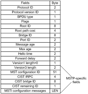

STP protocol frames
STP uses bridge protocol data units (BPDUs), also known as configuration messages, as its protocol frames. This chapter uses BPDUs to represent all types of spanning tree protocol frames.
STP-enabled devices exchange BPDUs to establish a spanning tree. BPDUs contain sufficient information for the devices to complete spanning tree calculation.
STP uses two types of BPDUs, configuration BPDUs and topology change notification (TCN) BPDUs.
Configuration BPDUs
Devices exchange configuration BPDUs to elect the root bridge and determine port roles. Figure 1 shows the configuration BPDU format.

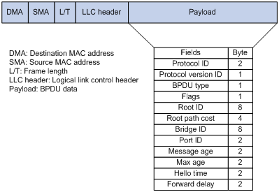

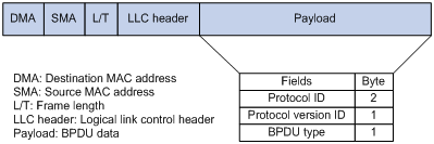

Figure 1 Configuration BPDU format
The payload of a configuration BPDU includes the following fields:
·           Protocol ID—Fixed at 0x0000, which represents IEEE 802.1d.
·           Protocol version ID—Spanning tree protocol version ID. The protocol version ID for STP is 0x00.
·           BPDU type—Type of the BPDU. The value is 0x00 for a configuration BPDU.
·           Flags—An 8-bit field indicates the purpose of the BPDU. The lowest bit is the Topology Change (TC) flag. The highest bit is the Topology Change Acknowledge (TCA) flag. All other bits are reserved.
·           Root ID—Root bridge ID formed by the priority and MAC address of the root bridge.
·           Root path cost—Cost of the path to the root bridge.
·           Bridge ID—Designated bridge ID formed by the priority and MAC address of the designated bridge.
·           Port ID—Designated port ID formed by the priority and global port number of the designated port.
·           Message age—Age of the configuration BPDU while it propagates in the network.
·           Max age—Maximum age of the configuration BPDU stored on the switch.
·           Hello time—Configuration BPDU transmission interval.
·           Forward delay—Delay for STP bridges to transit port state.
Devices use the root bridge ID, root path cost, designated bridge ID, designated port ID, message age, max age, hello time, and forward delay for spanning tree calculation.

RSTP protocol frames
An RSTP BPDU uses the same format as an STP BPDU except that a Version1 length field is added to the payload of RSTP BPDUs. The differences between an RSTP BPDU and an STP BPDU are as follows:
·           Protocol version ID—The value is 0x02 for RSTP.
·           BPDU type—The value is 0x02 for RSTP BPDUs.
·           Flags—All 8 bits are used.
·           Version1 length—The value is 0x00, which means no version 1 protocol information is present.

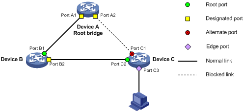

In addition to root port and designated port, RSTP also uses the following port roles:
·           Alternate port—Acts as the backup port for a root port. When the root port is blocked, the alternate port takes over.
·           Backup port—Acts as the backup port of a designated port. When the designated port is invalid, the backup port becomes the new designated port. A loop occurs when two ports of the same spanning tree device are connected, so the device blocks one of the ports. The blocked port is the backup port.
·           Edge port—Directly connects to a user host rather than a network device or network segment.

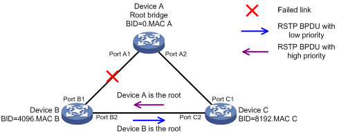

RSTP BPDU processing
In RSTP, a non-root bridge actively sends RSTP BPDUs at the hello time through designated ports without waiting for the root bridge to send RSTP BPDUs. This enables RSTP to quickly detect link failures. If a device fails to receive any RSTP BPDUs on a port within triple the hello time, the device considers that a link failure has occurred. After the stored configuration BPDU expires, the device floods RSTP BPDUs with the TC flag set to initiate a new RSTP calculation.
In RSTP, a port in blocking state can immediately respond to an RSTP BPDU with a lower priority than its own BPDU.

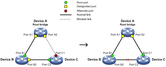

As shown in Figure 6, Device A is the root bridge. The priority of Device B is higher than the priority of Device C. Port C2 on Device C is blocked.
When the link between Device A and Device B fails, the following events occur:
1.      Device B sends an RSTP BPDU with itself as the root bridge to Device C.
2.      Device C compares the RSTP BPDU with its own BPDU.
3.      Because the RSTP BPDU from Device B has a lower priority, Device C sends its own BPDU to Device B.
4.      Device B considers that Port B2 is the root port and stops sending RSTP BPDUs to Device C.
Figure 6 BPDU processing in RSTP

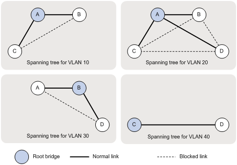

In an STP- or RSTP-enabled LAN, all bridges share one spanning tree. Traffic from all VLANs is forwarded along the spanning tree, and ports cannot be blocked on a per-VLAN basis to prune loops.
PVST allows every VLAN to have its own spanning tree, which increases usage of links and bandwidth. Because each VLAN runs RSTP independently, a spanning tree only serves its VLAN.

PVST implements per-VLAN spanning tree calculation by mapping each VLAN to an MSTI. In PVST, each VLAN runs RSTP independently to maintain its own spanning tree without affecting the spanning trees of other VLANs. In this way, loops in each VLAN are eliminated and traffic of different VLANs is load shared over links. PVST uses RSTP BPDUs in the default VLAN and PVST BPDUs in other VLANs for spanning tree calculation.

MSTP protocol frames
Figure 8 shows the format of an MSTP BPDU.
Figure 8 MSTP BPDU format
The first 13 fields of an MSTP BPDU are the same as an RSTP BPDU. The other six fields are unique to MSTP.
·           Protocol version ID—The value is 0x03 for MSTP.
·           BPDU type—The value is 0x02 for RSTP/MSTP BPDUs.
·           Root ID—ID of the common root bridge.
·           Root path cost—CIST external path cost.
·           Bridge ID—ID of the regional root for the IST or an MSTI.
·           Port ID—ID of the designated port in the CIST.
·           Version3 length—Length of the MSTP-specific fields. Devices use this field for verification upon receiving an MSTP BPDU.
·           MST configuration ID—Includes the format selector, configuration name, revision level, and configuration digest. The value for format selector is fixed at 0x00. The other parameters are used to identify the MST region for the originating bridge.
·           CIST IRPC—Internal root path cost (IRPC) from the originating bridge to the root of the MST region.
·           CIST bridge ID—ID of the bridge that sends the MSTP BPDU.
·           CIST remaining ID—Remaining hop count. This field limits the scale of the MST region. The regional root sends a BPDU with the remaining hop count set to the maximum value. Each device that receives the BPDU decrements the hop count by one. When the hop count reaches zero, the BPDU is discarded. Devices beyond the maximum hops of the MST region cannot participate in spanning tree calculation. The default remaining hop count is 20.
·           MSTI configuration messages—Contains MSTI configuration messages. Each MSTI configuration message is 16 bytes. This field can contain 0 to 64 MSTI configuration messages. The number of the MSTI configuration messages is determined by the number of MSTIs in the MST region.

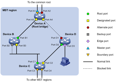

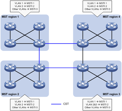

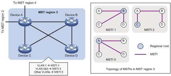

Figure 9 shows a switched network that contains four MST regions, each MST region containing four MSTP devices. Figure 10 shows the networking topology of MST region 3.
Figure 9 Basic concepts in MSTP
Figure 10 Network diagram and topology of MST region 3
MST region
A multiple spanning tree region (MST region) consists of multiple devices in a switched network and the network segments among them. All these devices have the following characteristics:
·           A spanning tree protocol enabled
·           Same region name
·           Same VLAN-to-instance mapping configuration
·           Same MSTP revision level
·           Physically linked together
Multiple MST regions can exist in a switched network. You can assign multiple devices to the same MST region, as shown in Figure 9.
·           The switched network contains four MST regions, MST region 1 through MST region 4.
·           All devices in each MST region have the same MST region configuration.
MSTI
MSTP can generate multiple independent spanning trees in an MST region, and each spanning tree is mapped to the specific VLANs. Each spanning tree is referred to as a multiple spanning tree instance (MSTI).
In Figure 10, MST region 3 contains three MSTIs, MSTI 1, MSTI 2, and MSTI 0.
VLAN-to-instance mapping table
As an attribute of an MST region, the VLAN-to-instance mapping table describes the mapping relationships between VLANs and MSTIs.
In Figure 10, the VLAN-to-instance mapping table of MST region 3 is as follows:
·           VLAN 1 to MSTI 1.
·           VLAN 2 and VLAN 3 to MSTI 2.
·           Other VLANs to MSTI 0.
MSTP achieves load balancing by means of the VLAN-to-instance mapping table.
CST
The common spanning tree (CST) is a single spanning tree that connects all MST regions in a switched network. If you regard each MST region as a device, the CST is a spanning tree calculated by these devices through STP or RSTP.
The blue lines in Figure 9 represent the CST.

Regional root
The root bridge of the IST or an MSTI within an MST region is the regional root of the IST or MSTI. Based on the topology, different spanning trees in an MST region might have different regional roots, as shown in MST region 3 in Figure 10.
·           The regional root of MSTI 1 is Device B.
·           The regional root of MSTI 2 is Device C.
·           The regional root of MSTI 0 (also known as the IST) is Device A.

Port roles
A port can play different roles in different MSTIs. As shown in Figure 11, an MST region contains Device A, Device B, Device C, and Device D. Port A1 and port A2 of Device A connect to the common root bridge. Port B2 and Port B3 of Device B form a loop. Port C3 and Port C4 of Device C connect to other MST regions. Port D3 of Device D directly connects to a host.
Figure 11 Port roles
MSTP calculation involves the following port roles:
·           Root port—Forwards data for a non-root bridge to the root bridge. The root bridge does not have any root port.
·           Designated port—Forwards data to the downstream network segment or device.
·           Alternate port—Acts as the backup port for a root port or master port. When the root port or master port is blocked, the alternate port takes over.
·           Backup port—Acts as the backup port of a designated port. When the designated port is invalid, the backup port becomes the new designated port. A loop occurs when two ports of the same spanning tree device are connected, so the device blocks one of the ports. The blocked port acts as the backup.
·           Master port—Acts as a port on the shortest path from the local MST region to the common root bridge. The master port is not always located on the regional root. It is a root port on the IST or CIST and still a master port on the other MSTIs.
·           Boundary port—Connects an MST region to another MST region or to an STP/RSTP-running device. In MSTP calculation, a boundary port's role on an MSTI is consistent with its role on the CIST. However, that is not true with master ports. A master port on MSTIs is a root port on the CIST.
Port states
In MSTP, a port can be in one of the following states:
·           Forwarding—The port receives and sends BPDUs, learns MAC addresses, and forwards user traffic.
·           Learning—The port receives and sends BPDUs, learns MAC addresses, but does not forward user traffic. Learning is an intermediate port state.
·           Discarding—The port receives and sends BPDUs, but does not learn MAC addresses or forward user traffic.
When in different MSTIs, a port can be in different states.
A port state is not exclusively associated with a port role. Table 6 lists the port states that each port role supports. (A check mark [√] indicates that the port supports this state, while a dash [—] indicates that the port does not support this state.)
Table 6 Port states that different port roles support
Port role (right)
Port state (below)
Root port/master port
Designated port
Alternate port
Backup port
Forwarding
Learning
Discarding

Edge port rapid transition
As shown in Figure 12, Port C3 is an edge port connected to a host. When a network topology change occurs, the port can immediately transit from the blocking state to the forwarding state because no loop will be caused.
Because a device cannot determine whether a port is directly connected to a terminal, you must manually configure the port as an edge port.
Figure 12 Edge port rapid transition
Root port rapid transition
When a root port is blocked, the bridge will elect the alternate port with the highest priority as the new root port. If the new root port's peer is in the forwarding state, the new root port immediately transits to the forwarding state.
As shown in Figure 13, Port C2 on Device C is a root port and Port C1 is an alternate port. When Port C2 transits to the blocking state, Port C1 is elected as the root port and immediately transits to the forwarding state.
Figure 13 Root port rapid transition

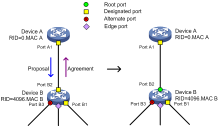

P/A transition
The P/A transition enables a designated port to rapidly transit to the forwarding state after a handshake with its peer. The P/A transition applies only to point-to-point links.
P/A transition for RSTP and PVST.
In RSTP or PVST, the ports on a new link or recovered link are designated ports in blocking state. When one of the designated ports transits to the discarding or learning state, it sets the proposal flag in its BPDU. Its peer bridge receives the BPDU and determines whether the receiving port is the root port. If it is the root port, the bridge blocks the other ports except edge ports. The bridge then replies an agreement BPDU to the designated port. The designated port immediately transits to the forwarding state upon receiving the agreement BPDU. If the designated port does not receive the agreement BPDU, it waits for twice the forward delay to transit to the forwarding state.
As shown in Figure 14, the P/A transition operates as follows:
1.      Device A sends a proposal BPDU to Device B through Port A1.
2.      Device B receives the proposal BPDU on Port B2. Port B2 is elected as the root port.
3.      Device B blocks its designated port Port B1 and alternate port Port B3 to eliminate loops.
4.      The root port Port B2 transits to the forwarding state and sends an agreement BPDU to Device A.
5.      The designated port Port A1 on Device A immediately transits to the forwarding state after receiving the agreement BPDU.
Figure 14 P/A transition for RSTP and PVST

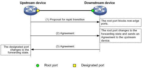

In MSTP, an upstream bridge sets both the proposal and agreement flags in its BPDU. If a downstream bridge receives the BPDU and its receiving port is elected as the root port, the bridge blocks all the other ports except edge ports. The downstream bridge then replies an agreement BPDU to the upstream bridge. The upstream port immediately transits to the forwarding state upon receiving the agreement BPDU. If the upstream port does not receive the agreement BPDU, it waits for twice the forward delay to transit to the forwarding state.
As shown in Figure 15, the P/A transition operates as follows:
1.      Device A sets the proposal and agreement flags in its BPDU and sends it to Device B through Port A1.
2.      Device B receives the BPDU. Port B1 of Device B is elected as the root port.
3.      Device B then blocks all its ports except the edge ports.
4.      The root port Port B1 of Device B transits to the forwarding state and sends an agreement BPDU to Device A.
5.      Port A1 of Device A immediately transits to the forwarding state upon receiving the agreement BPDU.
Figure 15 P/A transition for MSTP

¡  In PVST mode:
stp vlan vlan-id-list root primary

¡  In PVST mode:
stp vlan vlan-id-list priority priority

¡  In PVST mode:
stp vlan vlan-id-list bridge-diameter diameter

In RSTP and MSTP, the following types of messages are used for rapid state transition on designated ports:
·           Proposal—Sent by designated ports to request rapid transition
·           Agreement—Used to acknowledge rapid transition requests
Both RSTP and MSTP devices can perform rapid transition on a designated port only when the port receives an agreement packet from the downstream device. RSTP and MSTP devices have the following differences:
·           For MSTP, the root port of the downstream device sends an agreement packet only after it receives an agreement packet from the upstream device.
·           For RSTP, the downstream device sends an agreement packet whether or not an agreement packet from the upstream device is received.
Figure 16 Rapid state transition of an MSTP designated port
Figure 17 Rapid state transition of an RSTP designated port
If the upstream device is a third-party device, the rapid state transition implementation might be limited as follows:
·           The upstream device uses a rapid transition mechanism similar to that of RSTP.
·           The downstream device runs MSTP and does not operate in RSTP mode.
In this case, the following occurs:
1.      The root port on the downstream device receives no agreement from the upstream device.
2.      It sends no agreement to the upstream device.
As a result, the designated port of the upstream device can transit to the forwarding state only after a period twice the forward delay.
To enable the designated port of the upstream device to transit its state rapidly, enable No Agreement Check on the downstream device's port.

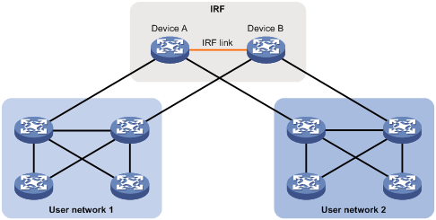

Configuring TC Snooping
About TC Snooping
As shown in Figure 18, an IRF fabric connects to two user networks through double links.
·           Device A and Device B form the IRF fabric.
·           The spanning tree feature is disabled on Device A and Device B and enabled on all devices in user network 1 and user network 2.
·           The IRF fabric transparently transmits BPDUs for both user networks and is not involved in the calculation of spanning trees.
When the network topology changes, it takes time for the IRF fabric to update its MAC address table and ARP table. During this period, traffic in the network might be interrupted.
Figure 18 TC Snooping application scenario
image14.emf
To avoid traffic interruption, you can enable TC Snooping on the IRF fabric. After receiving a TC-BPDU through a port, the IRF fabric updates MAC address table and ARP table entries associated with the port's VLAN. In this way, TC Snooping prevents topology change from interrupting traffic forwarding in the network. For more information about the MAC address table and the ARP table, see "Configuring the MAC address table" and Layer 3—IP Services Configuration Guide.
·           TC Snooping and the spanning tree feature are mutually exclusive. You must globally disable the spanning tree feature before enabling TC Snooping.
·           The priority of BPDU tunneling is higher than that of TC Snooping. When BPDU tunneling is enabled on a port, the TC Snooping feature does not take effect on the port.
·           TC Snooping does not support the PVST mode.

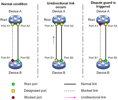

Disabling dispute guard
About dispute guard

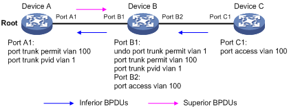

Dispute guard can be triggered by unidirectional link failures. If an upstream port receives inferior BPDUs from a downstream designated port in forwarding or learning state because of a unidirectional link failure, a loop appears. Dispute guard blocks the upstream designated port to prevent the loop.
As shown in Figure 19, in normal conditions, the spanning tree calculation result is as follows:
·           Device A is the root bridge, and Port A1 is a designated port.
·           Port B1 is blocked.
When the link between Port A1 and Port B1 fails in the direction of Port A1 to Port B1 and becomes unidirectional, the following events occur:
1.      Port A1 can only receive BPDUs and cannot send BPDUs to Port B1.
2.      Port B1 does not receive BPDUs from Port A1 for a certain period of time.
3.      Device B determines itself as the root bridge.
4.      Port B1 sends its BPDUs to Port A1.
5.      Port A1 determines the received BPDUs are inferior to its own BPDUs. A dispute is detected.
6.      Dispute guard is triggered and blocks Port A1 to prevent a loop.
Figure 19 Dispute guard triggering scenario
However, dispute guard might disrupt the network connectivity. You can disable dispute guard to avoid connectivity loss in VLAN networks. As shown in Figure 20, the spanning tree feature is disabled on Device B and enabled on Device A and device C. Device B transparently transmits BPDUs.
Device C cannot receive superior BPDUs of VLAN 1 from Device A because Port B1 of Device B is configured to deny packets of VLAN 1. Device C determines itself as the root bridge after a certain period of time. Then, Port C1 sends an inferior BPDU of VLAN 100 to Device A.
When Device A receives the inferior BPDU, dispute guard blocks Port A1, which causes traffic interruption. To ensure service continuity, you can disable dispute guard on Device A to prevent the link from being blocked.
Figure 20 Disabling dispute guard application scenario
You can disable dispute guard if the network does not have unidirectional link failures.
1.      Enter system view.
2.      Disable dispute guard.
undo stp dispute-protection
By default, dispute guard is enabled.

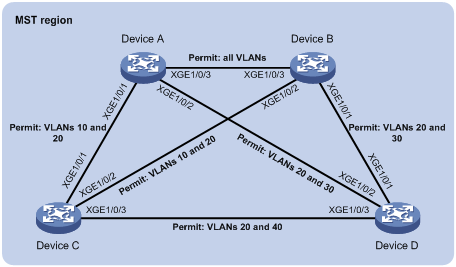

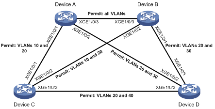

Example: Configuring MSTP
As shown in Figure 21, all devices on the network are in the same MST region. Device A and Device B work at the distribution layer. Device C and Device D work at the access layer.
Configure MSTP so that frames of different VLANs are forwarded along different spanning trees.
·           VLAN 10 frames are forwarded along MSTI 1.
·           VLAN 30 frames are forwarded along MSTI 3.
·           VLAN 40 frames are forwarded along MSTI 4.
·           VLAN 20 frames are forwarded along MSTI 0.
VLAN 10 and VLAN 30 are terminated on the distribution layer devices, and VLAN 40 is terminated on the access layer devices. The root bridges of MSTI 1 and MSTI 3 are Device A and Device B, respectively, and the root bridge of MSTI 4 is Device C.
Figure 21 Network diagram
1.      Configure VLANs and VLAN member ports. (Details not shown.)
¡  Create VLAN 10, VLAN 20, and VLAN 30 on both Device A and Device B.
¡  Create VLAN 10, VLAN 20, and VLAN 40 on Device C.
¡  Create VLAN 20, VLAN 30, and VLAN 40 on Device D.
¡  Configure the ports on these devices as trunk ports and assign them to related VLANs.
2.      Configure Device A:
# Enter MST region view, and configure the MST region name as example.
<DeviceA> system-view
[DeviceA] stp region-configuration
[DeviceA-mst-region] region-name example
# Map VLAN 10, VLAN 30, and VLAN 40 to MSTI 1, MSTI 3, and MSTI 4, respectively.
[DeviceA-mst-region] instance 1 vlan 10
[DeviceA-mst-region] instance 3 vlan 30
[DeviceA-mst-region] instance 4 vlan 40
# Configure the revision level of the MST region as 0.
[DeviceA-mst-region] revision-level 0
# Activate MST region configuration.
[DeviceA-mst-region] active region-configuration

# Configure the Device A as the root bridge of MSTI 1.
[DeviceA] stp instance 1 root primary
# Enable the spanning tree feature globally.
[DeviceA] stp global enable
3.      Configure Device B:
<DeviceB> system-view
[DeviceB] stp region-configuration
[DeviceB-mst-region] region-name example
[DeviceB-mst-region] instance 1 vlan 10
[DeviceB-mst-region] instance 3 vlan 30
[DeviceB-mst-region] instance 4 vlan 40
[DeviceB-mst-region] revision-level 0
[DeviceB-mst-region] active region-configuration
[DeviceB-mst-region] quit
# Configure Device B as the root bridge of MSTI 3.
[DeviceB] stp instance 3 root primary
[DeviceB] stp global enable
4.      Configure Device C:
<DeviceC> system-view
[DeviceC] stp region-configuration
[DeviceC-mst-region] region-name example
[DeviceC-mst-region] instance 1 vlan 10
[DeviceC-mst-region] instance 3 vlan 30
[DeviceC-mst-region] instance 4 vlan 40
[DeviceC-mst-region] revision-level 0
[DeviceC-mst-region] active region-configuration
[DeviceC-mst-region] quit
# Configure the Device C as the root bridge of MSTI 4.
[DeviceC] stp instance 4 root primary
[DeviceC] stp global enable
5.      Configure Device D:
<DeviceD> system-view
[DeviceD] stp region-configuration
[DeviceD-mst-region] region-name example
[DeviceD-mst-region] instance 1 vlan 10
[DeviceD-mst-region] instance 3 vlan 30
[DeviceD-mst-region] instance 4 vlan 40
[DeviceD-mst-region] revision-level 0
[DeviceD-mst-region] active region-configuration
[DeviceD-mst-region] quit
[DeviceD] stp global enable
In this example, Device B has the lowest root bridge ID. As a result, Device B is elected as the root bridge in MSTI 0.
When the network is stable, you can use the display stp brief command to display brief spanning tree information on each device.
# Display brief spanning tree information on Device A.
[DeviceA] display stp brief
 MST ID      Port                         Role  STP State     Protection
 0           Ten-GigabitEthernet1/0/1     ALTE  DISCARDING    NONE
 0           Ten-GigabitEthernet1/0/2     DESI  FORWARDING    NONE
 0           Ten-GigabitEthernet1/0/3     ROOT  FORWARDING    NONE
 1           Ten-GigabitEthernet1/0/1     DESI  FORWARDING    NONE
 1           Ten-GigabitEthernet1/0/3     DESI  FORWARDING    NONE
 3           Ten-GigabitEthernet1/0/2     DESI  FORWARDING    NONE
 3           Ten-GigabitEthernet1/0/3     ROOT  FORWARDING    NONE
# Display brief spanning tree information on Device B.
[DeviceB] display stp brief
 0           Ten-GigabitEthernet1/0/1     DESI  FORWARDING    NONE
 0           Ten-GigabitEthernet1/0/3     DESI  FORWARDING    NONE
 1           Ten-GigabitEthernet1/0/2     DESI  FORWARDING    NONE
 1           Ten-GigabitEthernet1/0/3     ROOT  FORWARDING    NONE
 3           Ten-GigabitEthernet1/0/1     DESI  FORWARDING    NONE
 3           Ten-GigabitEthernet1/0/3     DESI  FORWARDING    NONE
# Display brief spanning tree information on Device C.
[DeviceC] display stp brief
 0           Ten-GigabitEthernet1/0/2     ROOT  FORWARDING    NONE
 1           Ten-GigabitEthernet1/0/1     ROOT  FORWARDING    NONE
 1           Ten-GigabitEthernet1/0/2     ALTE  DISCARDING    NONE
 4           Ten-GigabitEthernet1/0/3     DESI  FORWARDING    NONE
# Display brief spanning tree information on Device D.
[DeviceD] display stp brief
 0           Ten-GigabitEthernet1/0/1     ROOT  FORWARDING    NONE
 0           Ten-GigabitEthernet1/0/2     ALTE  DISCARDING    NONE
 0           Ten-GigabitEthernet1/0/3     ALTE  DISCARDING    NONE
 3           Ten-GigabitEthernet1/0/1     ROOT  FORWARDING    NONE
 3           Ten-GigabitEthernet1/0/2     ALTE  DISCARDING    NONE
 4           Ten-GigabitEthernet1/0/3     ROOT  FORWARDING    NONE
Based on the output, you can draw each MSTI mapped to each VLAN, as shown in Figure 22.
Figure 22 MSTIs mapped to different VLANs
Example: Configuring PVST
As shown in Figure 23, Device A and Device B work at the distribution layer, and Device C and Device D work at the access layer.
Configure PVST to meet the following requirements:
·           Frames of a VLAN are forwarded along the spanning trees of the VLAN.
·           VLAN 10, VLAN 20, and VLAN 30 are terminated on the distribution layer devices, and VLAN 40 is terminated on the access layer devices.
·           The root bridge of VLAN 10 and VLAN 20 is Device A.
·           The root bridge of VLAN 30 is Device B.
·           The root bridge of VLAN 40 is Device C.
Figure 23 Network diagram
 VLAN ID     Port                         Role  STP State     Protection
 10          Ten-GigabitEthernet1/0/1     DESI  FORWARDING    NONE
 10          Ten-GigabitEthernet1/0/3     DESI  FORWARDING    NONE
 20          Ten-GigabitEthernet1/0/1     DESI  FORWARDING    NONE
 20          Ten-GigabitEthernet1/0/2     DESI  FORWARDING    NONE
 20          Ten-GigabitEthernet1/0/3     DESI  FORWARDING    NONE
 30          Ten-GigabitEthernet1/0/2     DESI  FORWARDING    NONE
 30          Ten-GigabitEthernet1/0/3     ROOT  FORWARDING    NONE
 10          Ten-GigabitEthernet1/0/2     DESI  FORWARDING    NONE
 10          Ten-GigabitEthernet1/0/3     ROOT  FORWARDING    NONE
 20          Ten-GigabitEthernet1/0/3     ROOT  FORWARDING    NONE
 30          Ten-GigabitEthernet1/0/1     DESI  FORWARDING    NONE
 30          Ten-GigabitEthernet1/0/3     DESI  FORWARDING    NONE
 10          Ten-GigabitEthernet1/0/1     ROOT  FORWARDING    NONE
 10          Ten-GigabitEthernet1/0/2     ALTE  DISCARDING    NONE
 20          Ten-GigabitEthernet1/0/1     ROOT  FORWARDING    NONE
 20          Ten-GigabitEthernet1/0/2     ALTE  DISCARDING    NONE
 40          Ten-GigabitEthernet1/0/3     DESI  FORWARDING    NONE
 20          Ten-GigabitEthernet1/0/1     ALTE  DISCARDING    NONE
 20          Ten-GigabitEthernet1/0/2     ROOT  FORWARDING    NONE
 20          Ten-GigabitEthernet1/0/3     ALTE  DISCARDING    NONE
 30          Ten-GigabitEthernet1/0/1     ROOT  FORWARDING    NONE
 30          Ten-GigabitEthernet1/0/2     ALTE  DISCARDING    NONE
 40          Ten-GigabitEthernet1/0/3     ROOT  FORWARDING    NONE
Based on the output, you can draw a topology for each VLAN spanning tree, as shown in Figure 24.
Figure 24 VLAN spanning tree topologies
