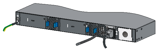

Grounding the switch· 10
Grounding the switch with a grounding strip· 10
Grounding the switch with a grounding conductor buried in the earth ground· 12

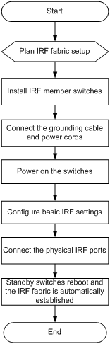

Setting up an IRF fabric· 27
IRF fabric setup flowchart 27

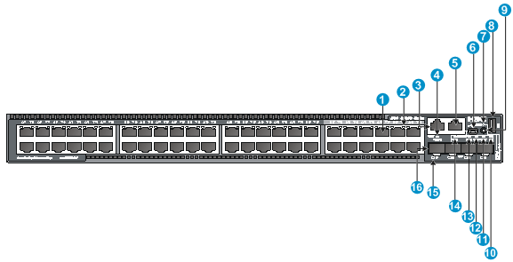

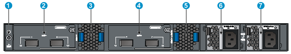

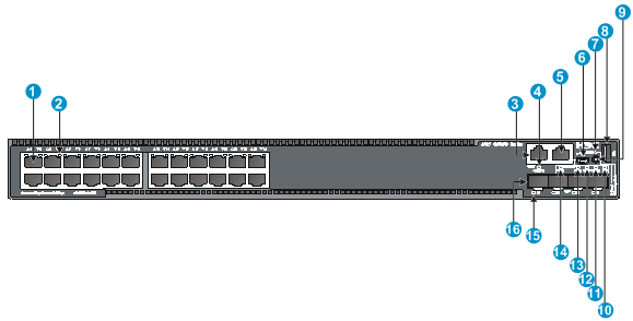

Appendix A Chassis views and technical specifications· 36
Chassis views· 36
S5800-32C-EI 36
S5800-56C-EI/S5800-56C-EI-M·· 38
Technical specifications· 39

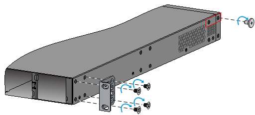

Rack-mounting by using the front and rear mounting brackets
You can install the front mounting brackets at the port-side or power-side mounting position as needed. The following takes power-side mounting as an example. The port-side mounting is similar.
This task requires two people.
To install the switch in a 19-inch rack by using the front and rear mounting brackets:
1.        Wear an ESD wrist strap and make sure it makes good skin contact and is reliably grounded.
2.        Attach the front mounting brackets and shoulder screws to the chassis:
a.    Align the round holes in the wide flange of one front mounting bracket with the screw holes in the power-side mounting position on one side of the chassis.
b.    Use M4 screws to attach the mounting bracket to the chassis.
c.    Repeat the proceeding two steps to attach the other mounting bracket to the chassis.
d.    Unpack the shoulder screws (provided). Attach the shoulder screw to one of the two installation positions as red-marked in Figure 5.
e.    Repeat the proceeding step to attach the other shoulder screw to the chassis.
Figure 5 Attaching the front mounting brackets and shoulder screws to the chassis

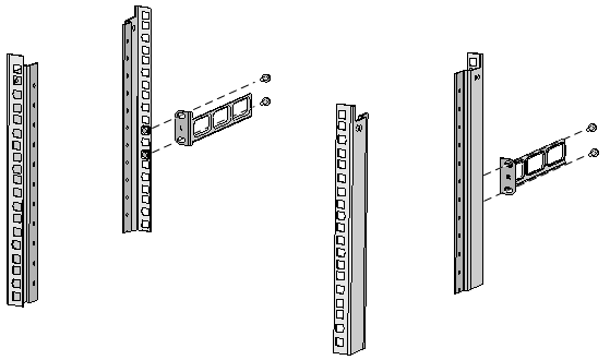

3.        Attach the rear mounting brackets to the rack:
a.    Determine to orient the brackets with the wide flange inside or outside the rack.
b.    Install cage nuts (user-supplied) in the mounting holes in the rear rack posts. Make sure the corresponding cage nuts on the left and right rear rack posts are at the same height.
c.    Attach the rear mounting brackets to the rear posts with M6 screws (user-supplied).
Do not fully fasten the M6 screws before mounting the switch in the rack.
Figure 6 Attaching the rear mounting brackets to the rack with the wide flange inside the rack
Figure 7 Attaching the rear mounting brackets to the rack with the wide flange outside the rack

·      Avoid placing heavy objects on the switch.
To mount the switch on a workbench:
1.        Verify that the workbench is sturdy and correctly grounded.
2.        Place the switch with bottom up, and clean the round holes in the chassis bottom with dry cloth.
3.        Attach the rubber feet to the four round holes in the chassis bottom.
4.        Place the switch with upside up on the workbench.

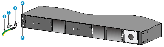

Connecting the grounding cable to the chassis
1.        Remove the grounding screw from the rear panel of the chassis.
2.        Use the grounding screw to attach the ring terminal of the grounding cable to the grounding screw hole. Fasten the screw.
IMPORTANT
IMPORTANT:
Orient the grounding cable as shown in Figure 10 so you can easily install or remove the expansion card.
Figure 10 Connecting the grounding cable to the chassis
(1) Grounding cable
(2) Grounding screw
(3) Ring terminal
(4) Grounding sign
(5) Grounding hole

Installing/removing a fan tray
CAUTION
CAUTION:
·      Install two fan trays of the same model on the switch. Do not power on the switch when it does not have fan trays or has only one fan tray installed.
·      Make sure slots are installed with fan trays or blank filler panels for the device to operate.
·      If both fan trays fail during operation, replace them within 2 minutes while the switch is operating.
·      If one fan tray fails, perform either of the following tasks:
¡  If the ambient temperature is not higher than 27°C (80.6°F), replace the fan tray within 24 hours and make sure the failed fan tray is in position before the replacement.
¡  If the ambient temperature is higher than 27°C (80.6°F), replace the fan tray immediately.

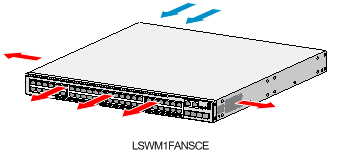

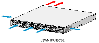

The switch comes with empty fan tray slots. Choose the fan tray models based on the ventilation requirement of the site. The air flow direction varies by fan tray model.
·          The LSWM1FANSCE has a blue handle and provides power-to-port air flow.
·          The LSWM1FANSCBE has a red handle and provides port-to-power air flow.
For more information about the fan trays, see "Appendix B FRUs and compatibility matrixes."

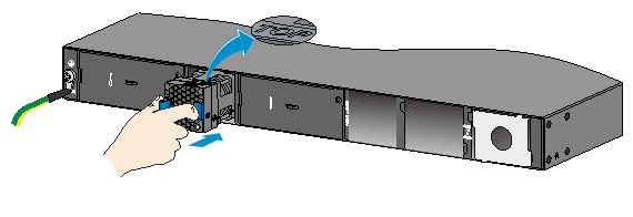

Installing a fan tray
To install a fan tray:
1.        Wear an ESD wrist strap and make sure it makes good skin contact and is correctly grounded.
2.        Unpack the fan tray and verify that the fan tray model is correct.
3.        Grasp the two handles of the fan tray with the side marked TOP facing up, and slide the fan tray into the slot until the fan tray seats in the slot and has a firm contact with the component connectors of the switch.
To prevent damage to the fan tray or the component connectors of the switch, insert the fan tray gently. If you encounter a hard resistance while inserting the fan tray, pull out the fan tray and insert it again.
Figure 14 Installing a fan tray

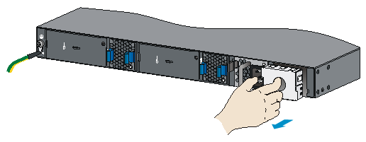

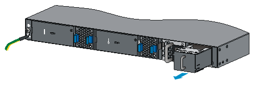

Removing a power module
2.        Switch off the circuit breaker at the power input end.
3.        Loosen the cable tie, and remove the power cord.
When removing a DC power cord, squeeze the tabs on the power cord connector with your thumb and forefinger and then pull the connector out.
Figure 21 Removing a DC power cord ( LSVM1DC300 DC power module)
(1) Squeeze the tabs on the power cord connector
(2) Pull the connector out
4.        Grasping the handle of the power module with one hand and using the thumb to press the latch towards the handle, pull the power module at the same time. After pulling the power module part-way out, hold the bottom of the power module with the other hand, and pull the power module slowly out of the slot along the guide rails.
Keep the removed power module in an antistatic bag or the power module package bag for future use.
5.        If you are not to install a power module, install the filler panel in the slot to prevent dust and ensure good ventilation.

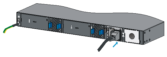

Connecting the power cord
CAUTION
CAUTION:
·      Provide a circuit breaker for each power cord.
·      Before connecting a power cord, make sure the circuit breaker on the power cord is turned off.
Connect the LSVM1AC300 power module to the AC power source. Connect the LSVM1DC300 power module to the –48 VDC power source.
Connecting the power cord for the LSVM1AC300 power module
2.        Connect the female connector of the AC power cord to the AC input socket on the power module.
Figure 22 Connecting the AC power cord to the LSVM1AC300 power module
3.        Use a cable tie to secure the AC power cord to the handle of the power module.
Figure 23 Securing the AC power cord with a cable tie (1)
Figure 24 Securing the AC power cord with a cable tie (2)
4.        Connect the other end of the power cord to an AC power source and turn on the circuit breaker.

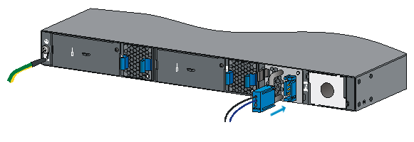

Connecting the power cord for the LSVM1DC300 power module
WARNING
WARNING!
·      H3C DC power cords are required if the –48 VDC power source is used.
·      Identify the positive (+) and negative (-) marks on the two wires to avoid connection mistakes.
To connect the power cord for the LSVM1DC300 power module:
2.        Correctly orient the female connector of the cable with the power receptacle on the power module, and insert the connector into the power receptacle. See callout 1 in Figure 25.
If you cannot insert the connector into the receptacle, re-orient the connector rather than use excessive force to push it in.
3.        Use a cable tie to secure the DC power cord to the handle on the power module.
4.        Connect the other end of the power cord to a –48 VDC power source.
Figure 25 Connecting the DC power cord to the LSVM1DC300 power module

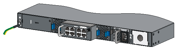

Installing/removing an expansion card
CAUTION
CAUTION:
·      Do not touch the surface-mounted components directly with your hands.
·      Do not use excessive force when you install or remove an expansion card.
·      You can install or remove an expansion card during normal operation of the switch except when the switch is starting up.
The switch has two expansion slots. For the expansion cards available for the switches, see "Appendix B FRUs and compatibility matrixes."
This section uses the LSWM2QP2P (with an ejector lever) and LSWM2XGT8PM (without an ejector lever) interface cards as examples to describe the procedures of installing and removing an expansion card.
Installing an expansion card
2.        Use a Phillips screwdriver to remove the mounting screw on the filler panel over the expansion slot. Then remove the filler panel.
Keep the filler panel for future use.
Figure 26 Removing the filler panel over an expansion slot
3.        Unpack the expansion card.
4.        If the expansion card has an ejector lever, follow these steps to install it:
a.    Rotate out the ejector lever, as shown by callout 1 in Figure 27.
b.    Gently push the expansion card into the slot along the guide rails until the expansion card has good contact with the chassis. See callout 2 in Figure 27.
c.    Rotate in the ejector lever, as shown by callout 3 in Figure 27.
d.    Use a Phillips screwdriver to tighten the captive screw on the expansion card to secure it in the slot. See callout 4 in Figure 27.
5.        If the expansion card does not have an ejector lever, follow these steps to install it:
a.    Gently push the expansion card into the slot along the guide rails until the expansion card has good contact with the chassis. See callout 1 Figure 28.
b.    Use a Phillips screwdriver to tighten the captive screw on the expansion card to secure it in the slot. See callout 2 Figure 28.
Figure 27 Installing an expansion card with an ejector lever (LSWM2QP2P)
Figure 28 Installing an expansion card without an ejector lever (LSWM2XGT8PM)
Figure 29 LSWM2XGT8PM card installed in the switch

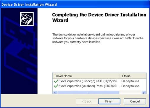

4.        Select a driver program according to the operating system you use:
¡  XR21V1410_XR21B1411_Windows_Ver1840_x86_Installer.EXE—32-bit operating system.
¡  XR21V1410_XR21B1411_Windows_Ver1840_x64_Installer.EXE—64-bit operating system.

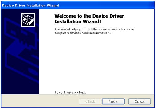

5.        Click Next on the installation wizard.
Figure 32 Device Driver Installation Wizard

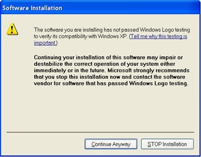

6.        Click Continue Anyway if the following dialog box appears.
Figure 33 Software Installation
7.        Click Finish.
Figure 34 Completing the device driver installation wizard
Figure 35 IRF fabric setup flowchart
To set up an IRF fabric:
Step
Description
1.       Plan IRF fabric setup
Plan the installation site and IRF fabric setup parameters:
·         Planning IRF fabric size and the installation site
·         Identifying the master switch and planning IRF member IDs
·         Planning IRF topology and connections
·         Identifying physical IRF ports on the member switches
·         Planning the cabling scheme
2.       Install IRF member switches
See "Installing the switch in a 19-inch rack" or "Mounting the switch on a workbench."
3.       Connect ground wires and power cords
See "Grounding the switch" and "Connecting the power cord."
4.       Power on the switches
N/A
5.       Configure basic IRF settings
See H3C S5800-EI Switch Series IRF Configuration Guide.
6.       Connect the physical IRF ports
Connect physical IRF ports on switches. Use SFP+/QSFP+ transceiver modules and fibers to connect 10-Gigabit SFP+ ports/40-Gigabit QSFP+ ports over a long distance, or use SFP+/QSFP+ cables to connect 10-Gigabit SFP+ ports/40-Gigabit QSFP+ ports over a short distance.
All switches except the master switch automatically reboot, and the IRF fabric is established.

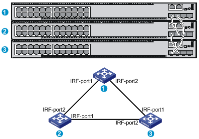

You can create an IRF fabric in daisy chain topology or more reliable ring topology. In ring topology, the failure of one IRF link does not cause the IRF fabric to split as in daisy chain topology. Instead, the IRF fabric changes to a daisy chain topology without interrupting network services.
You connect the IRF member switches through IRF ports, the logical interfaces for the connections between IRF member switches. Each IRF member switch has two IRF ports: IRF-port 1 and IRF-port 2. To use an IRF port, you must bind a minimum of one physical port to it.
When connecting two neighboring IRF member switches, you must connect the physical ports of IRF-port 1 on one switch to the physical ports of IRF-port 2 on the other switch.
The S5800-EI switches can provide 10-GE IRF connections through SFP+ ports and 40-GE IRF connections through QSFP+ ports, and you can bind several SFP+/QSFP+ ports to an IRF port for increased bandwidth and availability.
Figure 36 and Figure 37 show the topologies of an IRF fabric made up of three S5800-32C-EI switches. The IRF port connections in the two figures are for illustration only, and more connection methods are available.
Figure 36 IRF fabric in daisy chain topology
Figure 37 IRF fabric in ring topology

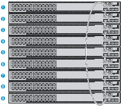

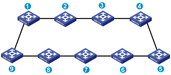

Connecting the IRF member switches in one rack
Use SFP+ cables to connect the IRF member switches (9 switches in this example) in a rack as shown in Figure 38. The switches in the ring topology (see Figure 39) are in the same order as connected in the rack.
Figure 38 Connecting the switches in one rack
Figure 39 IRF fabric topology

Figure 41 S5800-32C-EI front panel
(1) 10/100/1000BASE-T autosensing Ethernet port
(2) 10/100/1000BASE-T autosensing Ethernet port LED
(3) Management Ethernet port
(4) Management Ethernet port LED (ACT/LINK)
(5) Serial console port (CONSOLE)
(6) Mini USB console port
(7) LED for the port LED mode (MODE)
(8) USB port
(9) Port LED mode switching button
(10) System status LED (SYS)
(11) Expansion slot 2 LED (SLOT2)
(12) Expansion slot 1 LED (SLOT1)
(13) Power module slot 2 LED (PWR2)
(14) Power module slot 1 LED (PWR1)
(15) SFP+ port LED
(16) SFP+ port
Figure 42 S5800-32C-EI rear panel
(1) Grounding screw
(2) Expansion card 1
(3) Fan tray 1
(4) Expansion card 2
(5) Fan tray 2
(6) Power module 1
(7) Power module 2
The S5800-32C-EI switch comes with power module slot 1 (PWR1) empty and power module slot 2 (PWR2) installed with a filler panel. You can install one or two power modules for the switch as required. In Figure 42, two LSVM1AC300-AC power modules are installed in the power module slots. For more information about installing and removing a power module, see "Installing/removing a power module."
The S5800-32C-EI switch comes with the two fan tray slots empty. You must install two fan trays of the same model for the switch. In Figure 42, two LSWM1FANSCE fan trays are installed in the fan tray slots. For more information about installing and removing a fan tray, see "Installing/removing a fan tray."
The S5800-32C-EI switch comes with a filler panel in each expansion slot. You can select expansion cards for the switch as required. In Figure 42, two LSWM2QP2P interface cards are installed in the expansion slots. For more information about installing and removing an expansion card, see "Installing/removing an expansion card."

Figure 43 S5800-56C-EI/S5800-56C-EI-M front panel
(8) USB port
(15) SFP+ port LED
(16) SFP+ port
Figure 44 S5800-56C-EI/S5800-56C-EI-M rear panel
(1) Grounding screw
(3) Fan tray 1
(5) Fan tray 2
(6) Power module 1
(7) Power module 2
The S5800-56C-EI and S5800-56C-EI-M switches each comes with power module slot 1 (PWR1) empty and power module slot 2 (PWR2) installed with a filler panel. You can install one or two power modules for the switch as required. In Figure 44, two LSVM1AC300 AC power modules are installed in the power module slots. For more information about installing and removing a power module, see "Installing/removing a power module."
The S5800-56C-EI and S5800-56C-EI-M switches each come with the two fan tray slots empty. You must install two fan trays of the same model for the switch. In Figure 44, two LSWM1FANSCE fan trays are installed in the fan tray slots. For more information about installing and removing a fan tray, see "Installing/removing a fan tray."
The S5800-56C-EI and S5800-56C-EI-M switches each come with a filler panel in each expansion slot. You can select expansion cards for the switch as required. In Figure 44, two LSWM2QP2P interface cards are installed in the expansion slots. For more information about installing and removing an expansion card, see "Installing/removing an expansion card."

·         LSWM1FANSCE: From the power module side to the port side
·         LSWM1FANSCBE: From the port side to the power module side

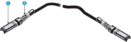

Table 18 SFP+ cables available for the SFP+ ports
Cable description
Cable length
LSWM1STK
0.65 m (2.13 ft)
LSWM2STK
1.2 m (3.94 ft)
LSWM3STK
3 m (9.84 ft)
LSTM1STK
5 m (16.40 ft)
Figure 45 SFP+ cable
(1) Connector
(2) Pull latch
·      As a best practice, use only H3C SFP/SFP+ transceiver modules and SFP+ cables for the SFP+ ports.
·      The H3C SFP/SFP+ transceiver modules and SFP+ cables available for the SFP+ ports are subject to change over time. For the most recent list of SFP/SFP+ transceiver modules and SFP+ cables, contact your H3C Support or marketing staff.
·      For the specifications of H3C SFP/SFP+ transceiver modules and SFP+ cables, see H3C Transceiver Modules User Guide.

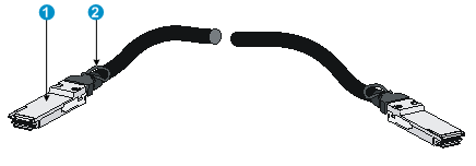

Table 20 QSFP+ cables available for the QSFP+ ports
QSFP+ cable
Max transmission distance
LSWM1QSTK0
1 m (3.28 ft)
LSWM1QSTK1
3 m (9.84 ft)
LSWM1QSTK2
5 m (16.40 ft)
Table 21 QSFP+ to SFP+ cables available for the QSFP+ ports
QSFP+ to SFP+ cable
LSWM1QSTK3
1 m (3.28 ft)
LSWM1QSTK4
3 m (9.84 ft)
LSWM1QSTK5
5 m (16.40 ft)
Figure 46 40G QSFP+ cable
(1) Connector
(2) Pull tab
Figure 47 40G QSFP+ to 4x10G SFP+ cable
(1) QSFP+ module
(2) QSFP+ side pull tab
(3) SFP+ side pull tab
(4) SFP+ module

Appendix D Cooling system
CAUTION
CAUTION:
To guarantee heat dissipation, you must install two fan trays of the same model for the switch.
To dissipate heat timely and ensure system stability, the switch uses high-performance cooling system. Consider the site ventilation design when you plan the installation site for the switch.
The switch uses hot-swappable fan trays. You can provide airflow from the port side to the power module side or from power module side to the port side by using different types of fan trays.
Table 29 Fan trays and their airflow directions
Fan tray
Airflow direction
LSPM1FANSA
From the power module side to the port side and chassis sides.
LSPM1FANSB
From the port side and chassis sides to the power module side.
Figure 48 Airflow through the S5800-56C-EI switch chassis
